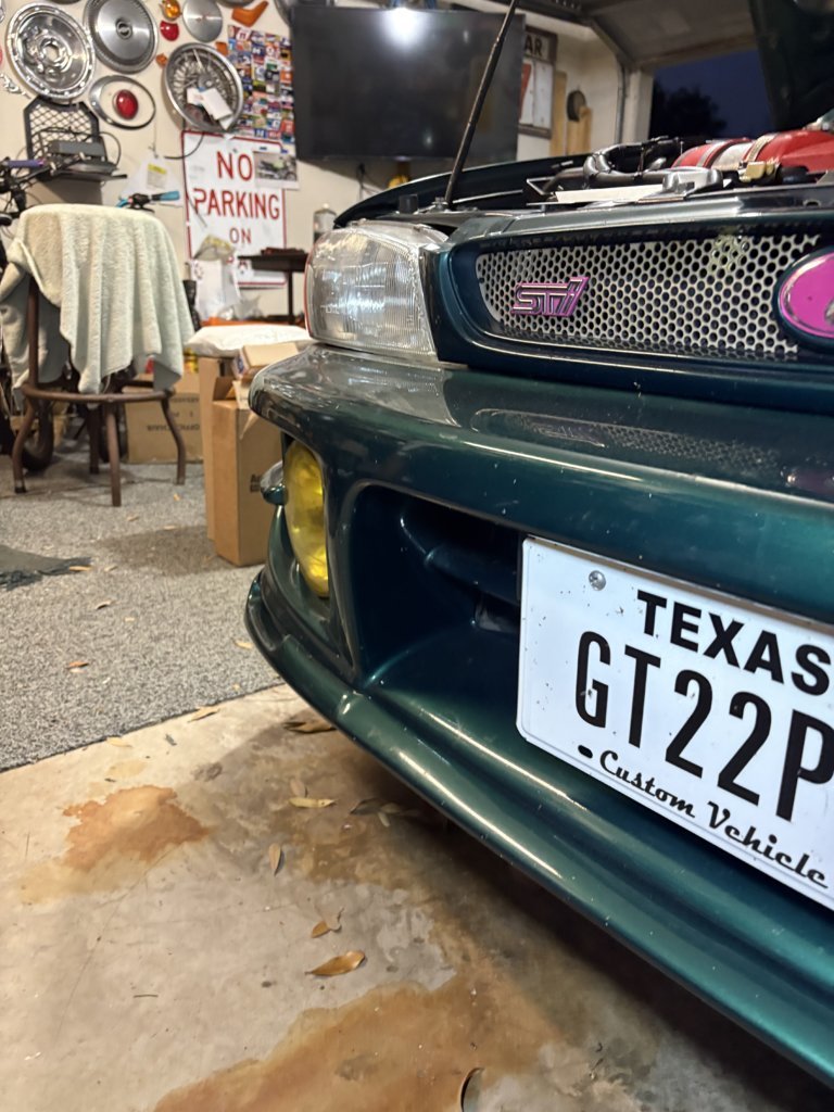

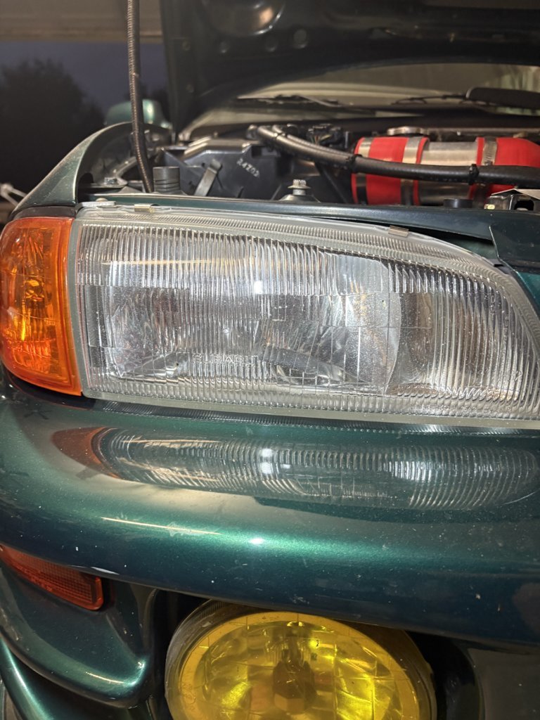

    Here’s my very similar story to yours
    early 2000’s
    No LED’s available at this time
    But
    The “thing” to do was install/retro fit HID’s
    Most difficult thing was getting bulb/ignitor/ballast from wrecked fairly high end car…..not to mention the correct projector/reflector $250 MSRP bulbs
    let’s just say I had access to these NP
    so my car 98 Subaru GC8, was last year for glass lenses AND has those inside ridges to direct the original H4 bulb beams
    Infact, a Bunch of my Subie friends made fun of my old HL’s
    I took a chance
    Installed
    Went to p/l…..turned on HL’s….started 100yrds away and began walking to car
    I thought too good to be true. I did adjusted/aimed lamps down just a lil bit.
    still thought was just me……called my car friend over to inspect beam pattern
    He confirmed, no issue no blinding
    by default, my “old” lenses actually spread out beam so no blinding!
    This was mod was done 22yrs ago….never have been “high-beamed” by on coming driver
    No brights however
    But high beam dash indicator works
    (That’s all that is needed for TX inspection back then……now I’m Exempt bc I got ‘custom vehicle’ status thru the the state

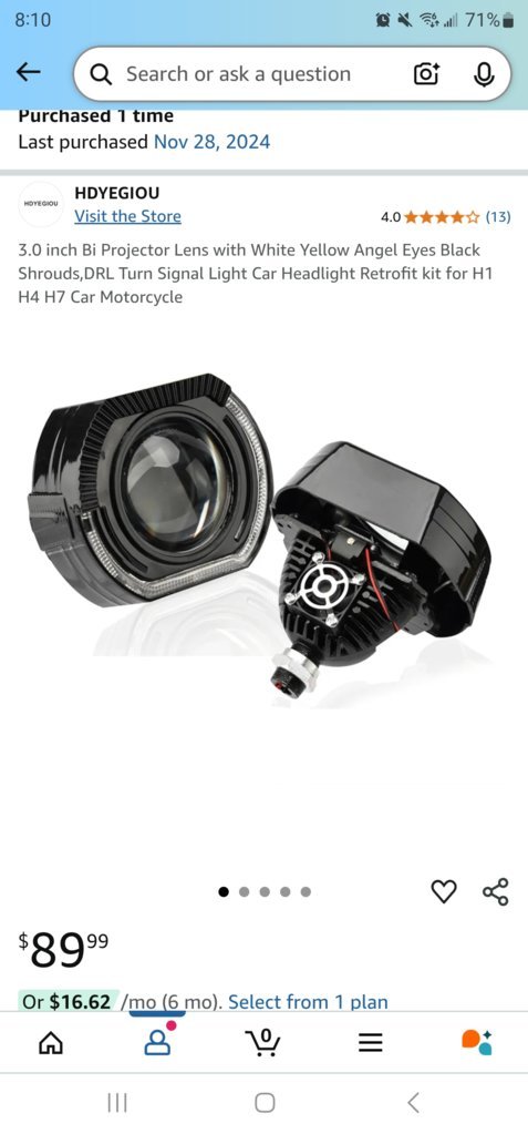

    I went with a projector set from Amazon, I've done a few retrofits and already have the morimoto harness. The lights are very very bright, but have a great cutoff.
    I have been highbeam flashed, but only with my truck fully loaded down. Which changed the aiming of the headlights. Now I re aim them if I have a ton of stuff in the bed (camping trips)
