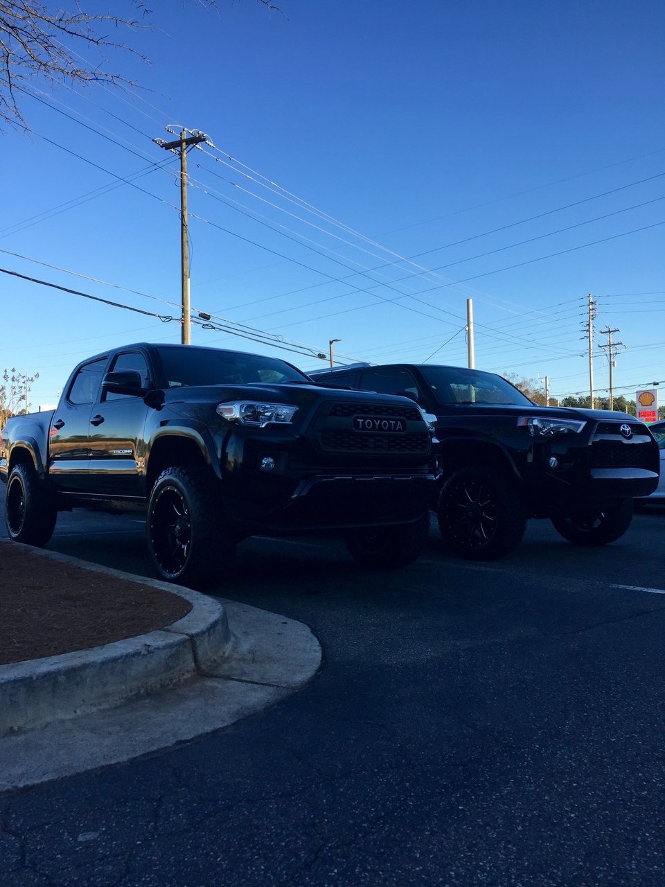

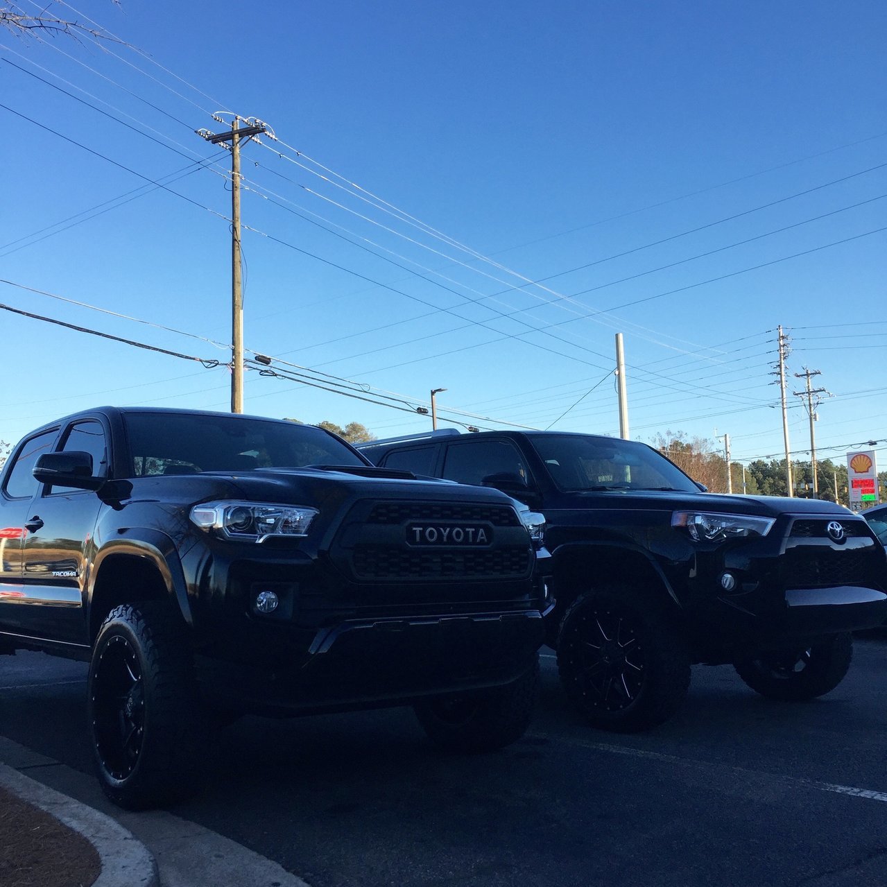

    Hey all, I usually don't post on here but thought I would offer what insight I have. I just bought a 2018 Tacoma TRD Sport 4x4. After doing a lot of research, I didn't want to put a lift or anything that messed with the angles or anything that required cutting into my frame. I eventually ended up doing a Zone Offroad 2.5" leveling kit and the ride is exactly the same (trust me Im picky on this) as stock. I put Fuel Maverick 20x10 -12 with BFG KO2 275/55/20 with absolutely NO Rub. Also I was a little worried about mileage and my truck only has 1000 miles on it but the first day I averaged 18.1 with mostly driving stop and go thru town about 200 miles. I love the truck! Good luck to all. That's my wife's 2018 4runner with the same set up. IMG_3334.jpgIMG_3335.jpg IMG_3335.jpg

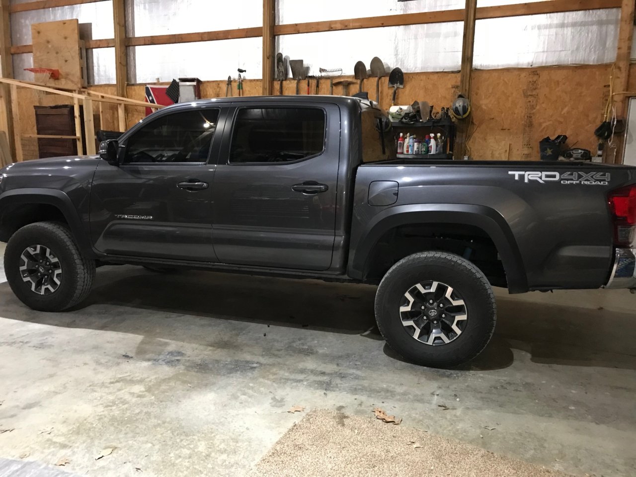

    I bought the Rough Country 1" spacer that sits on TOP of the coil spring assembly. That way it doesn't compress the spring and harshen the ride. It was an easy install and gives you 2" of lift which leveled my 2017 TRD Off Road perfectly. Remember, the amount of lift you get with a spacer will be double the thickness of the spacer because of the way front suspension is designed. Headstrong makes a 1/2" spacers that would give 1" lift. BTW, that Rough Country spacer was only $59.95 with free shipping. See the link...

    Here's my truck with the 2" spacer in the front and a 1" block in the rear. I like a little rake is why I added the block. Without it, it sat almost perfectly level.
