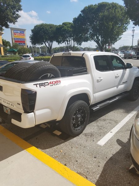

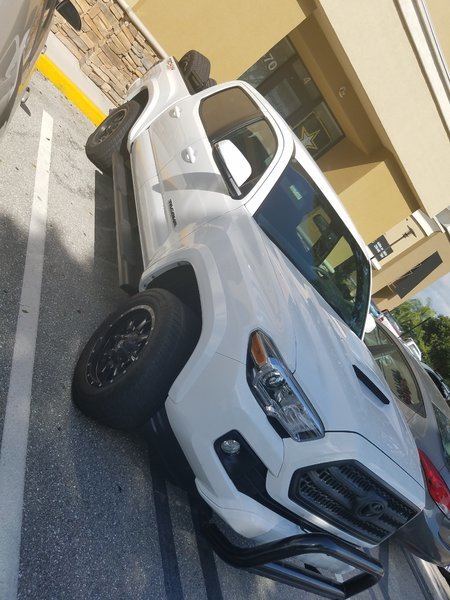

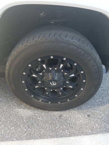

    Thats what it looks like now. It seems like it has a lot of space.
