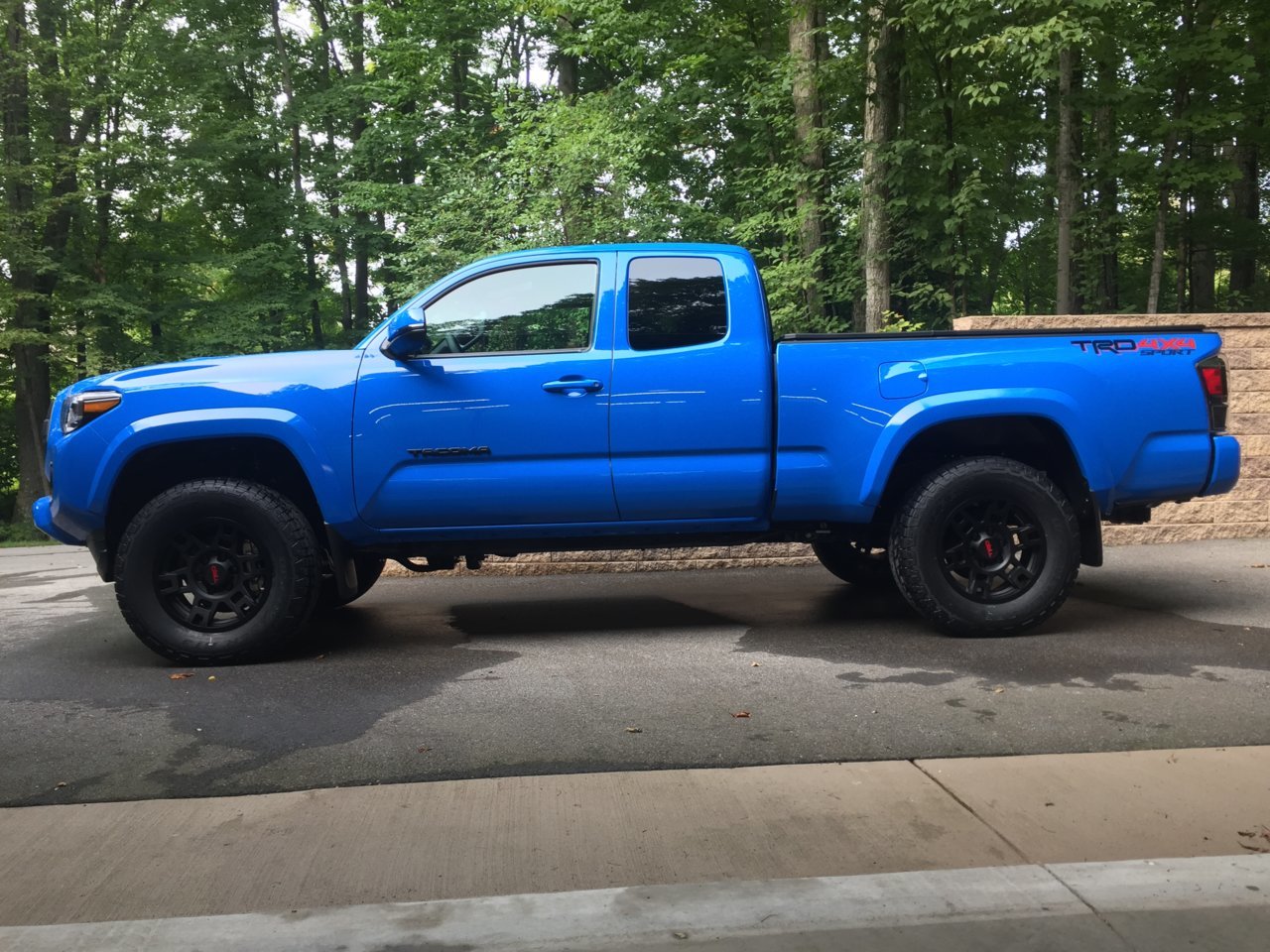

  2. Feb 12, 2022 at 10:02 PM
    #22
    shotgunbilly420
    shotgunbilly420 OG Owner 249+ mi club/Tacoma enthusiast
    Jul 10, 2018
    #258947
    3,320
    Montesano, Washington elv. 66ft
    2017 trd Tacoma offraod AT Inferno
    315/75/16, 6in modded RC lift,Anderson Engineering manifold spacer,K&N air intake, URD YPipe, stock exhaust ,16" method nv305 wheels, AFE throttle body spacer, vf Tune program, JTL 3.0 Oil catch can x2, rear cat delete
    These tires were 275/75/16 Cooper stt pros
    Underdonk[QUOTED] likes this.

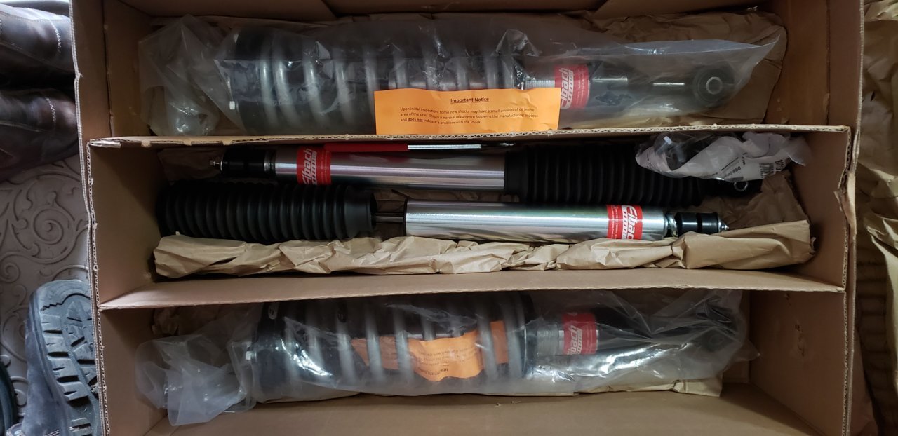

    I am not doing a level, I am lifting... Eibach Pro Truck 2.0 kit with 1" rear blocks. I have the kit. It will go in on March 8th. I preferred that the front was an adjustable coilover style and can be adjusted on the truck. No clip system to have to disassemble if I needed to make an adjustment. I also liked that it comes pre-assembled and is a true bolt in.

    This sounds like a good option. How much was this kit? Is it hard to install without a hoist?

    It was just under $1000 US for it, after exchange ect, ect... it was 3 bushels of oats, my left testicle, 2 sheep, my first and third born and a bunch of Canadian Tire money. Installation will be a couple jack stands and a jack. Should be be pretty straight forward.

    Could you link this kit? This sounds like what I want to put on my 2017 SR AC 2WD

    https://eibach.com/us/1920/E86-82-007-01-22-TOYOTA-Tacoma-pro-truck-coilover-stage-2
    I bought it on sale. Also, it said it was out of stock when I bought. I called and they said it would be a month but I received it 3 weeks later.
    I have been waiting patiently for the weather to warm up a bit to get these installed. March 8th can't come soon enough.

    Does this kit come with blocks for the rear? Or just shocks and front coilovers?

    Just the front lift and rear shocks. I also purchased the blocks. Sorry, didn't mention that in the post.
