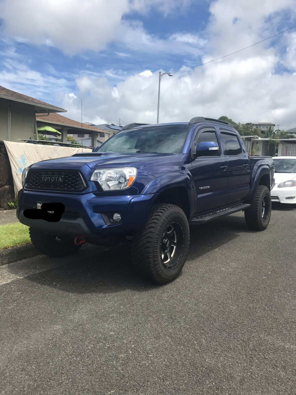

    Oooo thing looks good. Is that picture with the truck on jack stands?

    This is a picture on the ground.

    Rajjah. How much lift did you get?

    I got around 3.5” total like I had before. I got 2.5” from the spring and 1” from a small top spacer.

    Got pics of truck? I just ordered my lift as well for 3 inches.i wanna see what it may look like ty.

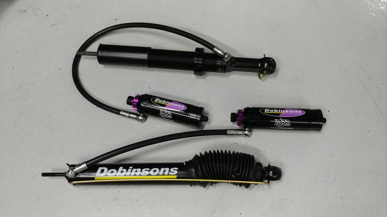

    I have them now and love it, but I am crazy and just got their MRR 3 way adjustables(extended length front so I can play with height fine tuning) with C59-302 springs(practically a OME 2885 specs wise )and a 2" rear block since I got brand new OEM leaf springs from the recall. They should hold the weight of a 105lb bummper and net me 3" of lift min with a quality ride. Will eventually figure out what leafs to get, more than likely Dobinsons anyways since they are located 20mins from my shop and literally have the best customer service I've ever seen"
