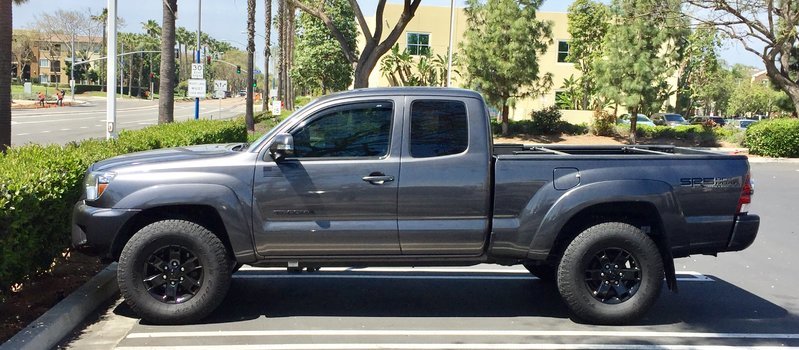

    Any rubbing at all? Planning on doing that size tire for my access cab

    No rubbing whatsoever.

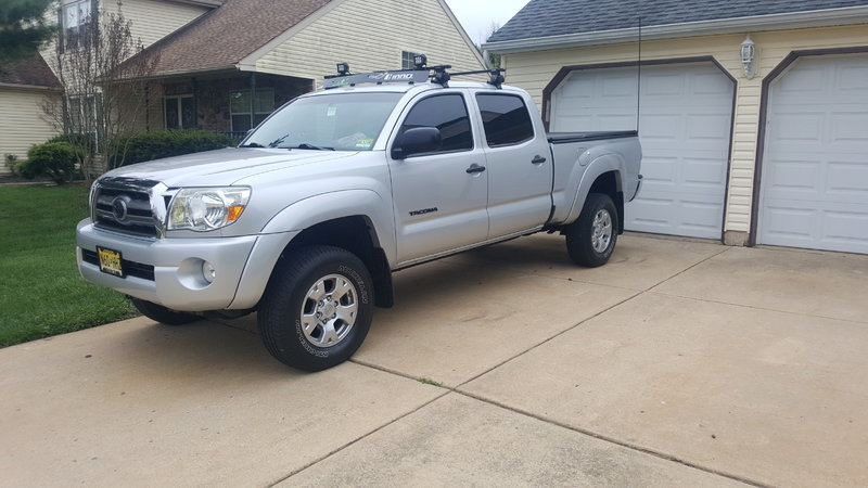

    5100s/Headstrong Coils/Deaver AAL/Level8 MK6/FalkenWildpeakAT3
    Just installed my 5100s along with HS coils and deaver AAL last week. Love the ride and looks. Cost just over $600 shipped. Couldn't have ask for a better deal. Hit up @HeadStrong Off-Road for it
