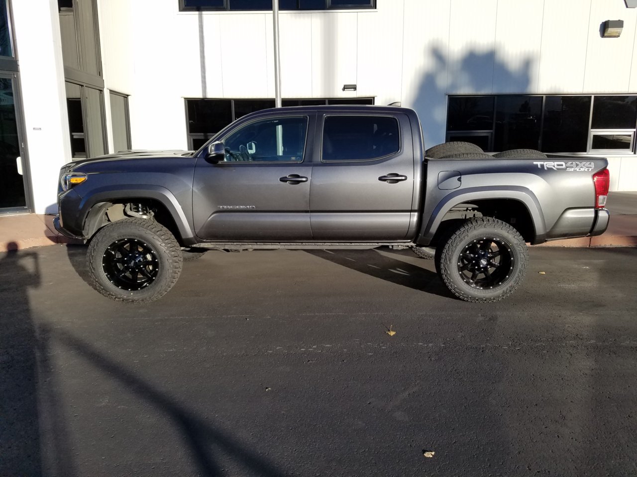

    Went with the 3" Rough Country coilover kit with uca's. Couldn't beat the price and those guys are awesome and gave me a free carrier bearing drop kit...

    SSTT0816 You're right, had to do the ecgs bushing. Was growling/pulsating like mad. That fixed it. Everything else perfect. Rides great. Tires are quiet. Looks awesome. Really happy. Rough country 3" coilover kit with added uca's. Moto Metal 970's with Falken Wildpeak 275/65R18. No rubbing, no cutting...20211110_154657.jpg
