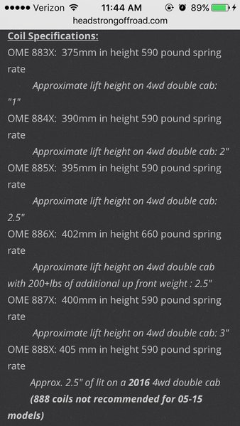

    image.jpg I'm trying to bee in the range of 2.5-3" so 885 or 887 will be the best bang.its just a matter of hoping to avoid UCA

    I already have front 5100 on stock coils. I'd like to be 2.5-3"(closer to 3 preferable). I'd prefer to stay less than $600 considering the front shocks are already in place. My hope is to avoid spending the extra $600 on UCA unless necessary. I've seen many people on here stating that it's entirely doable. I should be able to do the install myself relatively easy as its a pretty straight forward install. I'm planning to do a progressive 3 leaf in rear and keeping factory overload but I haven't decided exactly which rear shocks to go with (5100 or 5125). I'm leaning toward 265/75 Open Country R/T or a 285 KO2. I don't extend to change wheels from the OEM steelies so I understand I will have to do Hub centric spacers. I have the basic tools for a CMC and a small welder so that shouldn't be a big deal. It's just a thought but I may later do a small body lift like the 1" Toytech kit but I haven't committed my mind to that. The only off roading I do is hunting. Otherwise it gets driven 1-2 times per week to the store or something because I have a company vehicle.
