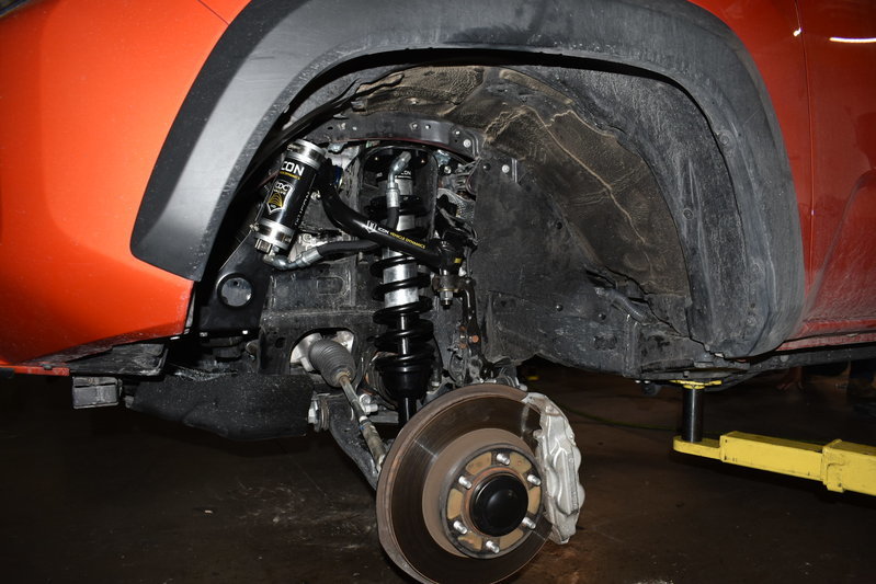

    Leobomber1
    Leobomber1 Active Member
    Sep 24, 2015
    #165092
    39
    Justin
    Las Vegas, NV
    2016 Inferno TRD Off Road
    Icon Vehicle Dynamics Stage 6 KC HiLiTES Pro6 Roof Lighting KC HiLiTES Gravity G34 Ditch Lights CBI Ditch Mounts Prinsu Roof Rack ARB Awning Hi-Lift Jack SOS Concepts Bed Rack Fuel/Water/Emergency Rotopax Konig Countersteer Offroad 265/75R16 BFG KM2 UltraGauge Blue
    Took me a long time to decide on a lift. Originally went with OME on my '13, but when I traded in for the '16 I went with an Icon Stage 6. I've really enjoyed it so far. It's a little more stiff on the road but I like how it feels planted through corners, even after the sway bar delete. Being in Vegas, most of our trailing is higher speed so the Icon valving helps. Also, the CDC valving allows me to change up the stiffness. Usually running more stiff on the highway (7-8), lowest for slow crawling (S-1), and low-mid (2-4) for high speed trails.
    Like many have said you'll feel the little bumps and from 10-20mph things are a little rough. Once you get some speed going and hit a big washout or rock you'll be amazed at how smooth you'll run through it.DSC_0177.jpg
    Citizen Rob and SilverII like this.
