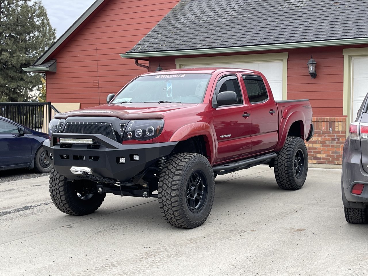

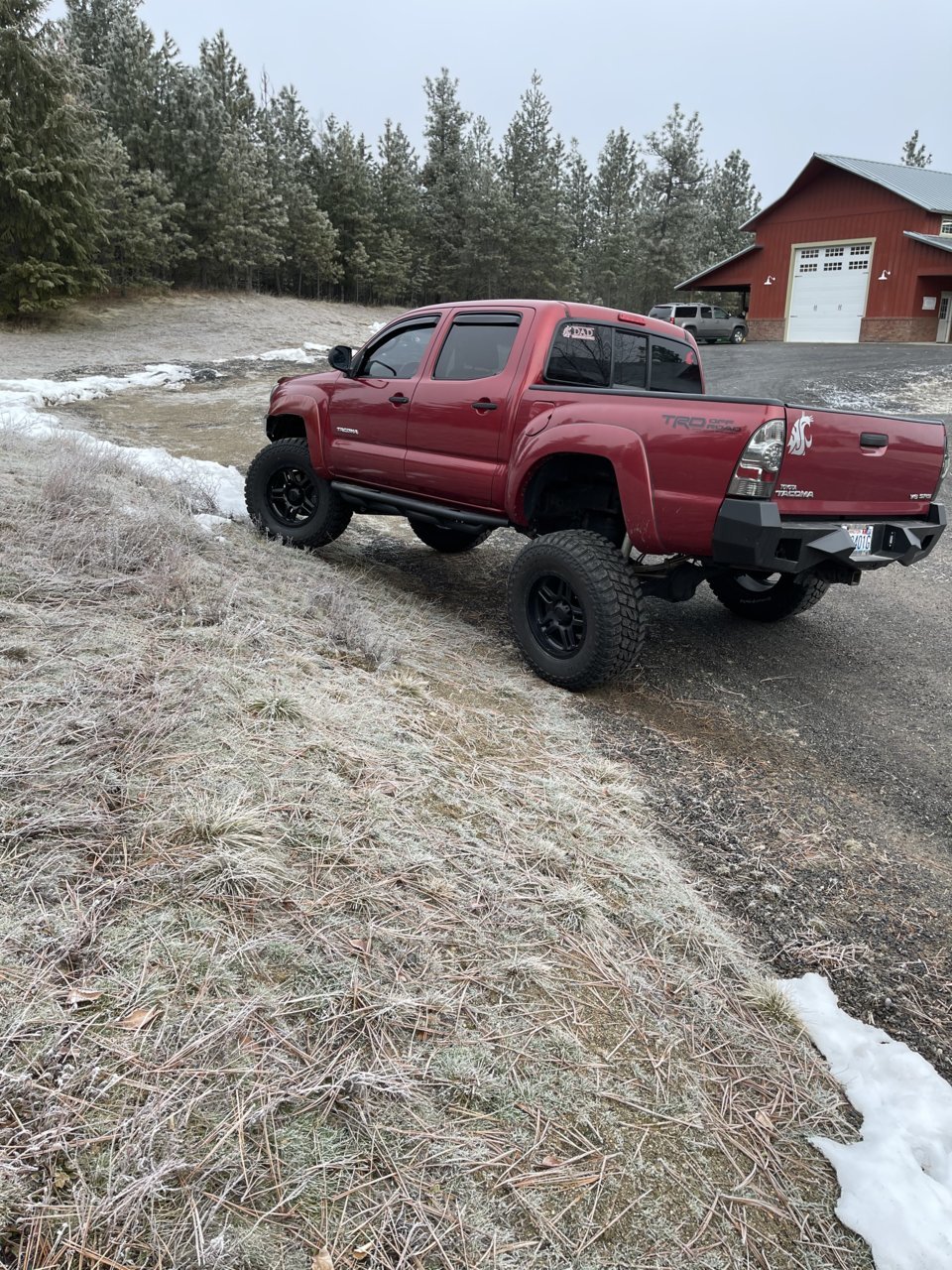

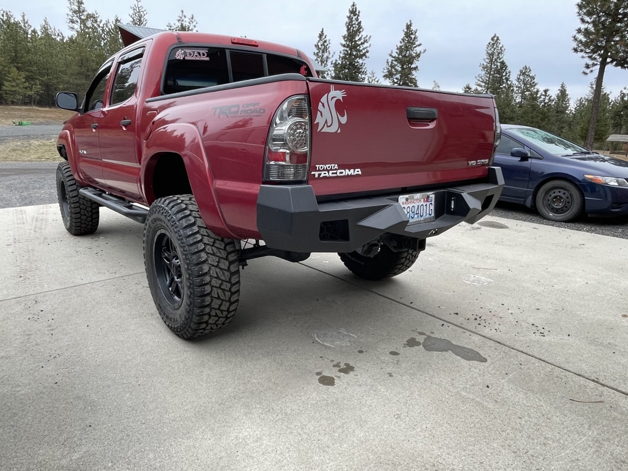

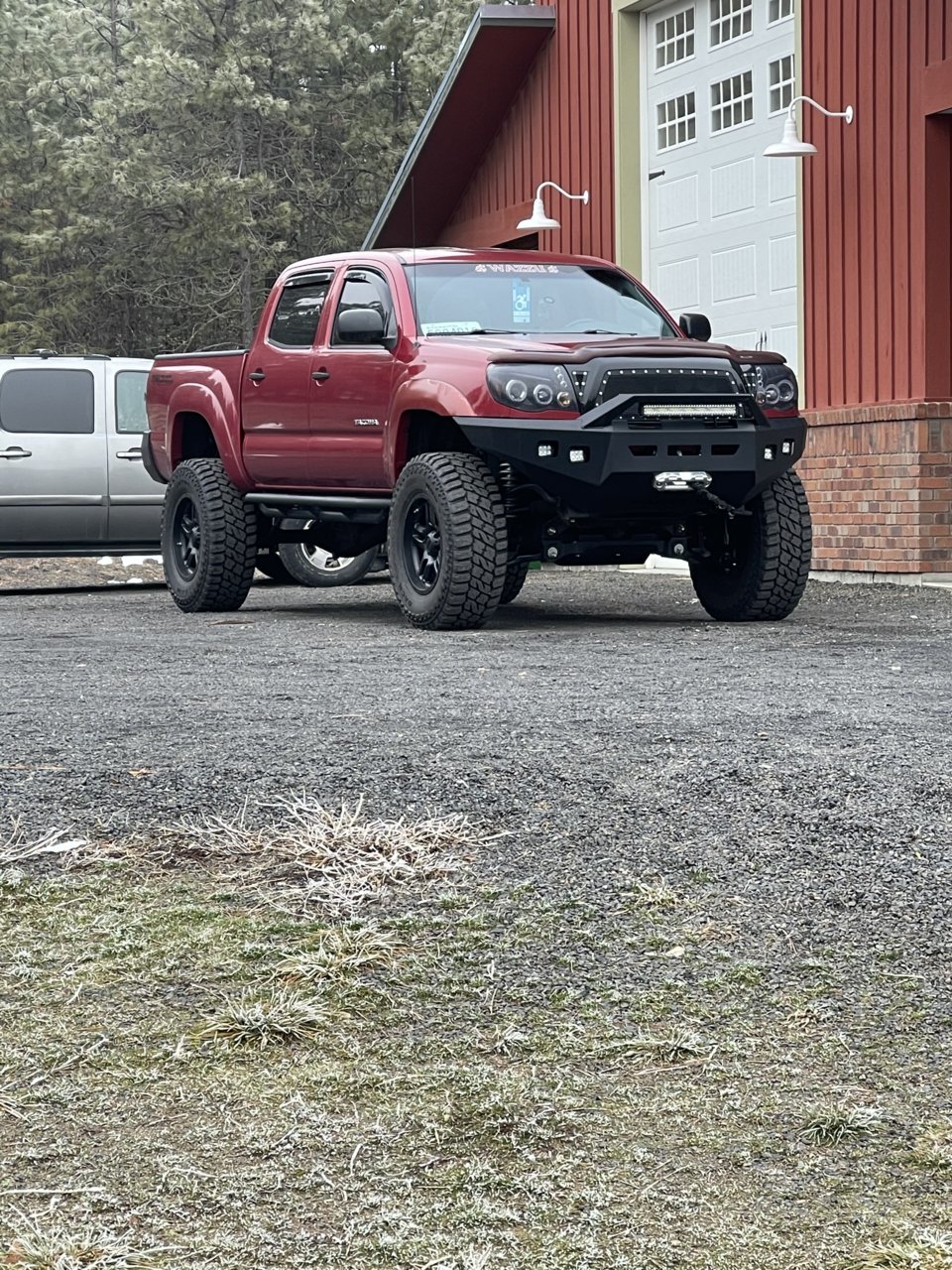

    I personally love my 6” BDS with fox 2.5 coil overs with remote reservoirs. Allot of people poopoo the drop brackets but I have never had an issue and I go to the mountains (dry, mud, and snow) almost every weekend. Of course you get what you pay for and you can’t beat their warrantee. I’m running 35’s and all I did was a front body chop. I don’t rub at all up front (I do rub just a smidge in rear at full articulation) I did change out the fox 600 lb/in with iebach 650lb/in due to winch and pumper. And got the BDS UCA that is made for their 6”lift. And My front still needs to be adjusted up more aswell but waiting until my dirt king LCA come in so I only need to take them off once. The reservoir hose gets In the way on the passenger side so can’t adjust preload while on truck.☹️

    Also keep in mind if you have an automatic you might need to regear aswell. I am lucky and have a manual so my truck actually drives better with the taller tires. I can cruse down hiway at 90 and still be at lower rpms. If I need a lower gear for climbing I just use low range. I have no issue with shakes or vibrations. These pics have my snow tires on. My summer tires are Fierce MT’s and they don’t cause problems either .
