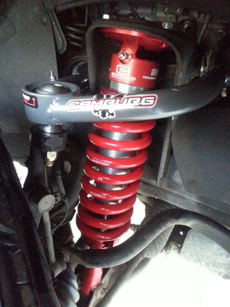

    I like this one !

    Awfully expensive game of dressup. Just IMO and no offense intended. But my point still stands that to prevent turning the truck into a POS there are only two very expensive options.
