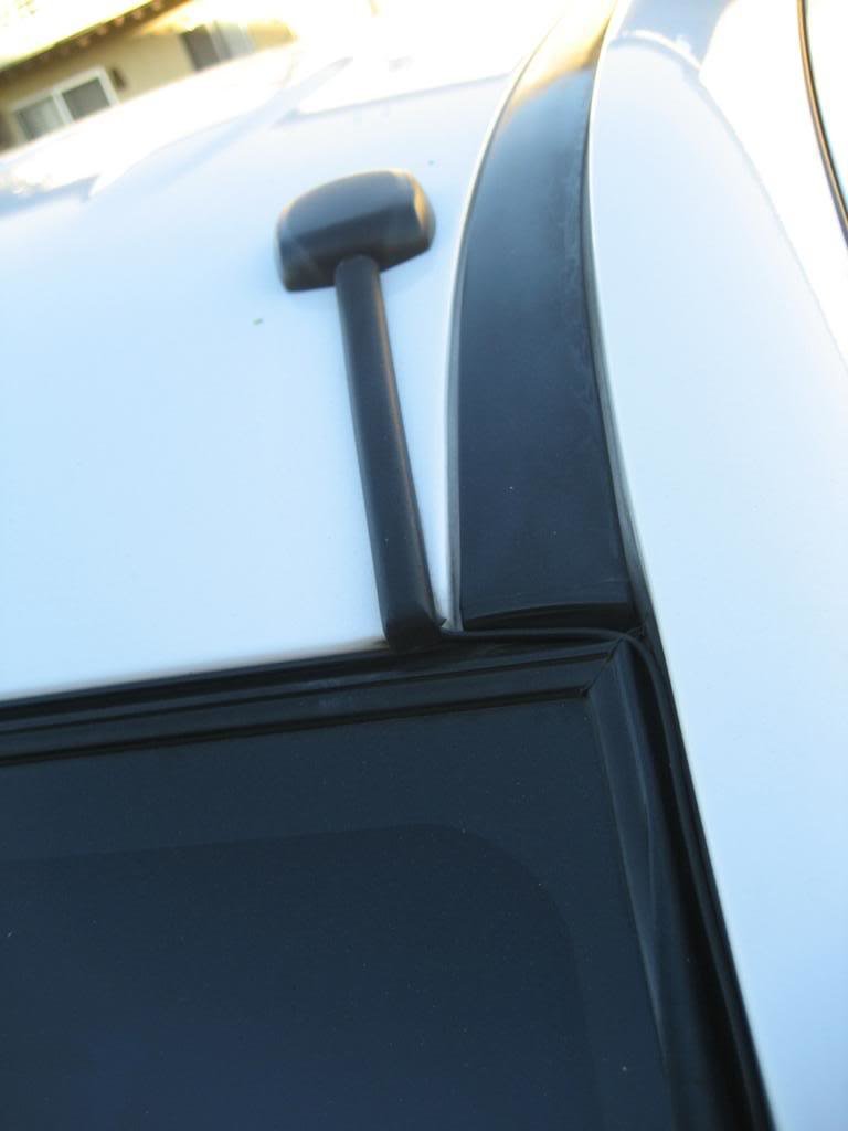

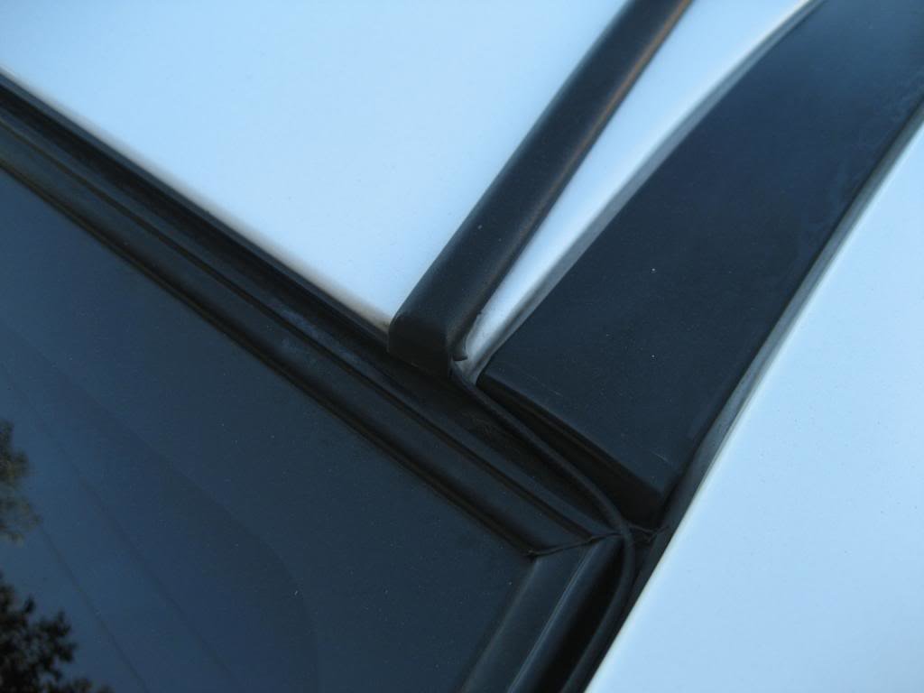

    I ran mine through the firewall and up the driverside window and put it between the weather stripping. No pics, but easiest method without removing break light or anything else.

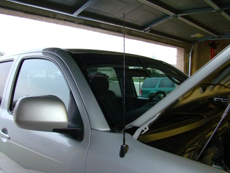

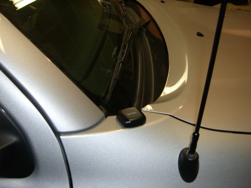

    I put my Sirius Antenna next to the am/fm antenna. Ran the wire thru an existing hole on the right side of the firewall and behind the glovebox. Reception is fine, never lose signal.

    This is my first choice, can one move the weatherstripping enough and have it lay back down?? I read comments on here about a noise coming from the weatherstrip...mine is good, don't want to start something..lol!:)

    I tried this method first but couldn't get the wire behind the weather stripping.

    Hey Ilovetacos...I noticed you have braces on your hood...great idea...are they anything special just 'run of the mill" braces?? The antenna location is great as well

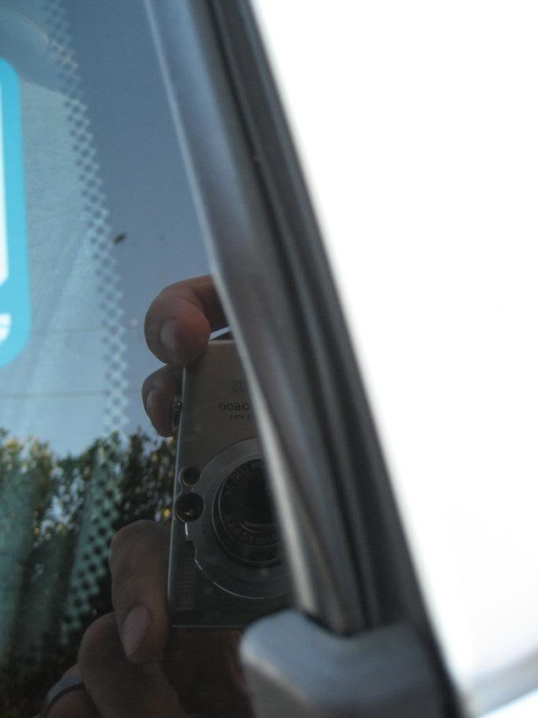

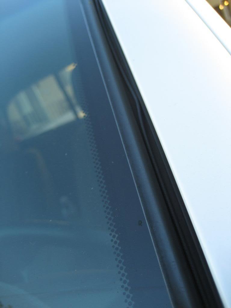

    I didn't put it under. It is between the little channel and the naked eye can't see it. LOL!
    No need. I will take pics tomorrow!

    My Sat radio and my Nav antennas are mounted on the interior corners of my dash... safe, secure, clear line of site.

    Here they are....
