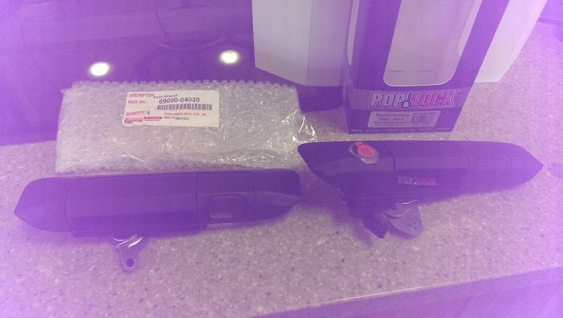

    Any finally...
    I looked into OEM tailgate handles w/ a pop-out for cameras. Toyota P/N 69090-04020 says it's for '08-'16 Tacomas...
    P/N 69090-04010 is for '05-'09... There is overlap in the years (which indicates to me that the handle will fit '05-'16) so I asked Toyota parts if the 04020 would fit our '07... They weren't sure, but had one in stock.
    I went down and took a look at it and compared it to the Pop and Lock (manual Bolt key version) they had in stock. The handles look similar in terms of bolt placement and I took pictures of both side by side (just went to add the pic and realized I didn't take a picture of the back of the handles showing bolt placement! Thought I had done that.)... Well, anyway, bolt hole placements looks the same...
    Young lady at Parts said they are a sponsor of TacomaWorld and if one goes to partsfactory.camelbacktoyota.com they can get the part for about 25% off. So, regularly $100.79 marked down to $73.93 for OEM handle w/ camera pop-out (without actuator).
    Here's the link:
    http://partsfactory.camelbacktoyota.com/oe-toyota/6909004020

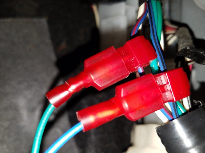

    OK here is what I found.....
    re: 2006 Tacoma TRD Sport Access Cab.
    The picture below shows the little bundle of wires behind my passenger side kick panel.
    I spliced and connected in the cab as follows.
    Blue / Red (truck harness) to Green (Pop n' Lock)
    Blue / Black (truck harness) to Blue (Pop n' Lock)
    This opens the tailgate mechanism with two clicks of the unlock button on the fob along with the passenger door and locks the tailgate and both doors with one click of the lock button.
    Pop n' Lock does not actuate when the drivers door opens with one press of the unlock button.20161029_113102.jpg

    Re-read the post above (or below), try running some jumper wires to the PASSENGER side. I think you'll have success.
    Pop n' Lock does not actuate when the drivers door opens with one press of the unlock button.[​IMG]
