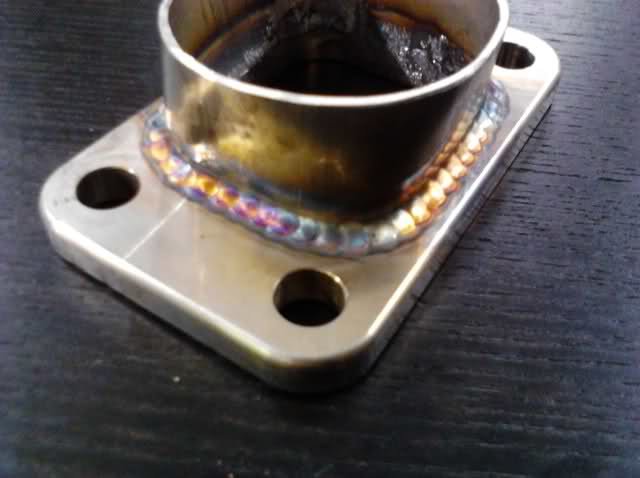

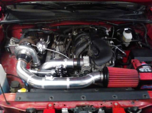

    First mock-up.
    Finalized -

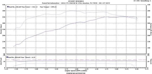

    And the graph...

    Nice. If I'm seeing this right, is the maf sensor on the 3rd piece of tubing from the air filter? It seems a bit close to the filter, is it giving any problems with tuning or drivabilty?
    I'm not knocking his set up, don't get me wrong, I probably would have relocated the battery and placed the filter enclosed in the location the battery is at now. Then again if he's not having any issues with the maf reading smooth airflow, job well done. Nice welds and looks clean. Good job on choosing a turbo that isn't too large.

    I will let Sik X comment on the specifics of his particular intake design.
    I can say however that he wanted to do something different than mine, and Toon's. Our are now both "blow through" MAFs. Being that our MAF from the factory setup, is a "pull through", he wanted to keep that as such.
    For one reason, being that there won't be any pressure on the MAF like his is. Decreases the chances of a problem due to the pressure.

    Thanks for the complements. I didn't want to relocate anything cause that will make it more difficult for the average person to install. (if they wanted to install it themselves). These kit will be available after we get the tuning completely figured out, (map ecu 3 doesn't work very well on tacomas, im trying aem next). So far we know Pro EFI works, (ask Torspd) but we are an AEM dealer so i want to try that. These kit are avialable for in house installs only for right now.
    The maf sensor works so well in that location i drove it for 2 weeks without a tune(staying in vacuum of course) and the truck ran perfectly with no check engine light. As long as there is about 6 inches of strait pipe in front of the sensor youll be ok. This kit requires no cutting of anything, direct bolt on, you will just need to bend a few ac lines and moves some wires around.

    See build thread in signature
    Defiantly looks bomb. Any chances of getting a higher res shot of that dyno chart?
