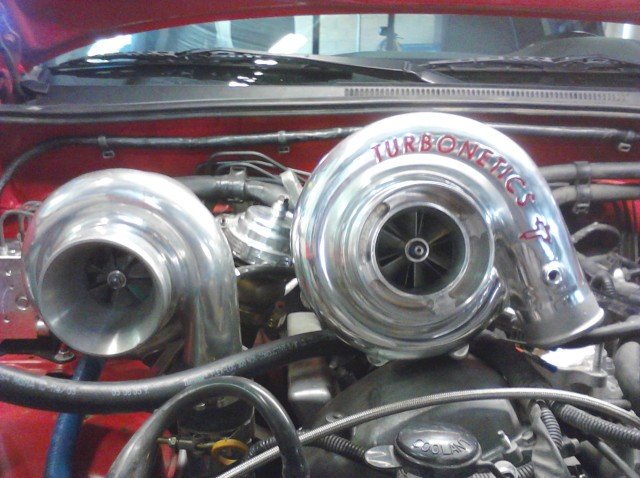

    My friend SIK X at it again.
    Quote, "Im going a little larger on the turbo this time. Precision 6766 t4 .81 a/r. 1.75" headers, 2.5" merge pipes, 3" feed/Up pipe (to turbo), 3.5" exhaust. This kit is for an XRU member and he will push this kit to 700hp and i cant wait to see how it does. But in the mean time im gonna see how this kit does with stock motor on 10psi. Everything is a little over kill for a stock engine but im building it this way to be capable of 700-800 as well."
    "Quik recap....
    Version 1, perfect quarter mile setup. not capable of 700hp
    Intercooler is also only good for 450hp, so it will be changed.
    Version 2, same kit just larger turbo, and charge pipe change-up. turbo capable of 700hp but im iffy on the kit.
    Version 3, ALL NEW EVERYTHING. Easily it will make 700, but how will it perform with 400hp? We shall find out," quoted from Sik X.

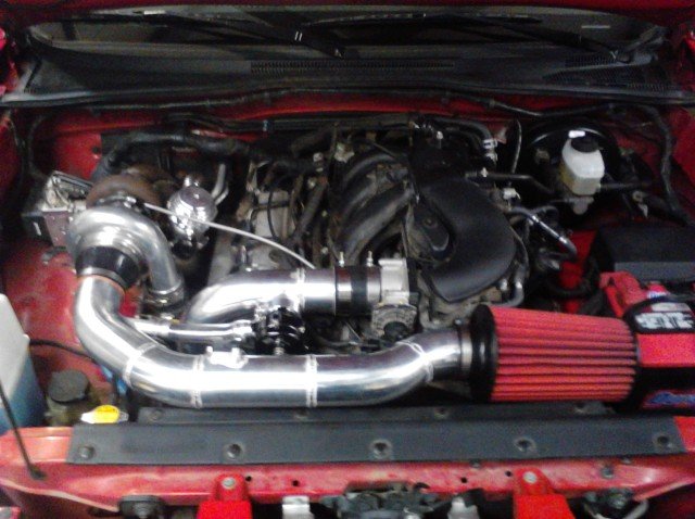

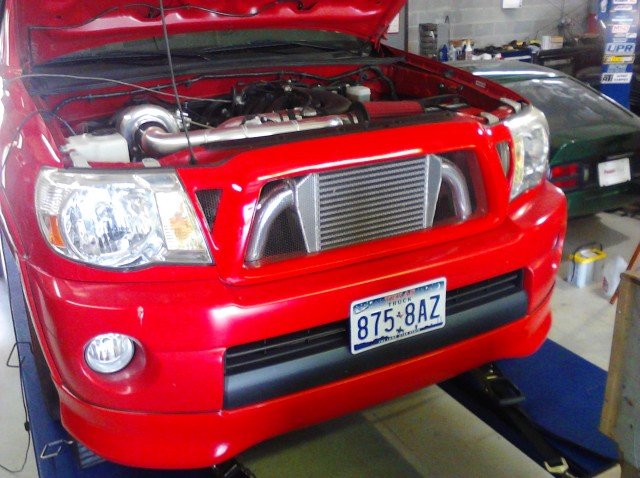

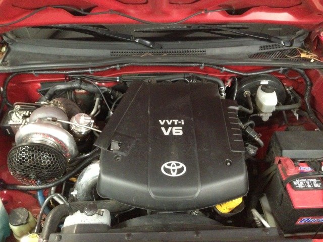

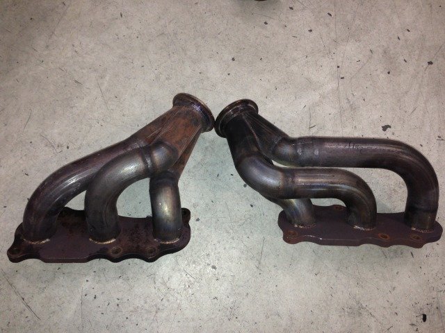

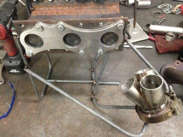

    So heres Version 2.(my turbo kit) Version 3 will be pretty much the same as you see this just larger turbo feed pipes. Unfortunately I didnt receive the rest of my metal that i was expecting yesterday. so it my be another week or 2 before i finish this project. But on a good note, this is the first time ive taken the whole kit off since i installed it and im happy to say that after almost a year of being on the truck and 20k miles later there are NO cracks, or any signs of fatigue. and 10k of the miles are beating the F out of the truck. mostly late night street racing.lol

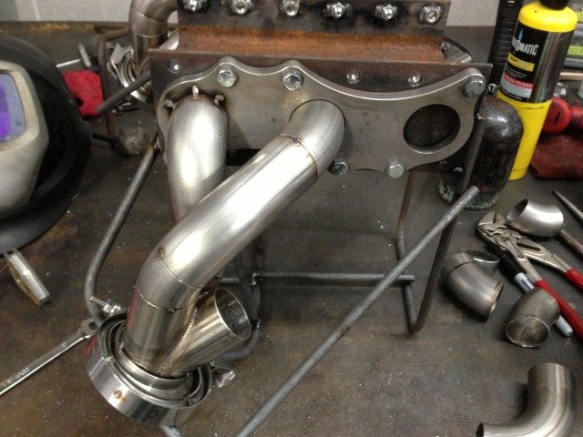

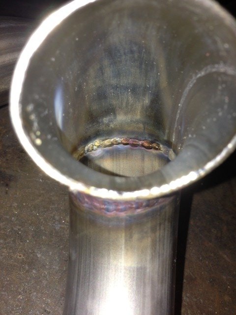

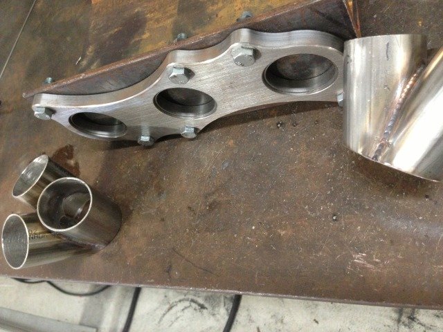

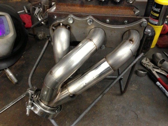

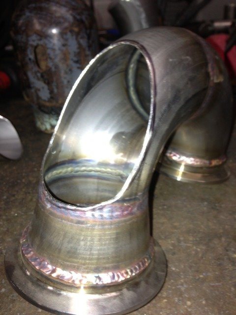

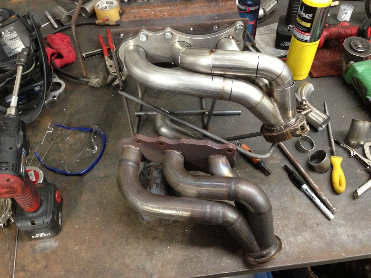

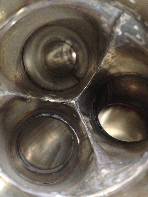

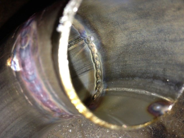

    This is taking me a little longer to build cause im fixturing as i go.
    I know im not the best fab/welder out there, but I use correct techniques that alot of shops dont use. Any pipes feeding air into the engine or turbo should be welded inside and out (known as purge welding). If your header or any pipes between engine and turbo (hot side) have cracked its most likely cause it was not Purge welded. When you dont purge weld it leaves nasty very pitted bumps inside, and when you put heat into that itll start cracking from the inside out. Heres what a correctly welded header pipe should look like.
    There certainly will be. :thumbsup: I heard the finshed product on Monday. Made my ears drool. Lol

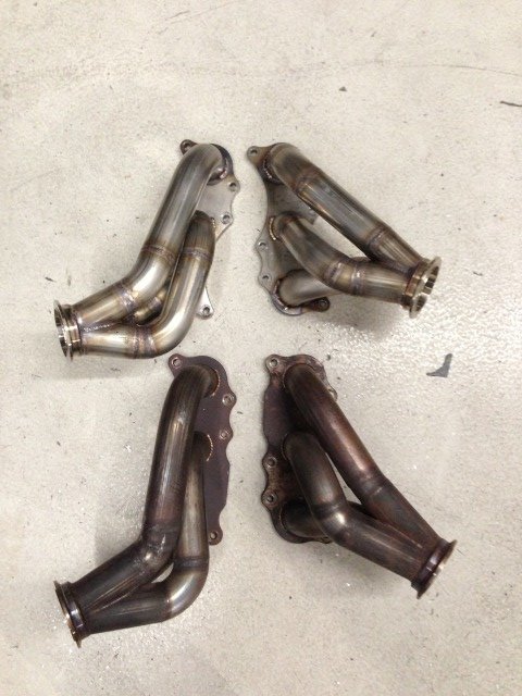

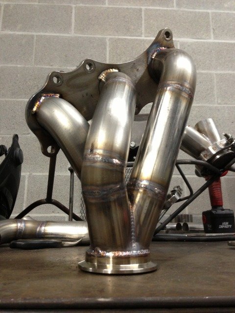

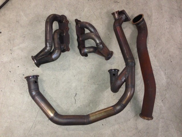

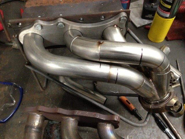

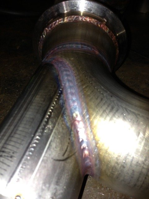

    Quote,"This set of headers looks way better than my 1st set. [​IMG]
    My header looked just like this one before i installed it. this stainless is not treated in anyway (caotings or polished) so over time it will change colors. Some stainless pipes that are polished (such as Toons) it will not change color nearly as bad. Though some polished pipes will start to look blue or gold (depending on the amount of heat. This particular kit will be coated.

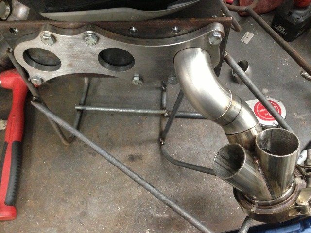

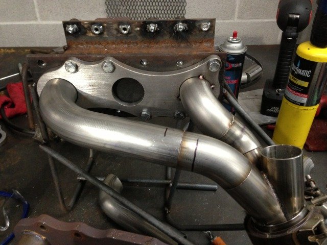

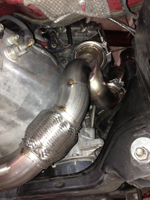

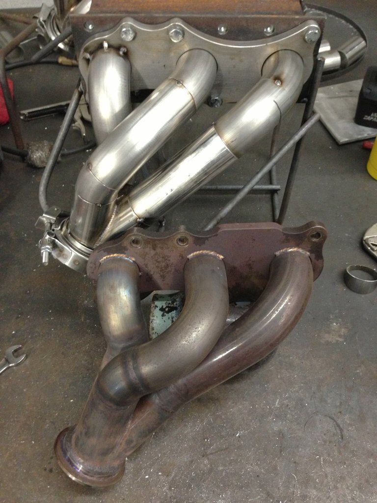

    passenger header
    ^^^^ That is sexy!

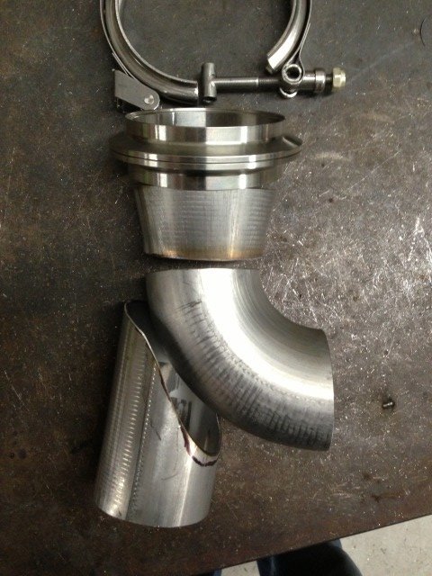

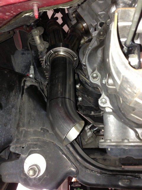

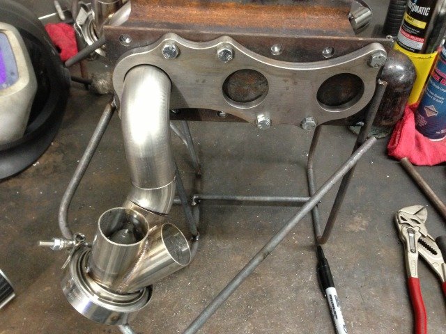

    Starting on crossover pipe....

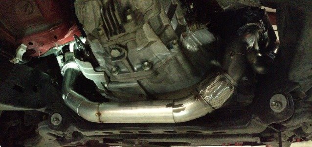

    pano shot..
