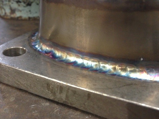

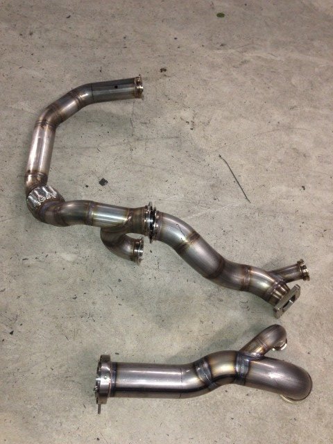

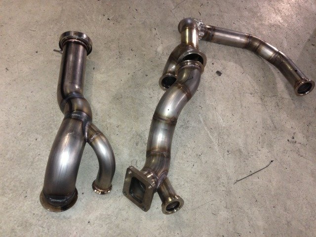

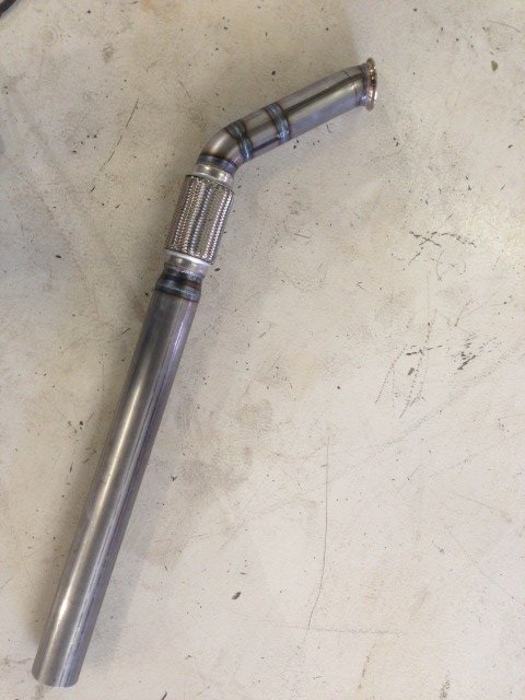

    More updates of his.

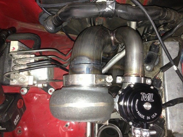

    welds on T4 flange

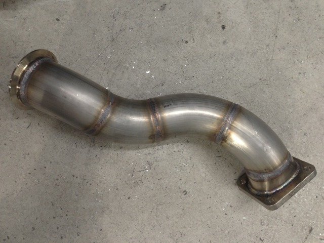

    completed up pipe, still needs waste gate tho
    up pipe, turbo, down pipe

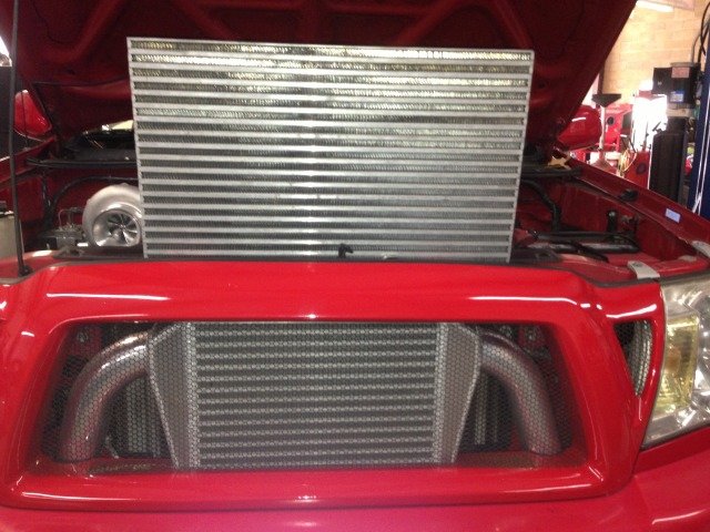

    my 450hp intercooler, and the new 950hp intercooler

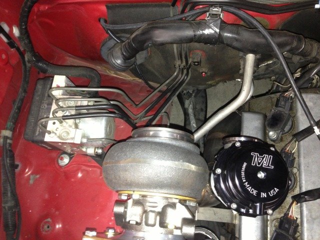

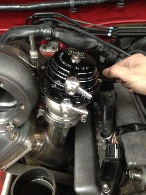

    waste gate installed

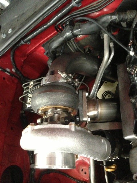

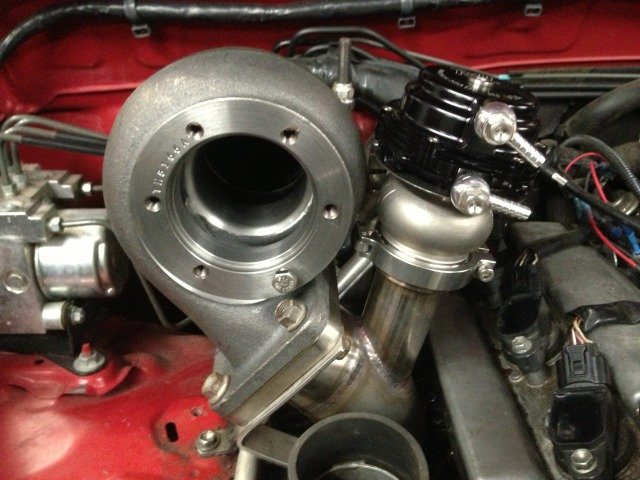

    Torspd Custom Turbo kit [] Borg Warner 9180EFR Turbo [] Haltech Elite 2500 [] TiAL Q BOV [] TiAL V44 Wastegate @ 15psi [] CP Pistons [] CP Carrillo Rods [] ARP Head studs [] ARP Main Studs [] ARP Header - Head Studs [] Ported Heads w/ 1mm oversized valves intake/exhaust [] Brian Crower Forged Stroker Crank [] Darton M.I.D. Sleeved Block [] Kelford Camshafts [] Torspd 160* T-stat mod [] APR Large Fuel Rail [] Walbro 460 LPH E85 Fuel Pump [] FueLab FPR [] APR T56 Conversion Kit [] KP RACING Built T56 [] McLeod Racing Custom Twin Disk Clutch [] One Piece Aluminum Driveshaft [] MGW Shifter [] Custom lowering kit [] Ohlins Front Coilovers [] QA1rear shocks [] Custom Ron Davis Radiator [] Dual SPAL Electric Fans []
    This is the best possible way to place Waste gates for best boost control. As close to the turbo as possible and In flow with the pipe.
    and right back into the downpipe... I personally dont like the sound of open wg's.
    And ALL spark plugs are still serviceable with-out removing any turbo parts.

    Dude, that is some serious trick fitting job, do you know how long it took to fab up those pipes?

    He made jigs so that he can make kits. :D
    He was actually making posts a few times a day, during the build process. He works with a experienced quickness. I would have to look back, but I think a week to two, once all of the parts were in.

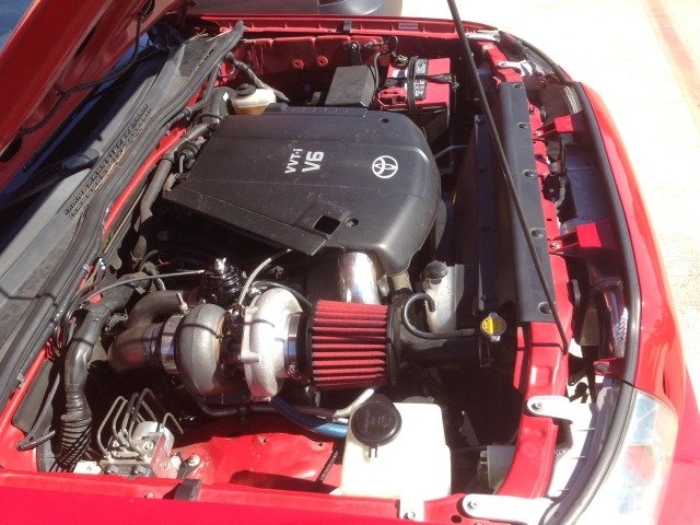

    Originally on 1-16-13

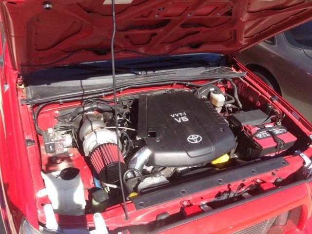

    So i put the filter on.. exhaust will go on this weekend.

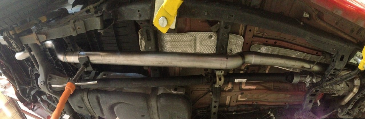

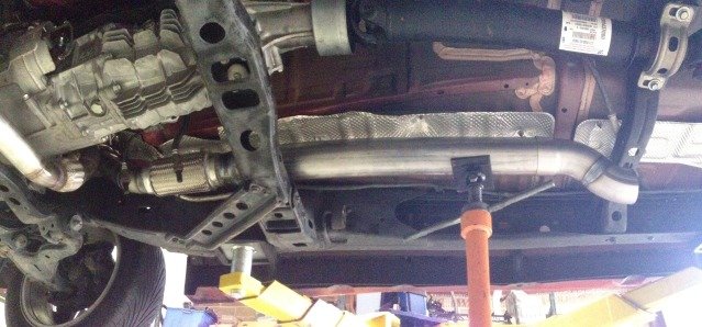

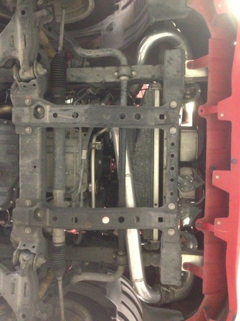

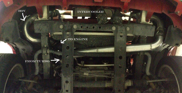

    Heres the charge pipe, hope this explains it well. This is with My intercooler, Cliffs Intercooler will be larger and sit in the same place with same charge pipe routing. and BOV location.
    The exhaust exspands to 3.5 just after flex pipe.
    Almost done.... (besides intercooler) Dyno results at 5psi comming Very soon.

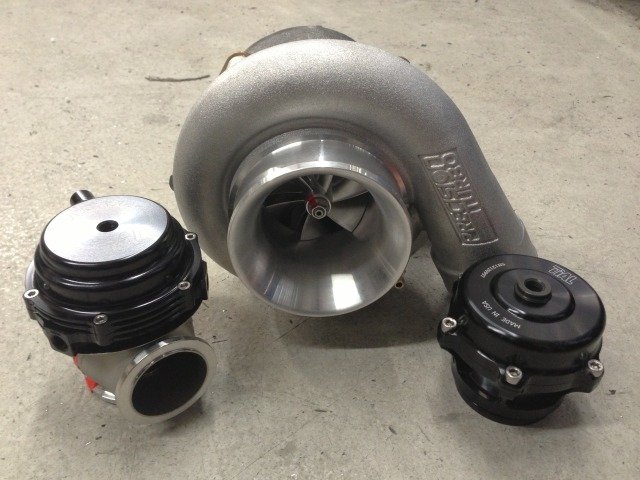

    This is from Jeremy in his post on XRU - www.PowerFabauto.com

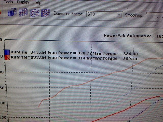

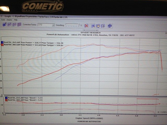

    From Sik X on 1-26-13
    NOW... SOME RESULTS!!!
    Red line is Cliffs turbo kit that i just built..
    Blue line is my turbo kit with turbonetics turbo..
    This kit falls off at the end (compared to my kit) cause it was designed to make 700+hp. It needs more boost to really show potential of this kit.. I will make another dyno pull at 10psi when my aem shows up. Then i will put my kit back on and compare it at 10psi. Otherwise this kit is making way better down low power at low boost. the real test is at higher boost levels. So far... i like the results. And notice how i show Torque numbers and Boost.. I hide nothing :top:
    And heres what it sounds like.... I will have more clips of it at the dragstrip soon. I honestly dont like the way it sounds (it needs a muffler) (not a race muffler). When Tor came by the shop to hear it, it sounded good, i didnt rev it higher than 3k and it sounds awesome under 3k. But over that it gets a bad honda sound. Already ordered a muffler, so it will be fixed soon. hopefuly sound better.
