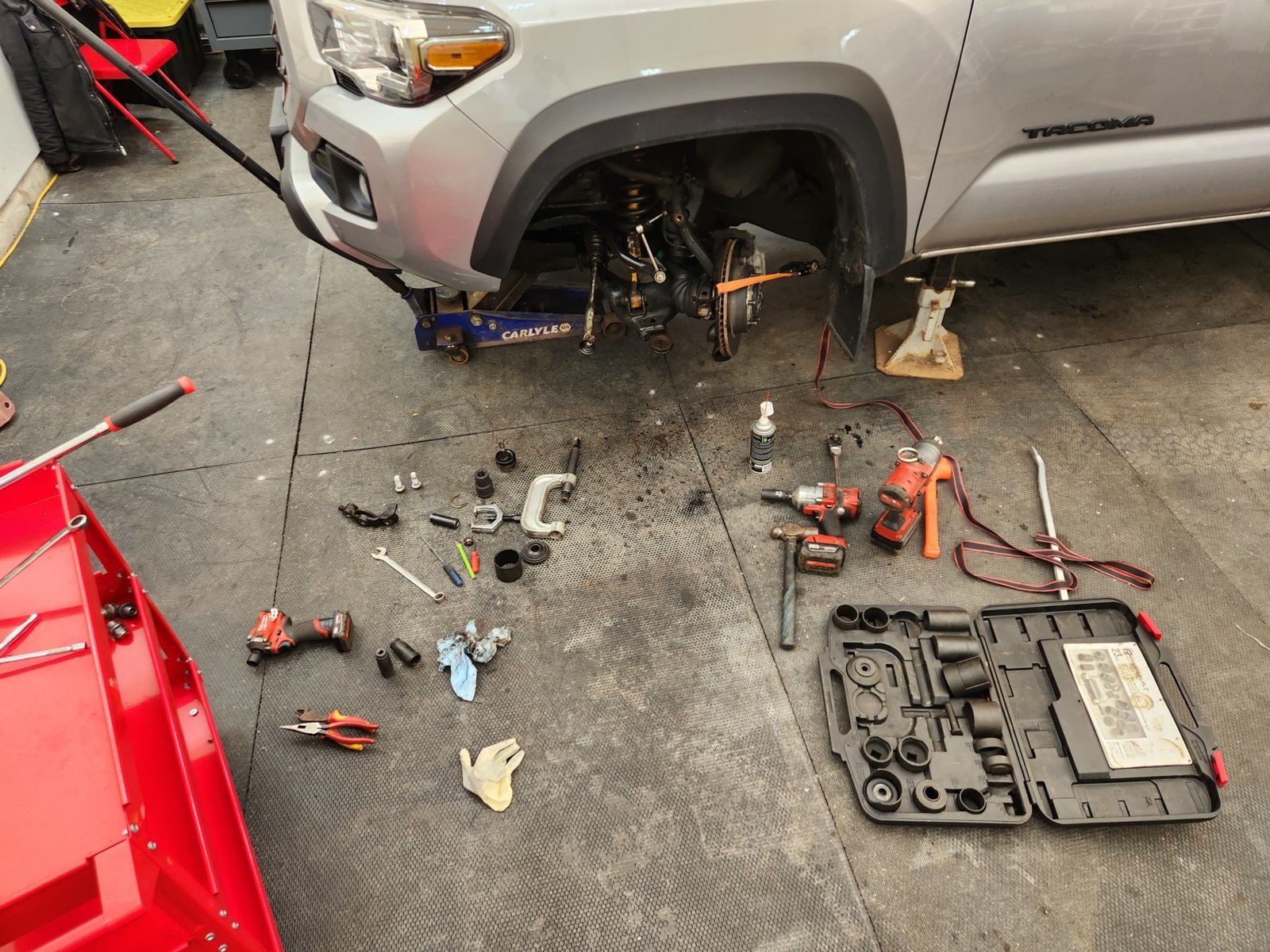

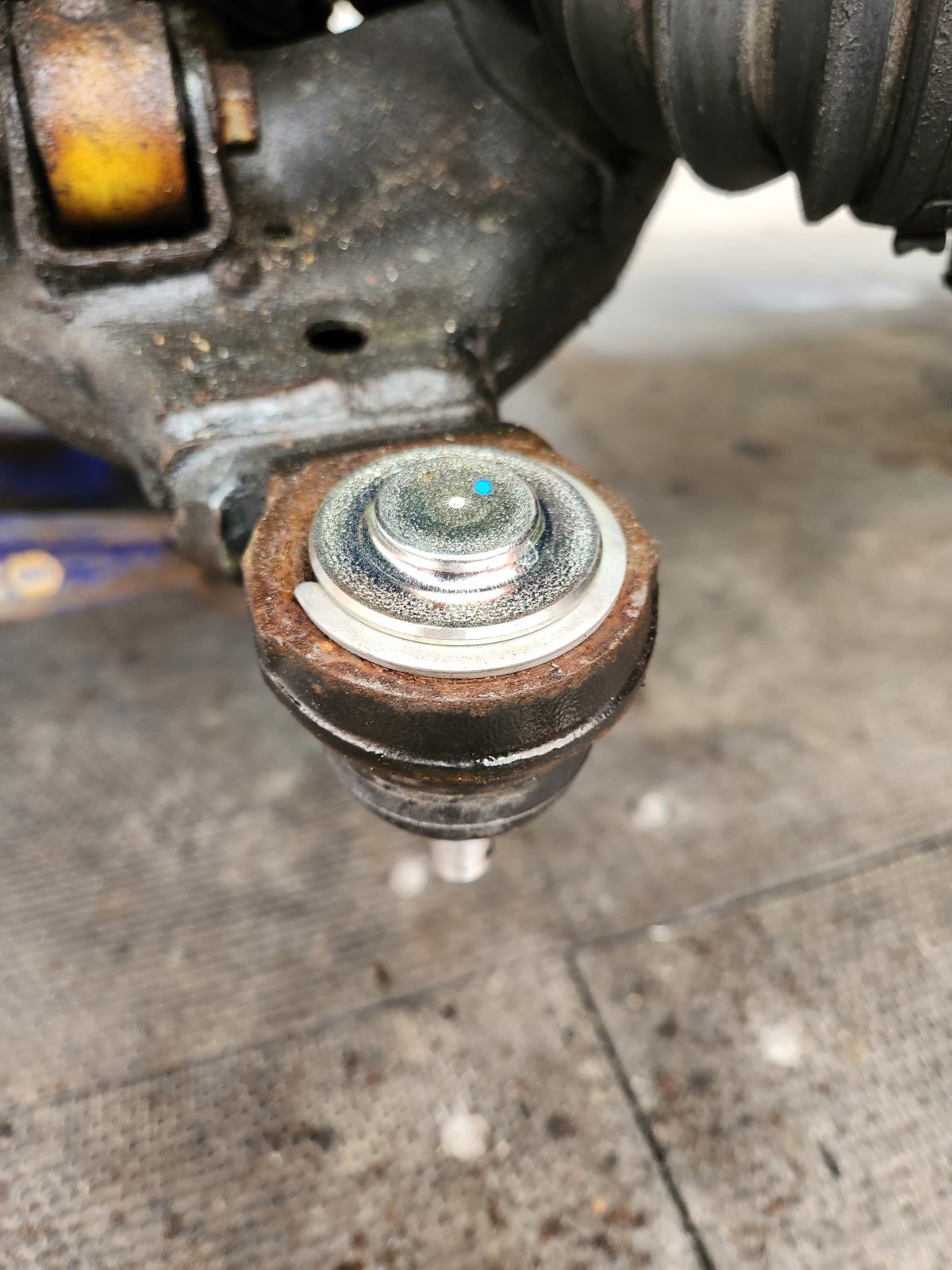

    I got a pair for $130, installed one and stashed the other. Fit perfect, was definitely OEM. The only noticeable difference between the hilux one and the one I pulled out was shorter threads on the hilux one, but still plenty enough for the castle nut to do its job. Install was a breeze with kit #46 from advance auto, but I did have to break out the 1in milwaukee gun from work to get the old one out using the press. A breaker bar probably would have worked too, but taken way longer.
    Technique[QUOTED] likes this.
