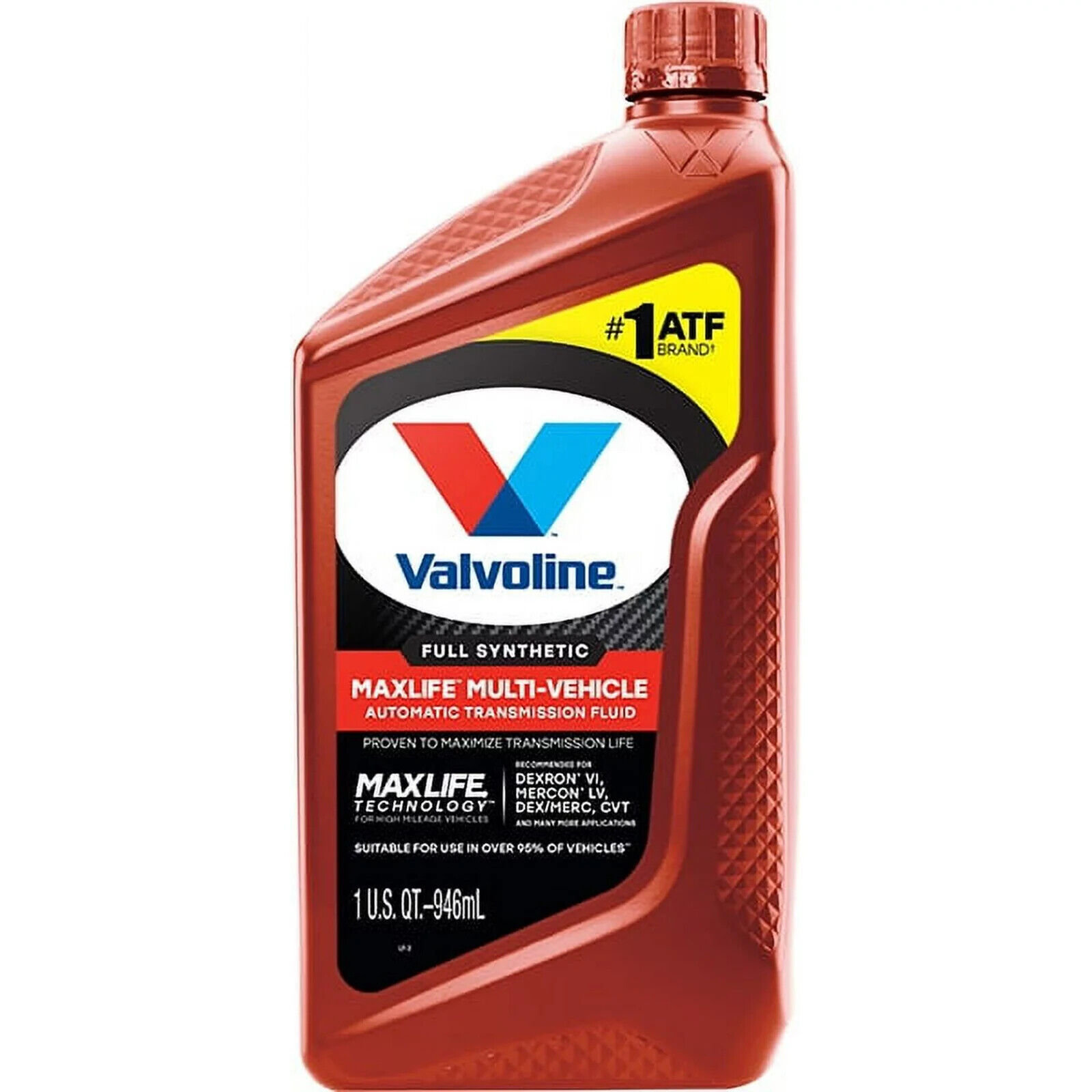

    For power steering, most here flush and switch over to synthetic ATF.
    Valvoline MaxLife atf is popular here, or for economic, that super tech atf from Walmart.
    Or any Dex III atf or newer will be fine.
    If you don't know what's already there, got to flush all the old stuff out.

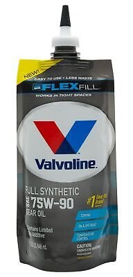

    For differentials, gear boxes, a good economical choice is those squeeze bottles of the synthetic Valvoline 75w90.
    Last time they had those on sale at Advance...2 for 24.99....

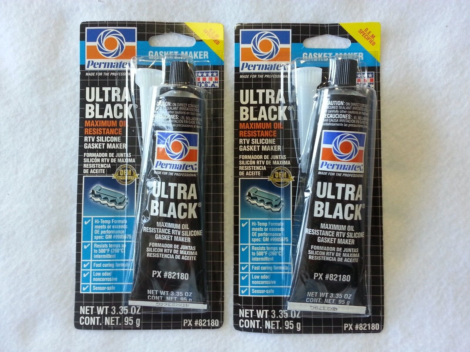

    I was under the impression that the dot5.1 doesnt suck water.....so it could essentially last forever.
    But they thought that too, about that pink coolant, until the blown/leaking head gaskets started piling up.
    If you don't use fipg, you can use any coolant you want, not sure why you'd ever use that either.
    For coolant I recommend Peak 10x..... dont be a cheap lazy ass....change it every 3yrs
