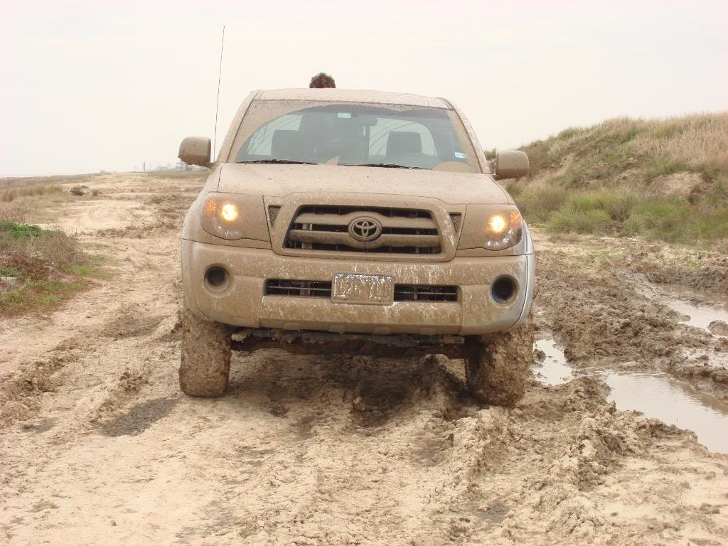

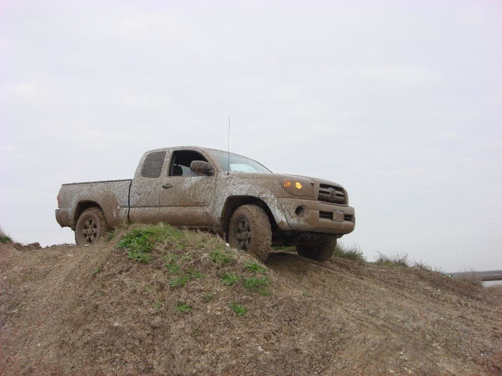

    Well, I love and HATE mud.
    I went mudding in my pretty much stock Taco a few weeks ago, I only have 265/75/16 Mud tires. I bottomed out a few times, But I hit the mud holes at a pretty fast rate of speed. I also pulled out my friend in my pretty much stock 2.7 4x4. here is a few pics.

    TACO FTW! that was awesome:rofl:

    Very nice, not much else to say. Brought a tear to my eye...

    Especially the little victory dance. Hahahahahaahahaha :D

    nice recovery...i think you need a longer recovery strap though lol. it looks like it's abotu 6 feet long. unless it's the camera angle.

    Well I don't have a tow strap, Yet. It was a choker

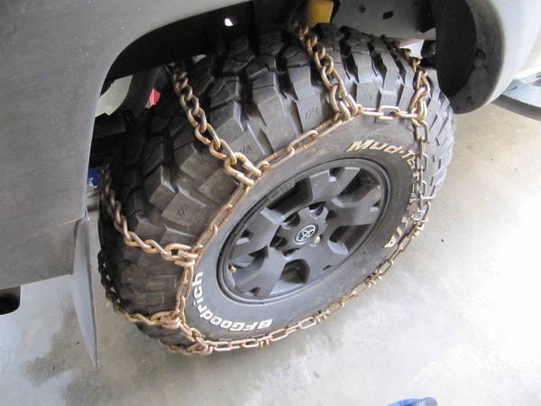

    Carry Truck chains for like snow. They work quite well for mud, snow, and even rock. I have been using them since I started driving for numerous occasions offroad. You would be surprised what chains can get you thru.
    You just want to make sure they are tight and that you have the rubber bungees to keep them tight. Keep a pair of channel locks to help tighten them and if you dont have bungees, rope will do. I learned this from Logging, most of the heavy skidders run them up in the mountains when it is really wet.
