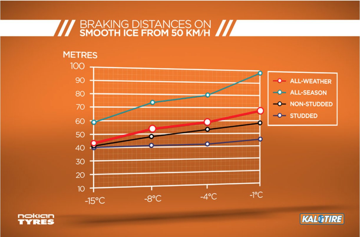

    Tires of the KO2 and Duratrac variety are essentially all season tires because of the rubber compound. They have a light amount of siping. A tire like a DMV2 is a true winter tire.
    If you live in Rochester or anywhere around there, you want a real winter tire, believe me.
