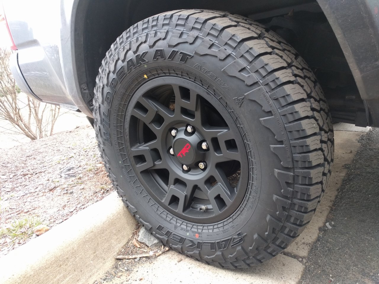

    I can't really justify a dedicated set of snow tires and wheels where I live so I've just been buying 3 peak mountain snowflake tires for the last decade on my vehicles. Falken AT3W 265 70 17 Standard Load pictured here. Falken also makes a 265 75 16 in both standard load and E load. I would not get an E load tire if you aren't doing any crazy wheeling, and I would not try fitting a larger tire on stock suspension. I finally saw snow for the first time after the tires were about 12k old and they were solid. It was a little easier to get the truck fish tailing on ramps with the stock Firestone LE2. Maybe your local sub-forum has some info about what others are running in your region.
