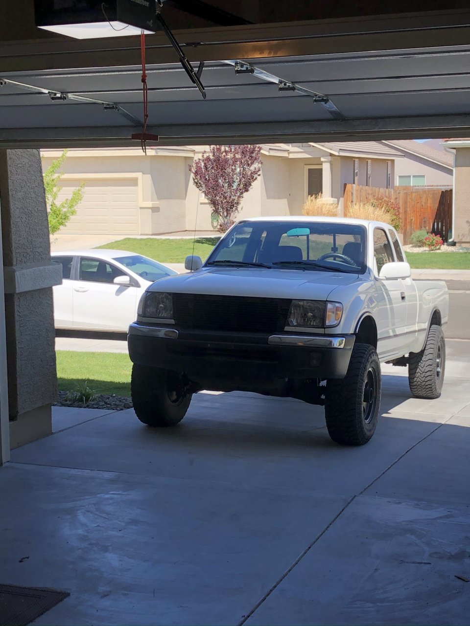

    Bilstein 5100’s with ome 881 coils on lowest setting, JBA upper control arms, LCE header, 31x10.5x15 falken wildpeaks.
    I have 5100’s with ome 880 coils on it now set at 0”. They ride like shit.
    how are the stock uca’s with those 5100’s? Might throw my stock uca’s back on
    no I mean they ride fine but I don’t like the stance. Lower in the front and I don’t want to move it up a notch because it would probably ride worse than it is now.
    this was stock everything with 1.25” spacer up front. It was nice. I loved the stance and the ride was fine. I did a pretty risky trail in the sierras from king canyon water fall to spooner lake. It wasn’t anything crazy but I did it all stock. A couple steep washed out spots and it did great.
    I know I didn’t say you did. I was mainly saying I did it with all stock parts. So I might go back to all stock parts.
