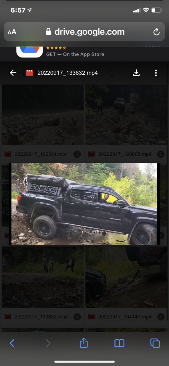

    Here is a pic of 255/80/17 wildpeaks, love ‘em.

    Did your 255/80/17 wildpeaks require any trimming or spacers? Those look pretty sweet. I was hoping to avoid going to the bigger wheel and the cost that goes with. Ugh

    No sir. I’m even running stock mudflaps, no rubbing at all at full stuff.
    Sema wheels are +4mm, that seems to be the sweet spot if you wanna avoid trimming/cutting.
    Also, every truck is a bit different. What works for me might not work exactly the same way for you.
