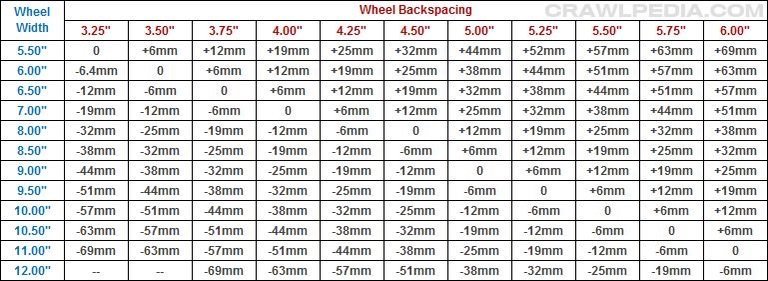

    I'm looking at getting some TRD Pro Sema rims. Not sure if I want to go 4runner 17X7's or aftermarket 17X8 to fit wider tire.
    I believe the OEM 4runners are 0 offset pushing the rim farther out? is this better to avoid rubbing?
    Aftermarket have offset options What would be best if stock height? or with a 2" front 1" rear TRD factory Lift?

    Whatever width and offset you go with just make sure you maintain proper backspacing so you aren't rubbing the UCA

    The 17x7 are a +4 offset not zero. IMO I’d go 8” 0 offset.

    ⬆️⬆️⬆️Correct. OEM Pro Sema’s are +4 offset.

    What is best for stock suspension and a larger tire?
    What is best for 2" lift and larger tire?
