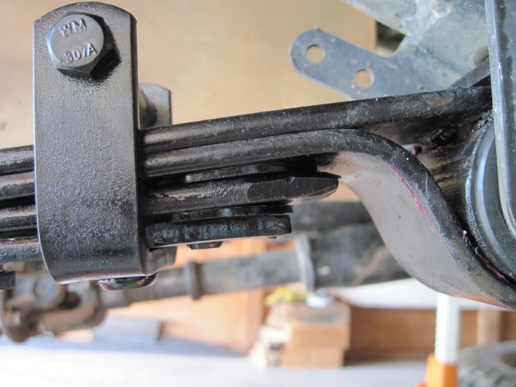

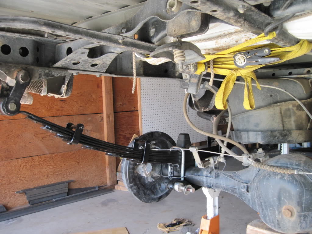

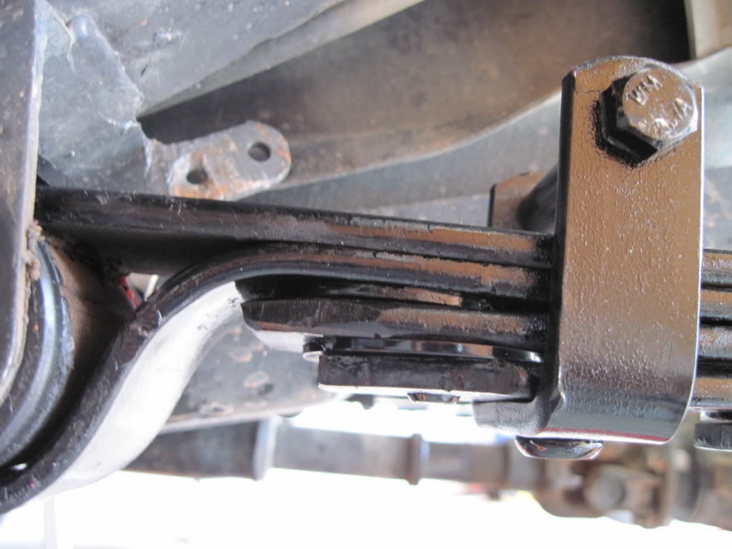

    Deaver leaf springs are progressive...
    a custom set of Deaver leaf springs would do well for ride and flexibility.
    I have a custom Deaver 9lf set up.
    pre-load (lift) was set up for 1/4" difference
    between the passenger and driver spring.
    The driver's side having the additional pre-load (arch)
    The different spring pre-load (arch) compensates for the driver's side additional weight.
    and I didn't need pre-load the front coil-overs in further compensation.
    I utilize Bilstein 5125's out back
    and Donahoe/Icon 2.5's up front.
    the later is set up for approximately 2.5" of lift.
    I roll 297/75/16 currently... but they rub somewhat off road.
    a 285/75/16 was a better fit... hardly rubbed at all.
    and I'll drop back down to those next round.
    Keep in mind all leaf springs will settle a bit over time/gravity/weight/use.
    No biggie cause the Deaver folk can re-build/alter your initial purchase
    for a measly $ 200. (for as long as you own them)
    Of course shipping would less exciting...
    But they're somewhat local to me so that is easier.
    Initially I purchased Deaver's production 8 Lf spring paks
    Several years later... after settling more then I liked...
    I had Deaver convert them from the 8LF production paks
    to custom 9 lf paks (additional leaf)
    I also requested that Deaver alter the leaf springs slightly
    so that I might minimize axle wrap.
    This design virtually eliminated the dreaded axle wrap
    but still articulates fully and rides well.
    pics of my cust. Deaver 9 lf springs W anti wrap design...
    next two pics are the forward side of each spring end.
    ^ no I don't work for Deaver...
    I just like my springs and my original investment of them
    Customer service is one of the best out there regarding custom work ;)
