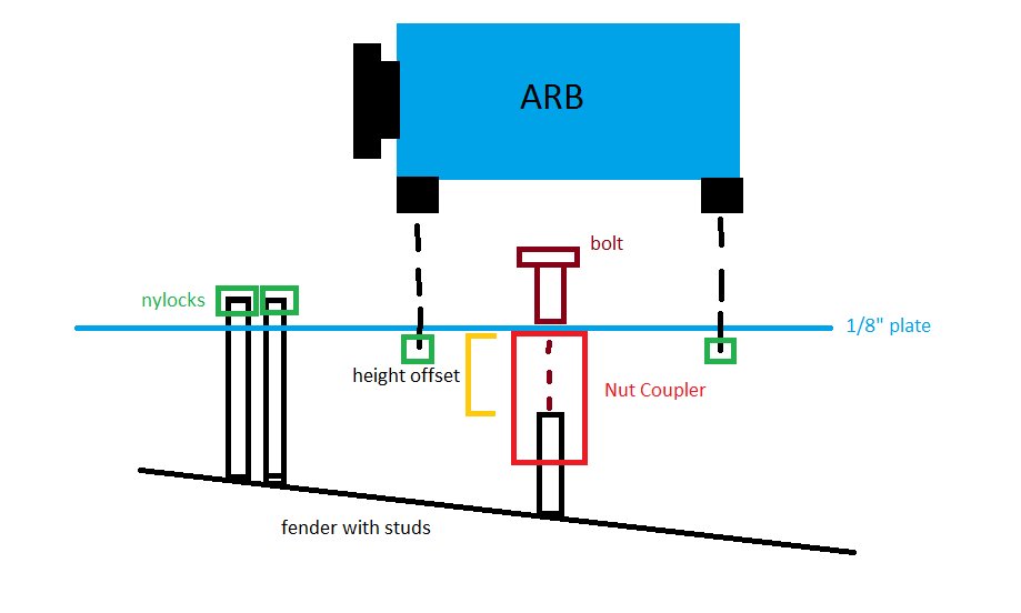

    I have a 2nd gen, so not sure if it is the same (I think it is), but the OR models have 3 M8x1.25 threaded studs on the passenger fender in the engine bay.
    I had a piece of 1/8 inch steel cut to fit and drilled to accept the stud pattern, then secured with 2 nylock nuts and 1 bolt.
    On the 2nd gens the 3 bolts are on a slant, so I had to use a nut coupler for one of the studs to make a sort of pedestal to get the plate level. I used nylocks on the 2 even ones and the bolt through the plate to the nut coupler.
    Here is my MS paint blueprint (pretty good right?)
    EDIT: I forgot I had 2 nylock under the plate on the even studs to it wouldn't shift up or down. I also put a metal fender washer on either side of the plate with a pair of rubber fender washers sandwiched in between to isolate some of the vibration.

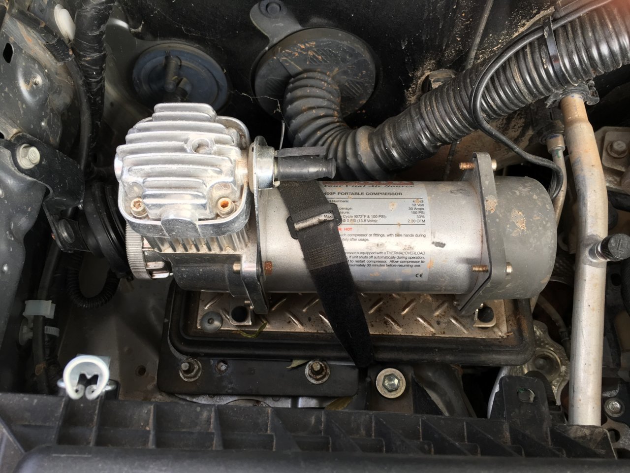

    Hers my install as promised. Not really a good picture, but it shows the location, and I fabbed a two-piece steel bracket similar to what @Gunshot-6A showed in his post. It’s held up for over a year ... the black Velcro strap is there just to hold the compressor from rolling around if something breaks. Haven’t needed it yet :)

    Looks good

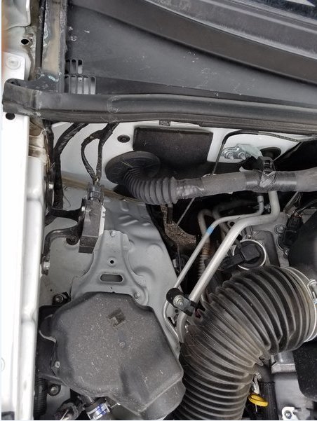

    Bit late, but where do you have the alligator clips? I see youve ziptied off the power cable, did you remove the alligator clips and just permanently connect to the battery like you would with any other accessory like an led bar?

    It’s hard wired into a fused lead off the battery. By the way, I guess it’s been another year with a few hundred more miles of dirt and trails, plus 10K or so pavement, and the bracket is still holding up.

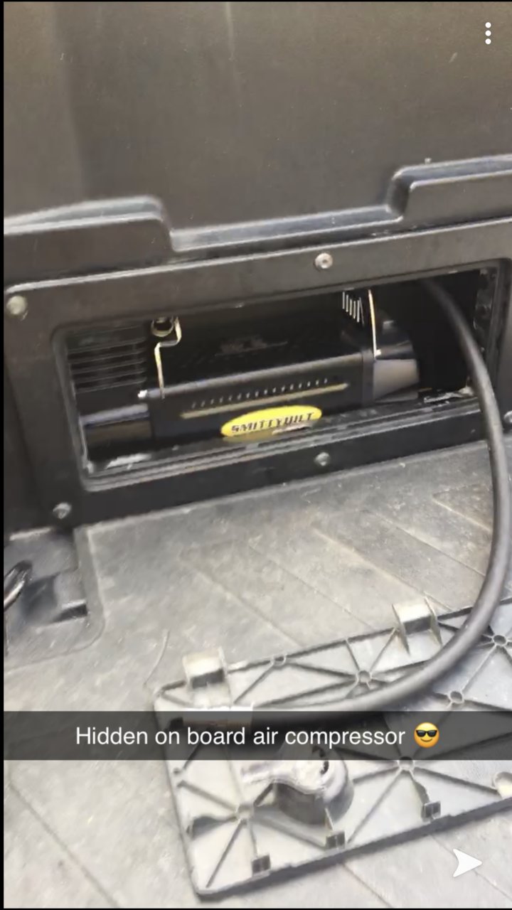

    I have a Smittybilt 5.65 compressor mounted to my bed pocket, with overland essentials compressor mount.
    Hardwired in, without a tank.
    Currently with 33’s it does well, I may add a tank at some point, and a custom hose setup so I can air up all 4 tires at the same time at the same psi.
