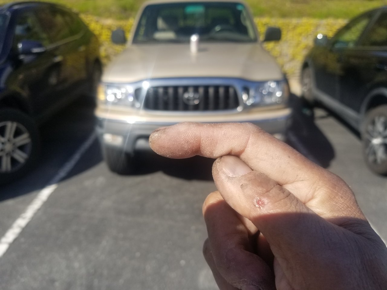

    I just installed a new set of Brock headlights. $60 for the pair on partsgeek.com.i will let you know how bright they are compared to the yellow OEM. Here's a picture

    My new headlights are way more better than the OEM set. The light is not only brighter but more white than yellow. I can actually see at night! Very happy with my choice
