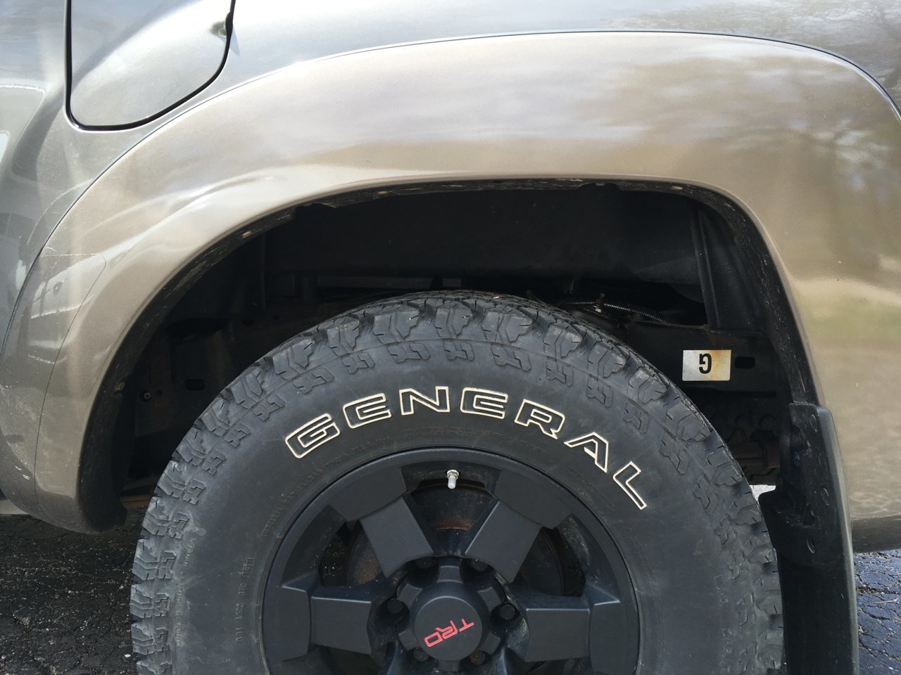

    I just installed new suspension all around, with a 2.5 lift in the front, as expected, my rear sags about 1-1.5 inches. My mechanic suggests throwing a block in there and calling it a day... I'm not totally oppose to that solution, but I also don't want to rush into that solution just yet.
    With how my brain works, the image of me towing with a block freaks me out, and seems abrasive over time. Replacing my leafs and/or adding a leaf wasn't really in scope for this project but I have not ruled it out, especially if it's the most sustainable/reliable option (my current leafs seem to be in fine condition). Though, more recently I have learned about adding airbags (concept still quite foreign, would love insight on this). Based on people's experiences with the airbag solution, towing seems like a breeze.
    My goal is the get my rear up slightly above my front, to eliminate my sag all together, and hopefully eliminate ANY sag while towing. Have any of you went through this decision process with similar use cases to my own? What did you decide?
    Please note: until I find the right solution and implement it, I wont be towing anything.
