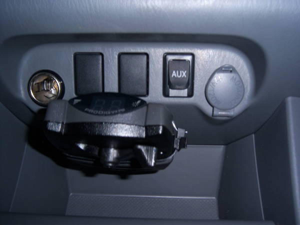

    Thought I'd post a picture of where I mounted my Prodigy P2 brake controller inside the cab of my 2012 Taco. Looked everywhere and decided here. The extra plug and play cable had to be cut and lengthened to make it work. but that's why God made butt connectors and shrink wrap.
    1. Used a good amount of velcro
    2. Drilled hole one inch from the top of the compartment
    3. Easy access to run the cable
    4. The harness hookup is there about 13" above the floor inside the left kick panel.
    5. Used the wire from the factory supplied hookup to extend the length of my plug and play harness.

    I mounted mine there but i centered it in that opening. I bought a new travel trailer and the RV technichian installed it just to the right of the steering column. I had to move my leg to see it. This seems to work alot better now. Nice job

    it won't be in the glove box. You have to pull the left kick panel off that's by your left foot. It will be a white connector about 15" above the floor. It does want to hide.

    Also put mine in the cubby hole in front of the shifter. Looks neat and its not gonna get knocked around when I get in and out of the truck.
