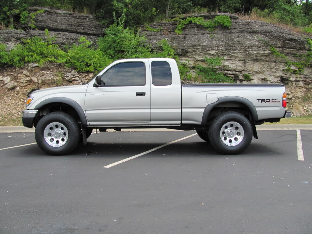

    Bilstein 5100's / OME 881's / Wheelers 5 leaf pack / ProComp 1069 wheels / 265/75-16 Michelin LTX tires
    I have the procomp 1069's with 265-75/16's. The procomps have 4" backspacing and they tires stick out 3/4" from the factory flares. No wheel spacers.
    Note: You will have to modify the center caps on the procomps. There is a tight fit between the rim opening and the factory hub lip and I had to score each cap several times to get it to fit and it was still a bitch. Of course, you will need new lug nuts as well.
    sorry not a better pic available:[​IMG] IMG_0261_da2584d91ee046718dda15cf13c073414b8bfd68.jpg

    will running 265/70/16 mess up my truck? I bought the truck with those tires on... I hope not. I'm assuming I would get the 16x8?
    Truck looks great! Mine is EXACTLY the same... thanks for giving me a visual of what it will look like.
