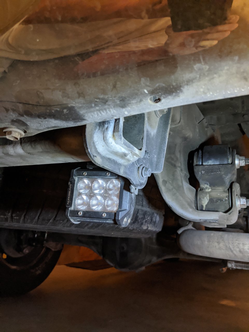

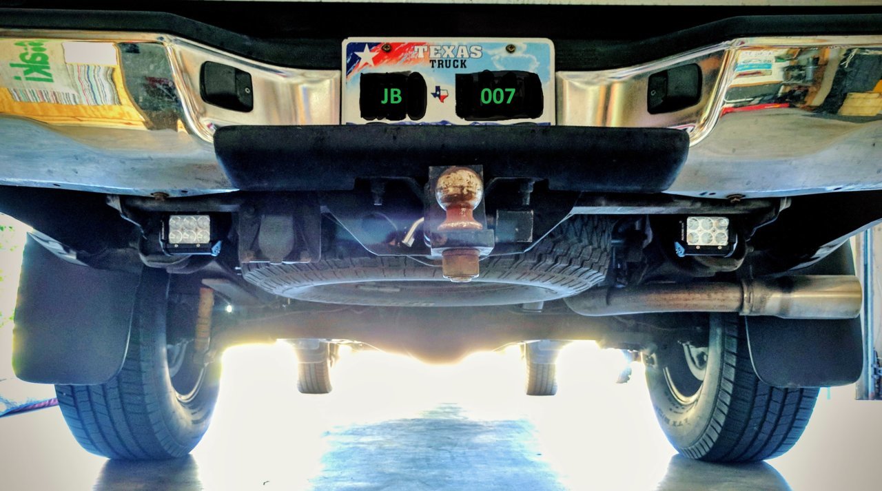

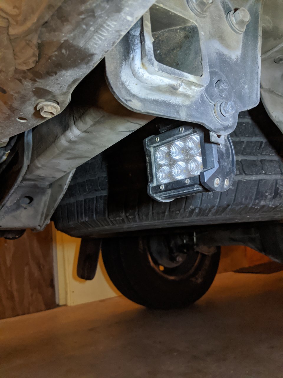

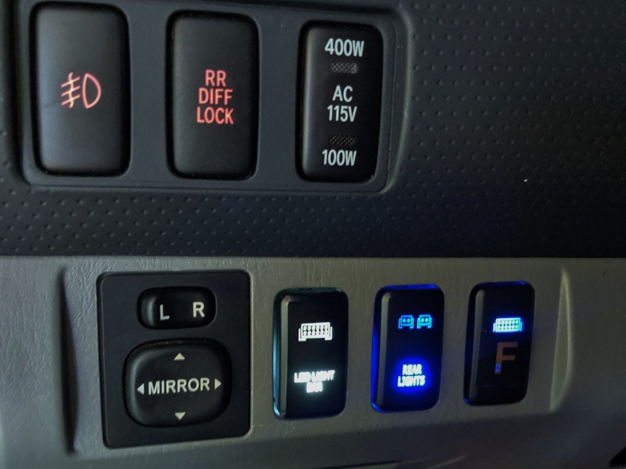

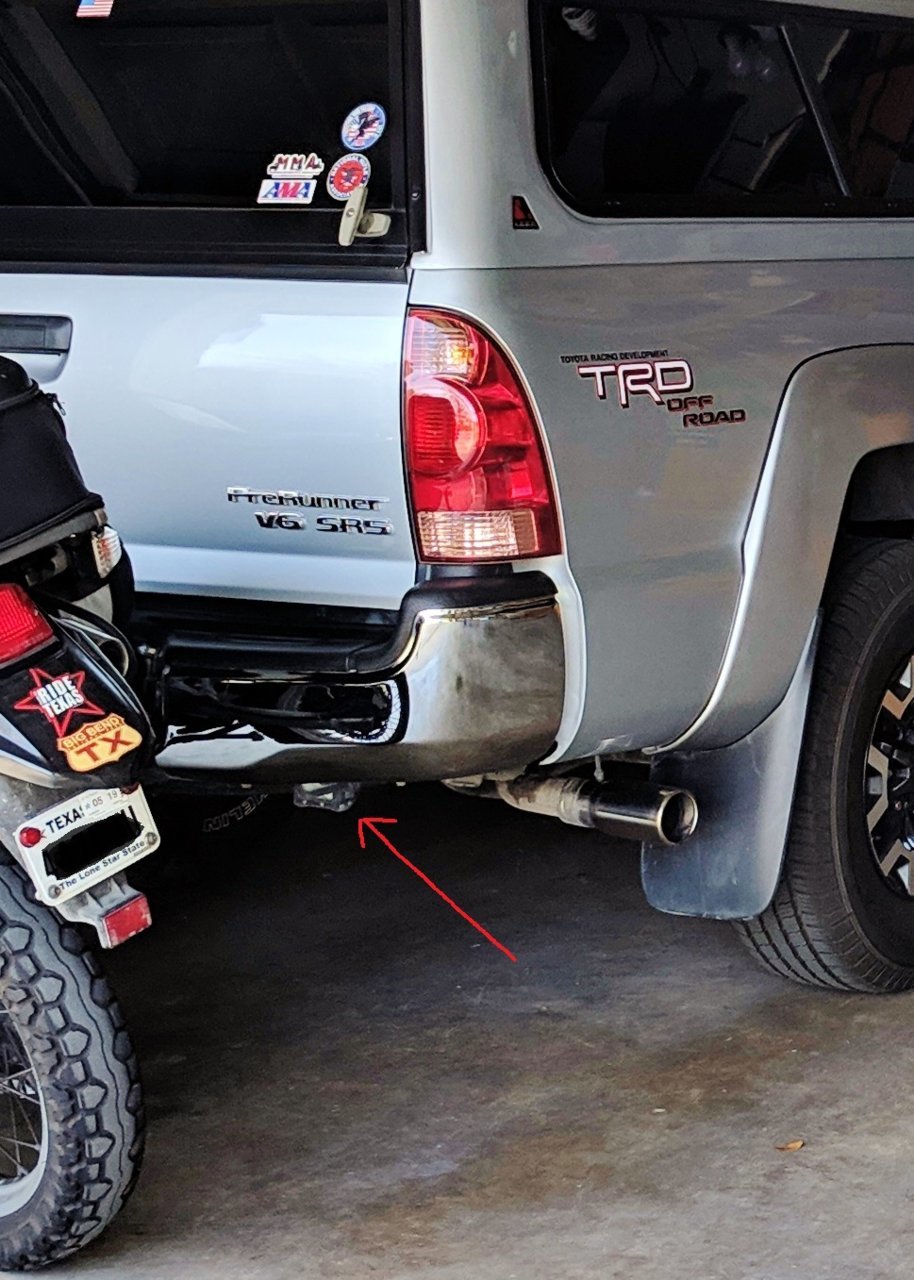

    Here's another idea. About 3 years ago I puchased 4" auxbeam light pods and mounted them upside down using a simple "L" bracket. They are mounted under the bumper, but not on the bumper. My truck has a factory tow package so I utilized where the factory hitch connects to the frame. I wired mine to a toggle switch in the cab so I can turn them on and off at my discretion. I've attached a few pictures for reference.

    I have both the GY6.35 bulb upgrade and Rigid SRQ diffused flush mount backup lights installed. I'd start off with the simple bulb upgrade and see if it is good enough for you. Those alone were not bright enough for my situation living in an area that has very poor street lighting. The Rigid SRQs solved that problem. If you do any type of off-roading I would not install lights under your rear bumper. They will get ripped off as easily as the factory tow plug.
