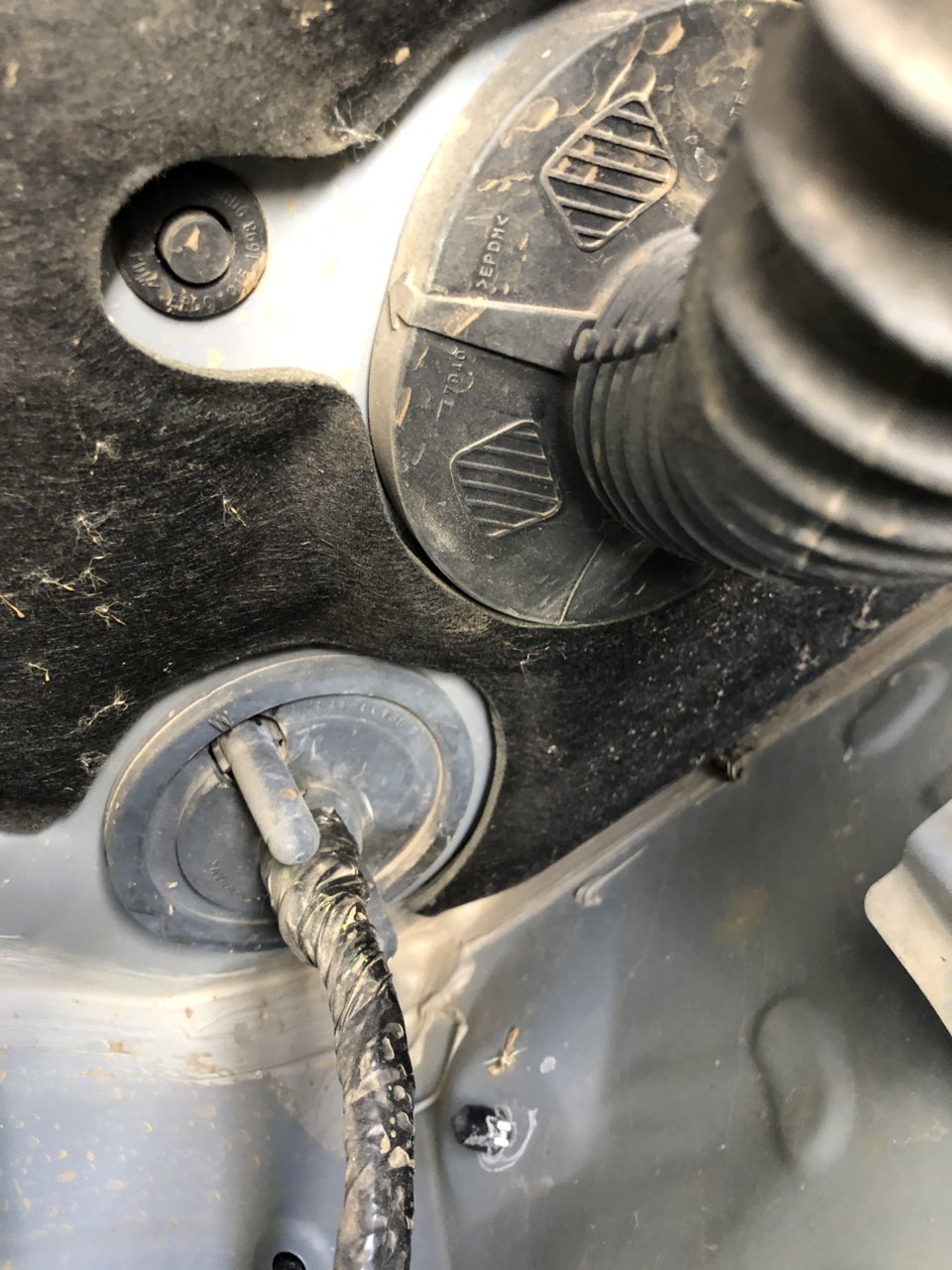

    Where is the cleanest yet simplest place to run a RG58 coax cb antenna through the firewall of a ‘19 TRD OR for passenger side hood mounting? I see 3 possible places in this pic but under dash access is limited at best. Below this area is what looks to be a ac drain hose with excellent access and seemingly close to zero risk of decreased flow. I don’t know about potential wear but a test fit did not show any signs of scraping so I’ll assume there’s a rubber grommet in place. D35C993A-5B30-4B5F-AB25-E94CD2AB9D8B.jpg

    While you’re in there extend the drain hose so it doesn’t drip on the frame anymore. It’s one of those mods.

    I’d run it through the driver side hole and across the rear of the engine bay. It’s easy to push wires through the driver side boot. Just use a razor to Slice a hole.

    Not a bad idea but I’m saving that hole for wiring.

    Thanx man. Already using that for wiring. I’m assuming wires and coax don’t play well together so I’m keeping it separated the best I can.

    2017 TRD Sport 1D6
    I used that top left plug on my 2005, worst part was reaching up inside and getting it..
    I had to open it a bit because I had the PL59 going through there. Grommet went back on after with the middle cut out.

    I was close but then I was bathed in the light from the ac drain hole and ended up basking in it. I’ll save that one for something else down the road.

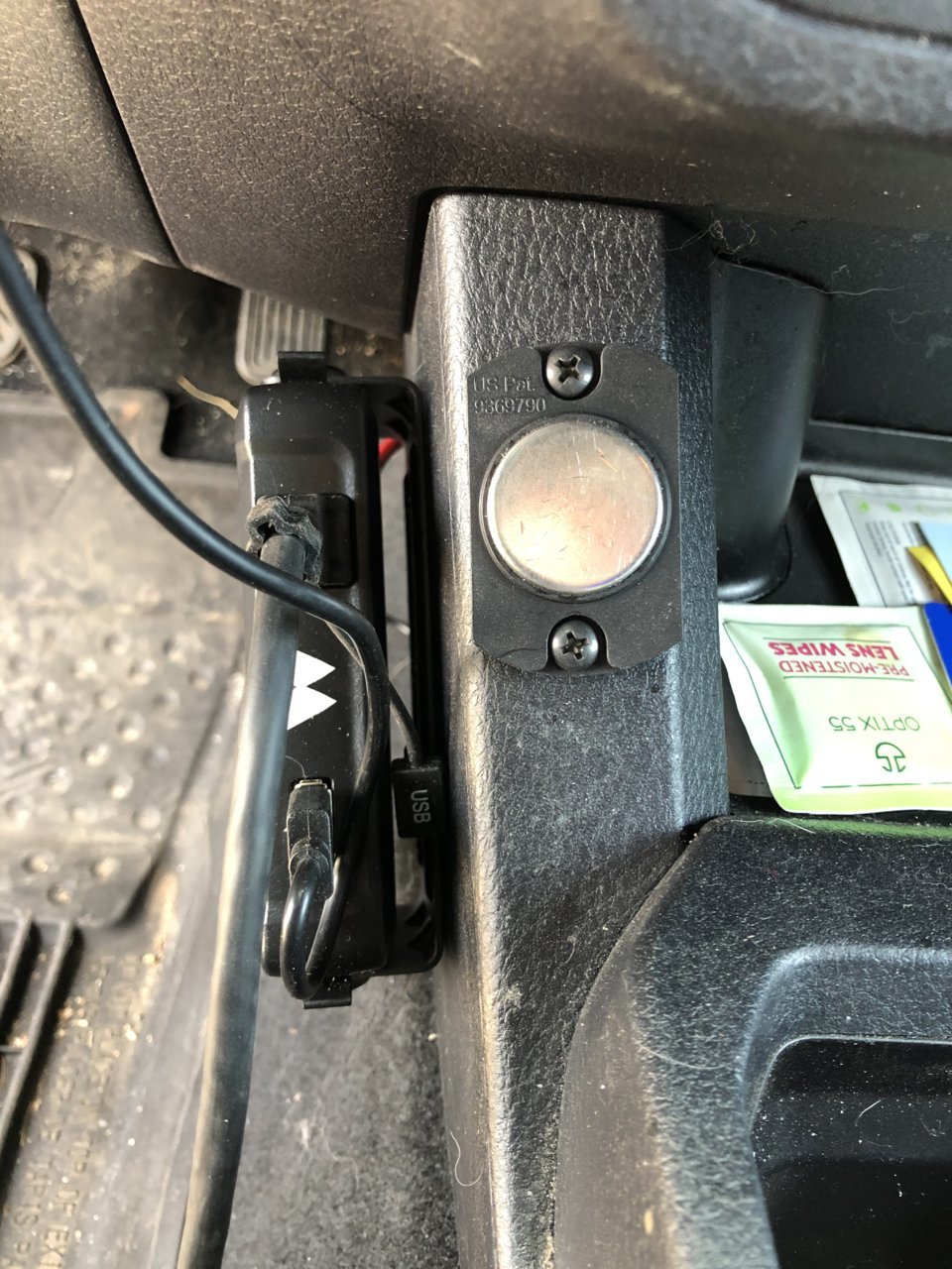

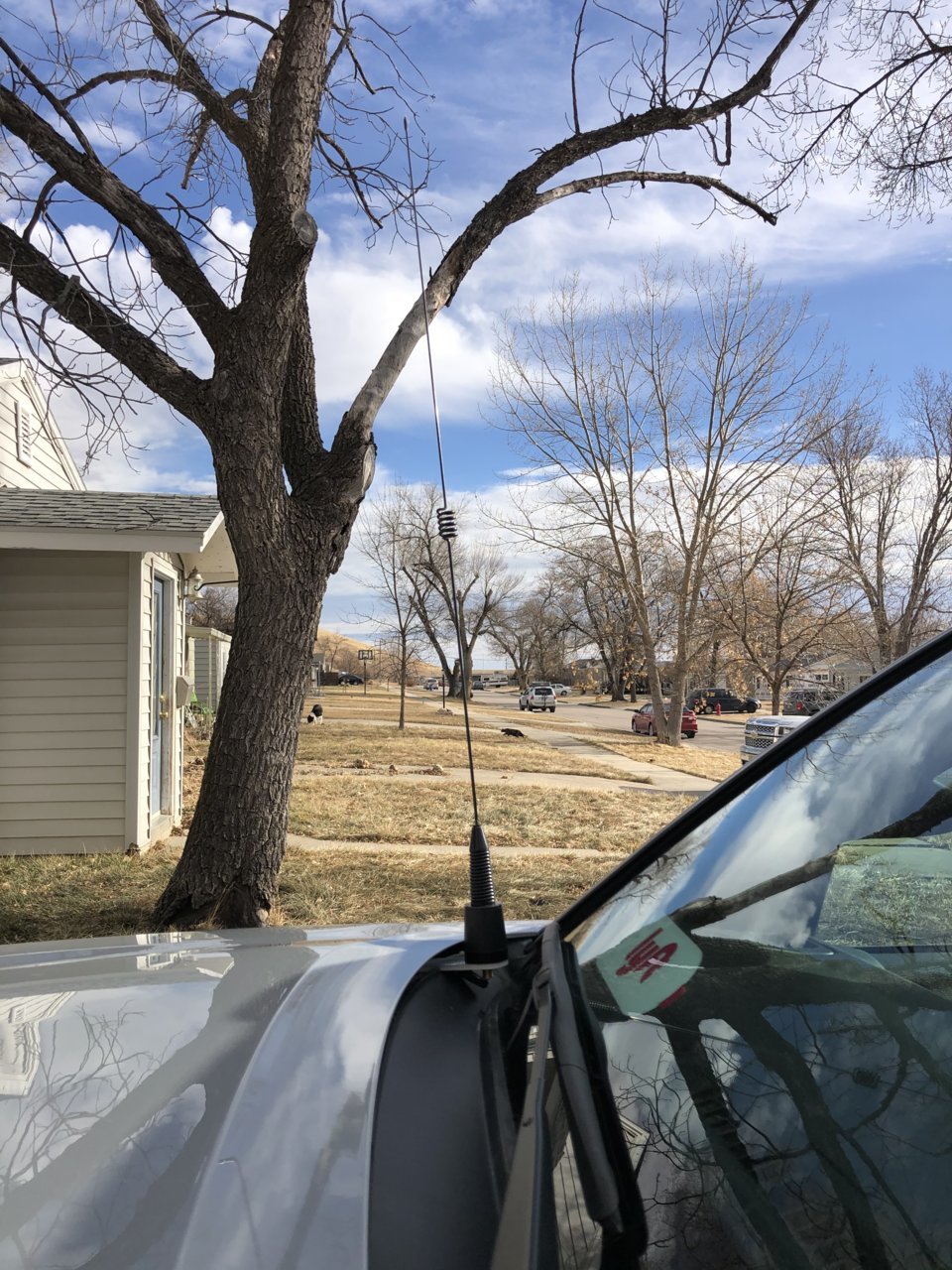

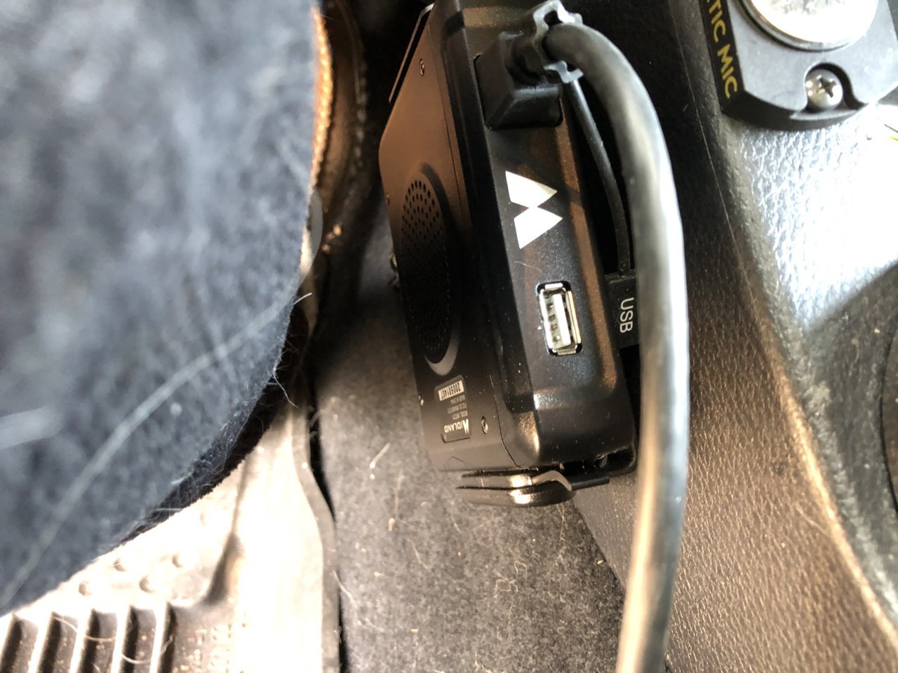

  15. Jan 5, 2021 at 11:09 AM
    cactuscorn
    cactuscorn [OP] Another FNG
    Oct 20, 2010
    #44966
    983
    Rapid City, South Dakota
    2019 Cement TRD OR AT DCLB w/JBL Premium Package
    Ironman Stage 2 FCP 3" lift kit, Ironman skid plate kit, C4 Fab Hybrid front bumper and frame supports, C4 Fab sliders, Smittybuilt X2O 10k lb winch, Diode Dynamics Pro fogs, Baja Designs Sport fogs, Falken Rubitrek AT's, Midland Micro MXT275 GMRS radio, Victory 4x4 hood hinge antenna mount, ARE MX shell, 12 Volt Solutions remote starter w/ phone app module, Overland Equipped aux power tray/Blue Sea 12 circut ST blade fuse block w/ 187 series 100a circut breaker, OEM bedmat and floor mats, Hooke Road tailgate cover, JDM ASTAR 800 lumen LED reverse bulbs, iOttie wireless phone charger, blue LED dome light, back seat dog bed and rear seat12v/USB ports, Ironman diff breather, ac drain mod,, tons of rad recovery equipment and every cubbyhole filled with crap. On order: Method MR 316 wheels and 285/70R/17 BFG KO2's.

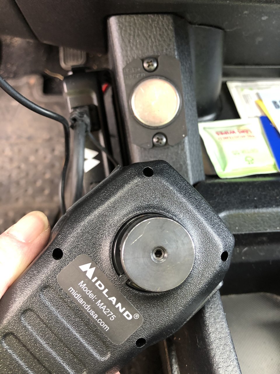

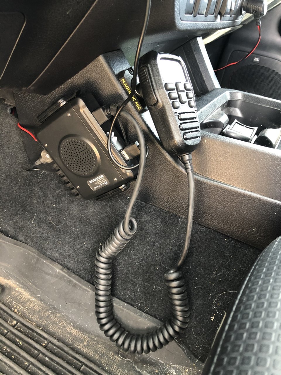

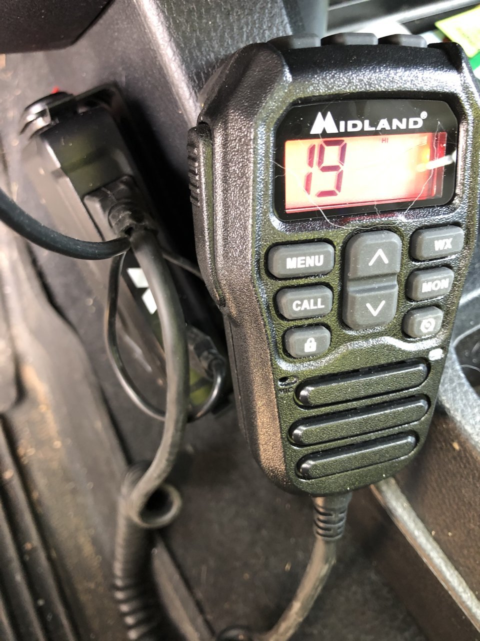

    After all your help, I’m ready to give a little preview of the installed radio. Keep in mind it’s not yet finalized but I have a solid start, just have to tackle the PL259/RG58 soldering and mount/wire the Blue Sea fuse box when it arrives.
    The goods minus my JCR antenna mount.
    My first impression is positive. Unit is well placed with clear audio, zero leg interference and a easy to reach mic placement.
    Plenty of room with a size 9 Sorel slipper centered on the go button.
    Think I’ll dig the magnetic mic mount. Keeping everything tucked in and tidy.
    Gotta tweak the antenna mount for a slight angle correction but otherwise I’m pretty stoked.
