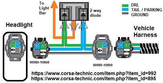

    So, I have the Baja S8 20" light bar to hook up soon. It has a backlight feature that is most commonly hooked up to the DRL circuit, from what I can tell. This backlight feature is secondary. Primary feature is, of course, the actual main lights of the light bar. I have the primary light circuit sorted, as I have an aux relay/fuse block that I put together last season. I left a relay free for this eventual install, switch is already wired up inside in the dash, etc.
    My questions is, what is the best way to tap the DRL circuit for this lightbar's secondary feature? Tapping one side's headlight wire seems too hackish to me. Is there a better tap in the engine bay on the stock fuse block perhaps? I've seen some posts with this info long ago, but am searching TW now and not seeing what I am looking for out the gate.

    @daveeasa can hook you up to the required gadget. It would be a T between the DRL connector from the vehicle harness to the headlamp.

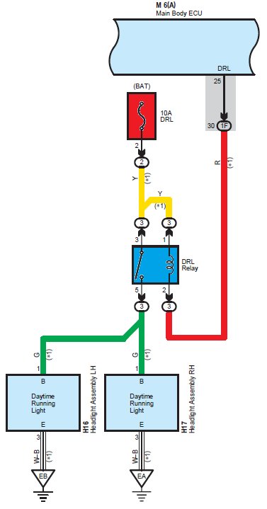

    Any concerns with just tapping one side of the harness, as in, to one headlight vs the other vs at the source of both so it doesn't imbalance the circuit? One headlight load would include the accessory, the other headlight would not. Maybe I just don't understand how electricity works? :rofl:

    Most likely not. Just don't go adding a half dozen light bars with the same feature to it. That would require a very different solution.

    Just this one light bar's DRL feature is all I am planning to add to this circuit. Still, I'd rather hook it up to the source of both headlights DRL circuit rather than to one headlight's side or the other...

    If you find a way to slip a tap on the DRL relay leg that sends power to the DRL lights I would "clear" your doubts. But it's very difficult since the relay location has barriers on the sides.

    Plus, after low beams are selected the DRL circuit shuts of, hence the T harness @daveeasa can provide ya.

    QQ: If I buy one of these thingies and wire a tap from the DRL wire and a tap from the Parking wire into one end and then a wire to my Diode Backlight out the other end, will it work to keep the Backlights on for DRL and Parking only?
  15. Aug 23, 2023 at 3:23 PM
    caribe makaira
    caribe makaira Well-Known Member
    Feb 13, 2011
    #51121
    11,784
    Caribbean, Puerto Rico
    05 PreRunner TRD Offroad AutoTrans
    Hood Struts, My version Fogs always ON, Map & Overhead Light Mod,
    Yes

    Awesome! Thanks! Do I need one for each backlight or do you think I can spice the backlight wires and just use one diode from the drivers side headlight?

    One is enough, but 2 are convenient for the install.

    Picked up one of these because it's a little more streamlined. I will hook it up and report back. Thanks again!
