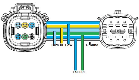

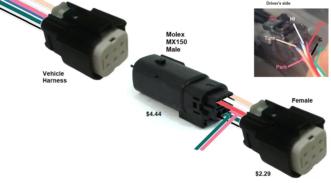

  2. Aug 23, 2023 at 3:57 PM
    #22
    caribe makaira
    caribe makaira Well-Known Member
    Feb 13, 2011
    #51121
    11,786
    Caribbean, Puerto Rico
    05 PreRunner TRD Offroad AutoTrans
    Hood Struts, My version Fogs always ON, Map & Overhead Light Mod,

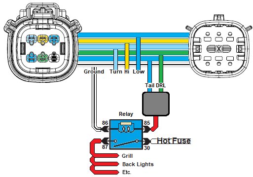

    Get parts on post#8, and assemble the T harness, add the diodes down stream of "T".
    StinkFu likes this.
  3. Aug 23, 2023 at 4:02 PM
    #23
    caribe makaira
    Feb 13, 2011
    #51121
    11,786

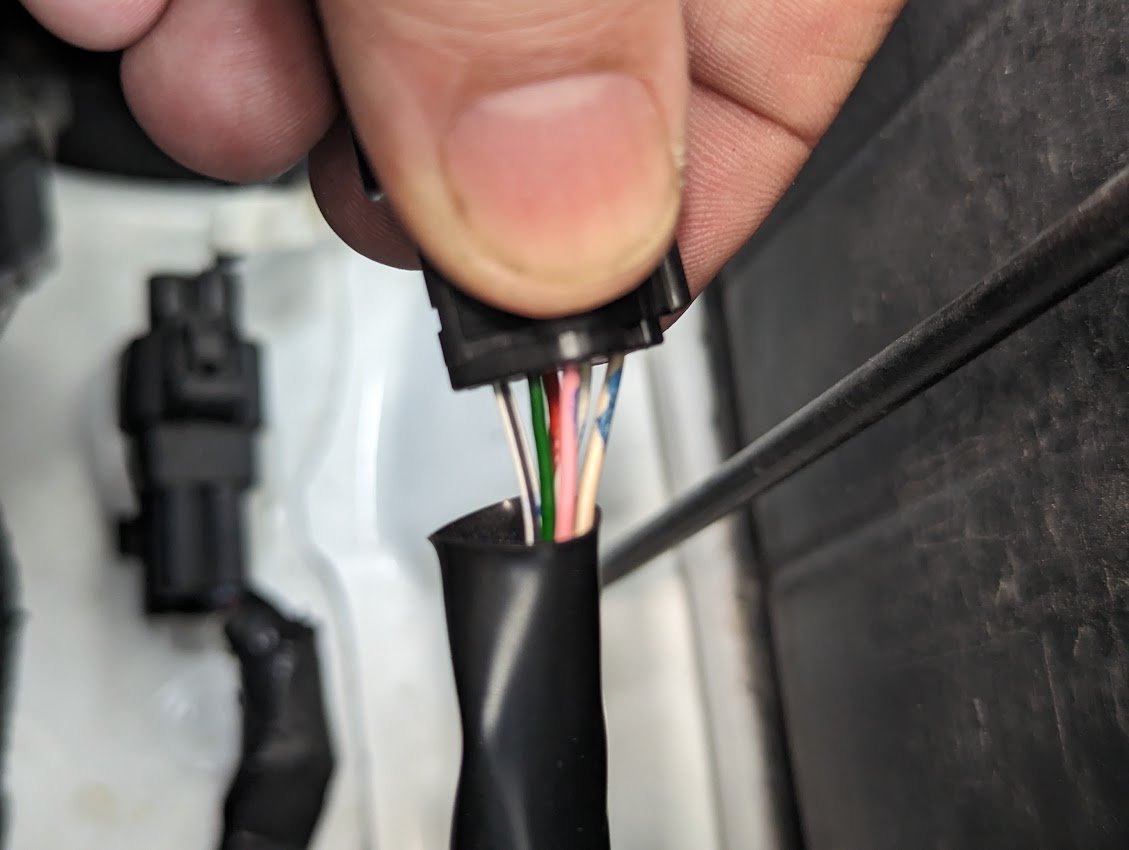

  8. Aug 24, 2023 at 7:59 PM
    #28
    caribe makaira
    Feb 13, 2011
    #51121
    11,786
    Passenger's side:
    StinkFu likes this.

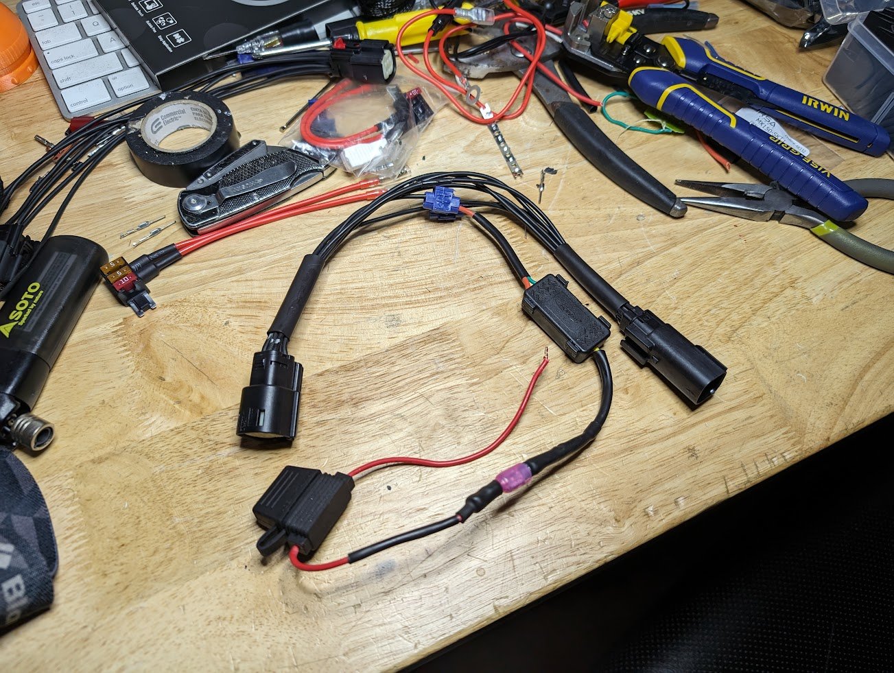

  10. Aug 24, 2023 at 8:48 PM
    #30
    caribe makaira
    Feb 13, 2011
    #51121
    11,786
    Don't forget to heat shrink and add dielectric grease inside the connectors to and from the diodes module.

  12. Jan 12, 2024 at 4:49 PM
    #32
    StinkFu
    StinkFu Well-Known Member
    Aug 25, 2022
    #404346
    200
    Pacific Northwest
    2022 Tacoma TRD Pro MT
    AJT Design Tacoma 4x4 Knob AJT Design Tacoma Climate Rings AJT Design Tacoma Door Handle Covers All-Pro Off-Road HD Rock Sliders Alu-Cab Tilting Fridge Slide Aluminum Radio Knobs Android Auto Cable ARB Twin Air Compressor AWE 0FG Exhaust with BashGuard - No Tips Badland Jack Mounts Badland Off-Road Jack Baja Design Rock Lights / Scene Pods Black Door Handle Covers Bolton Velocity Off-Road Kit Cali Raised AC Drip Relocation Cali Raised Center Console Molle Panels Cascadia 4x4 45W Panels & Controller Ceramic Coating CourseMS Phone Mount Desert Does It Seat Blocks & Panel Diode Dynamics Ditch Lights Diode Dynamics Stealth Light Bar Kit Dual Circuit Breaker Battery Tie-Down Expedition Essentials Panel Bracket Factor 55 HitchLink Flag Stickers Glove Box Letter Inserts GloveBox Organizer Hella Supertone Horn Kit Icon 1.5 Inch Lift Rear Expansion Pack Interior LED Light Kit Interstate AGM 24F Battery KC Hilites Under Hood Light Krazy Beaver Shovel and Cover License Plate Frames Magnuson Supercharger MAXTRAX Xtreme MAXTRAX Xtreme Mounting Pin Meso Customs Gasshole Meso Customs Vent Ring Kit MESO Overhead HexRack - Sunroof Mishimoto Radiator MMRAD-TAC-16 Nilight 3PCS 60 Inch Bed Light Strip Nitto Ridge Grapplers 285/70R17 Quick Charge 3.0 Dual Charger Socket RedArc Dual Input + 40 Amp Fuse Kit Rhino Rack Stow It Utility Holder Rhino Rack Stow It Utility Holder Rhino Sunseeker 2.0m Awning Rhino USA D Ring Shackles Rhino USA Trailer Hitch Lock RSI SmartCap Evo Sport RSI SmartCap Platform Rack SDHQ Battery Terminal Kit Seven Sparta Grill Led Lights Shift Knob Adapter SmartCap EVO Security Screen - v2 Smartcap MOLLE Panel Steering Wheel Cover Steering Wheel Emblem SumoSprings Front SumoSprings Rear Supreme Suspensions Front Tow Hooks Switch-Pros 9100 Switch-Pros Power Tray Wiring Bundle Tacoma Door Clean Up Kit Tacoma Door Sills Tacoma Lifestyle Sequential Turn Signals Tacoma Tailgate Inserts Tail Gater Tire Table Total Chaos Bed Stiffeners Toyota Cargo Net Toyota TRD Pro Shift Knob TRD PRO 17 Matte Black Alloy Wheels TRD PRO CAI Box & Accelerator TruckVault - Utility Height Uptop Alpha Rack - 38" Extreme LEDs Uptop TracMOUNT Vinyl Letter Decals for Tailgate Handle Vinyl Letter Decals TRD Pro Bedside Vinyl Letter Decals TRD PRO Grille VLEDS Dual Output Front Footwell Kit VLEDS VTAILS Taillight Conversion Kit WeatherTech Bug Deflector WeatherTech Rain Guards Wescott Tacoma Fox TRD PRO Lift Kit
    Finally finished and tested my DRL tap harness. Success!!! Thanks so much for the help.
