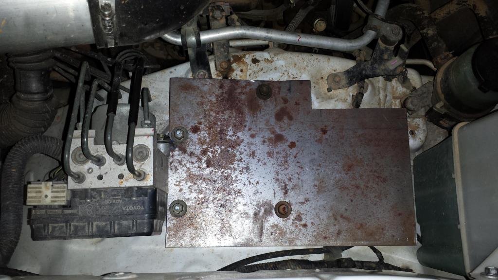

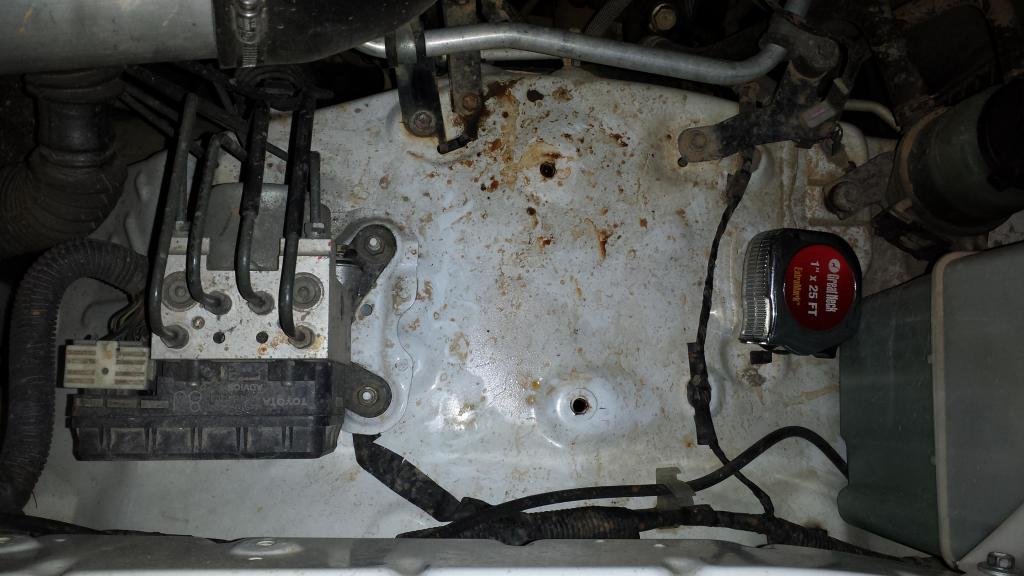

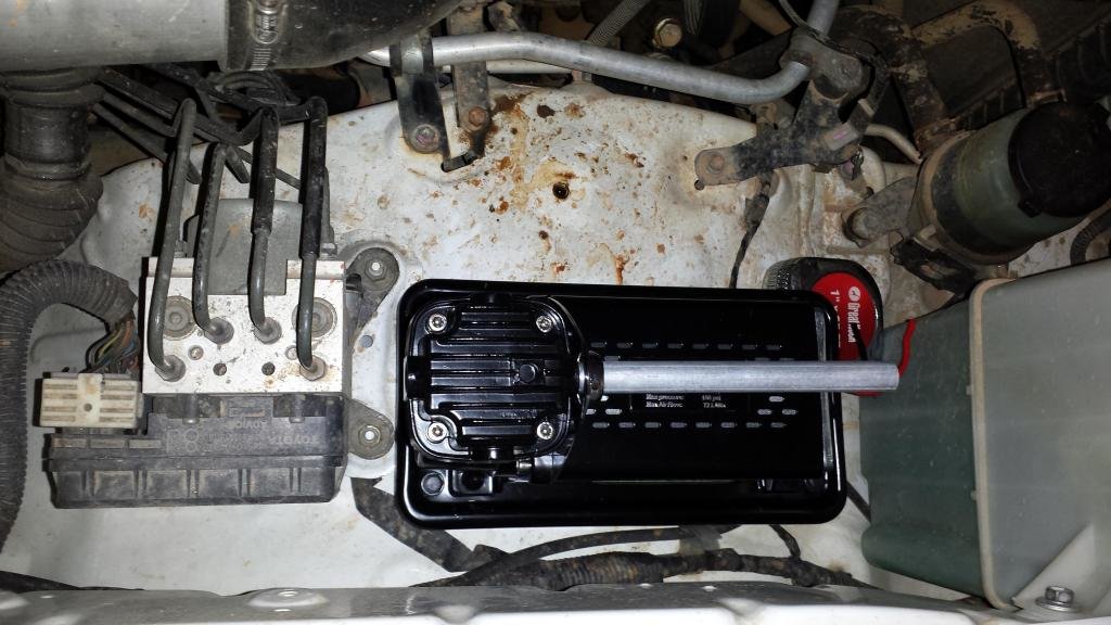

    How would you attach on of these portable compressors on the available 3 mounting screws in the engine bay?

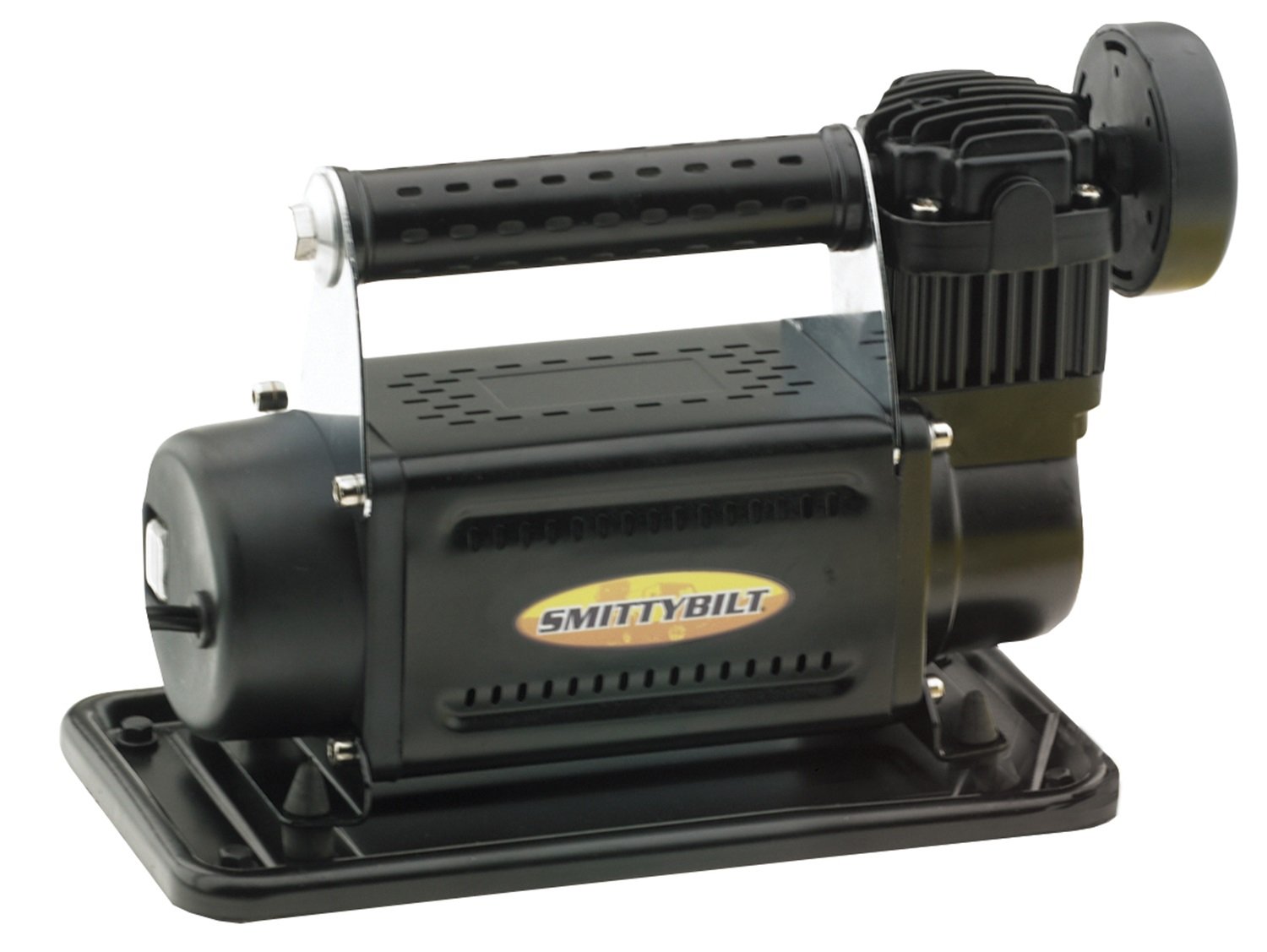

    This is the SmittyBuilt: [​IMG]
    This is the MV50:
    They don't look identical but the criutical parts do look similar.

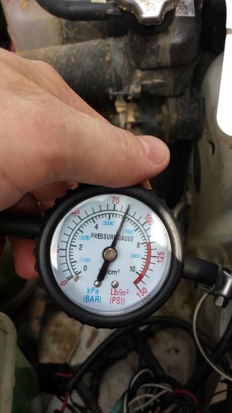

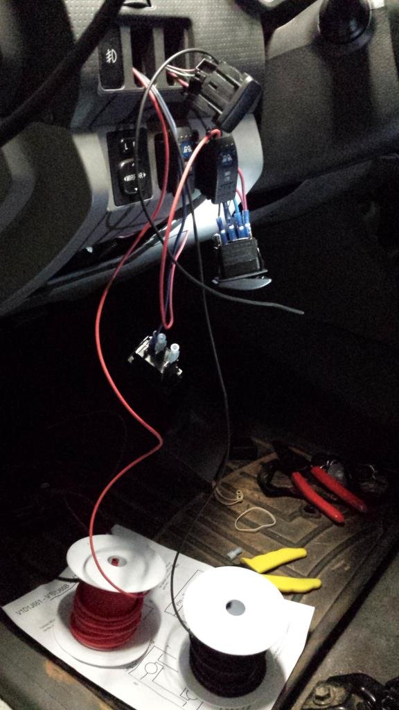

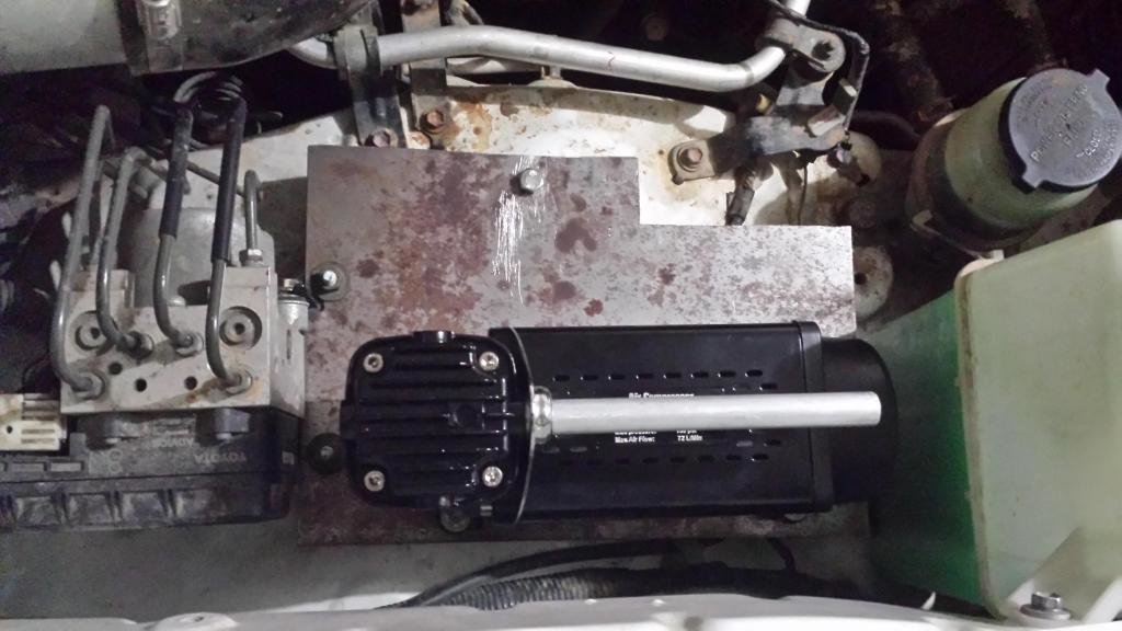

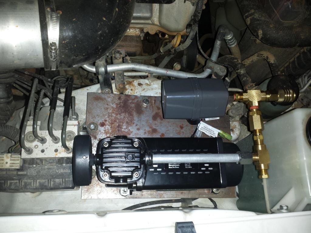

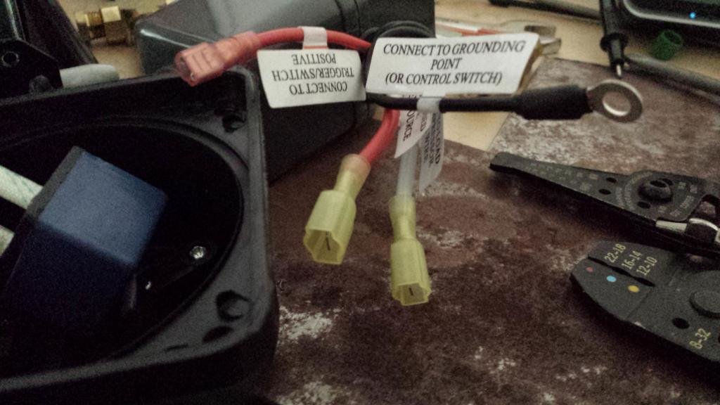

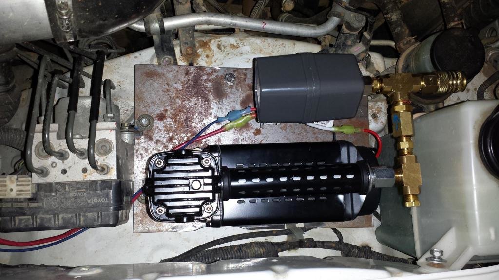

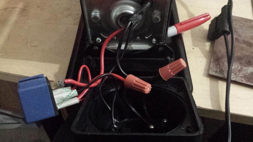

    The hose is just looped up and put behind my backseat.
    *This is only if you convert it to a closed system. As most of these compressors come they are open, air blows out the hose when the compressor pumps.
    The check valve I initially bought needed a high CFM to open and fill the line/tank. When the flow was below 1cfm it wouldn't stay open and just pissed air out of the unloader port. The new setup uses an electric unloader valve (so the piston head pressure is 0 on start/restart), and a regular one way valve without an unloader built in.

    Ok got it. Has it all been reliable? On of my concern is exposing a light-duty compressor 24/7 to dust/heat of the engine bay.
