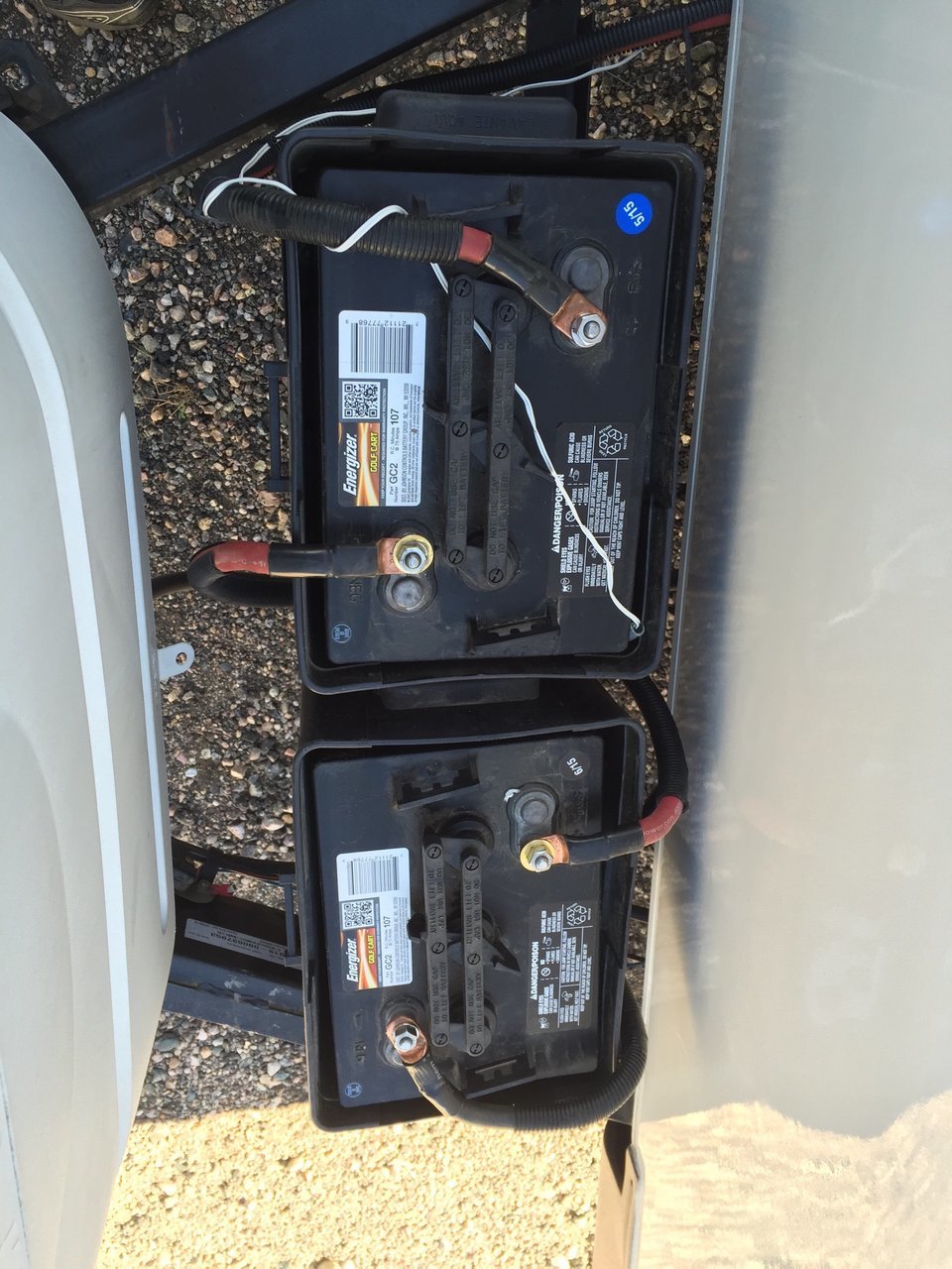

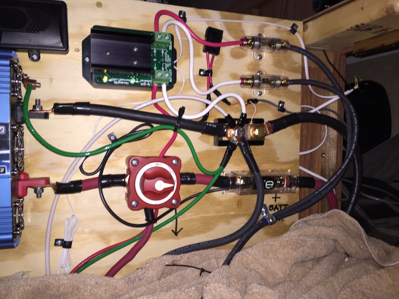

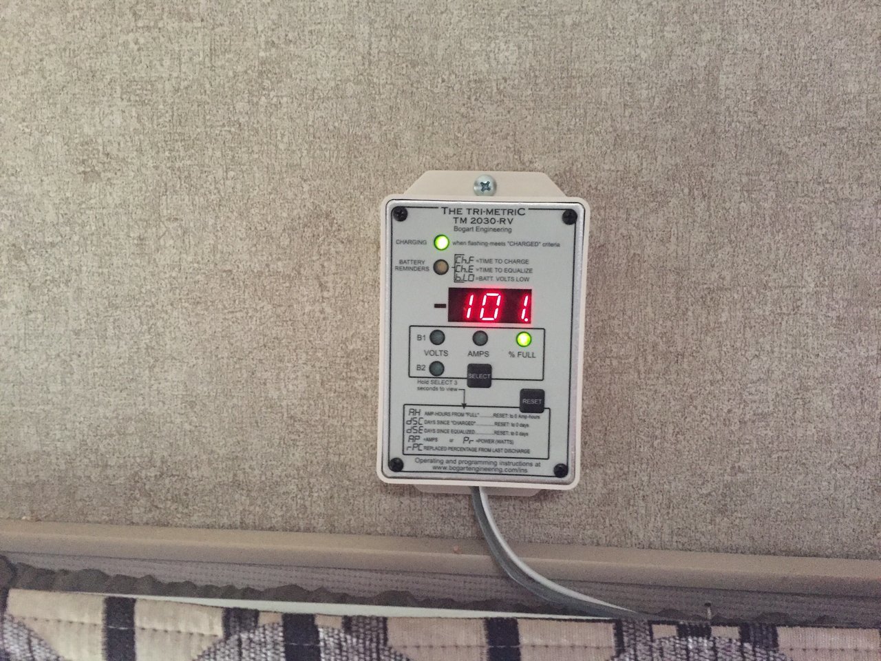

    Here’s my setup. I’m looking forward to the next build for a mini system that would go in the back of a truck bed. This one is for offgrid camping with my family:
    *Custom controller wiring board. Bogart Engineering amp meter trimetric (this is the key brain of the device). A very smart brain.
    *Wiring board includes a shunt. All negs flow through the shunt. This measures amps instead of typical controllers that measure volts. Brain knows everything about my batteries, tells them what to do and how to ram them back full of energy. Overcharges as needed, fills back to 110% or more, plus many other features due to shunt setup. Adjusts and increases voltage to ram batteries full when at 90%. I know exactly how full my batteries are to the percent. Very helpful in managing consumption. I know exactly how much power each added device is drawing. Also helpful.
    *Two 100 watt panels. One fixed on roof. Charges all the time while moving.
    *second panel is mobile to move around and position to catch the sun. Especially good for shady campsites. Rigged to mobile 25’ custom extension cord, made from two welding wires zip tied together, 6 gauge to avoid voltage drop. Soldered quick connects using winch style disconnects. Second panel can be employed at sunrise with good efficiency.
    *more big ass welding wire, again to avoid voltage drop. Some 6 gauge and some triple zero.
    *a 600 watt pure sine inverter,second portable 2000 watt inverter mounted to a board with a rope handle, and custom welding wire connectors.
    *automatic shore power transfer switch
    * two 6 volt golf cart batteries wired as 12 volt. 220 amp hours. May upgrade to better batteries some day. Probably 6volt Crowns.
    *temperature sensor (essential in cold weather)
    *fuses, fuses, and big ass fuses.
    91838772-EEA8-4914-AC69-65B36DD56C8E.jpg 5E9BCD7A-E3FF-4103-B80E-AC7B3F492A81.jpg
