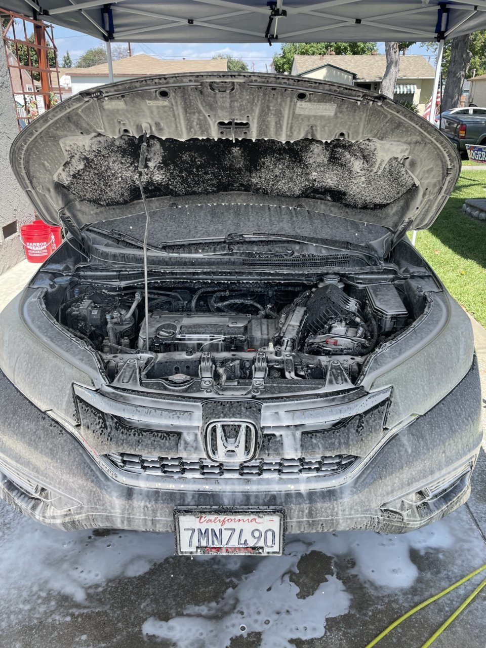

    It's definitely case by case but that is primarily correlated with age. A brand new, off the lot, 2023 Tacoma I would treat differently than a car from the 1960's, or even the 80's. Modern cars are extremely resistant to any issues from water and, in general, old cars aren't that bad either. We've all see those videos of old Toyota's crossing rivers. And we see people still doing that today. Do we not think plenty of water gets up in the engine bay when you do that? My family has washed our engine bays for decades and never had a single issue. I do a DEEP engine bay cleaning on all our cars at least once a year and then quick washes a couple other times a year.
    In general, electrical connectors are pretty well sealed so not usually a problem. Alternators aren't scared of water, the failure you experienced is coincidental. Ignition components (distributor, plug wires, points...) and air intake systems are generally where you could run into problems. But, that is more of an issue on old cars, especially carbureted ones. Modern cars feature more fully sealed and weatherized systems and aren't really a concern. Same with fuse boxes, they could be a concern but generally aren't unless there's damage to the lid/seal.
    For a modern car (probably anything newer than say 2000) you can pretty much just do as you want. I don't cover anything for any of our cars. I liberally spray with soap and water directly from the hose or even my pressure washer - but note that I use a lower pressure unit for washing cars and I use it from a distance, not close up. I do not recommend you actually "pressure wash" your engine bay as that could definitely have the pressure needed to subvert various seals and components designed to keep water out.
    For older cars, just be careful. Use less water pressure. You may want to cover your air cleaner, cover your distributor, or cover your fuse box. Depends on the car and it's condition. But, in general, you're not going to do any real damage and typically if you run into an issue it'll just need to sit and dry out and then everything will be fine again.
    My dad always used to spray the engine down with WD40 after he washed it and it would give a nice shine to all the parts. I stopped doing that at some point as it seemed "old school" and a bit odd. But, since then I've realized this probably came from the fact that WD40 was designed to displace water. So, this practice is actually, probably a good one to help get water out of nooks and crannies. I also recently found out that WD40 can work WONDERS for the light, baked on crud that forms on painted surfaces in an engine bay over time (not talking about thick grease or dirt).
    Pic from the last deep cleaning of my wife’s CRV. I used the foam cannon on my pressure washer to liberally apply soap. Nothing covered up at all.
