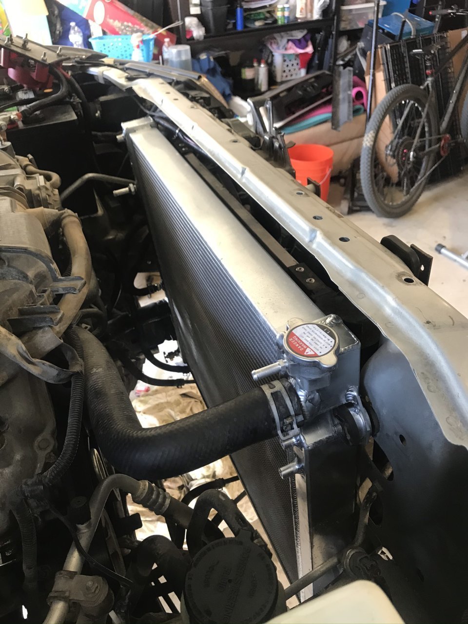

  14. Aug 23, 2022 at 7:03 PM
    #34
    anthony250f
    anthony250f Well-Known Member
    Feb 18, 2012
    #73066
    16,774
    Anthony
    San Diego, CA
    2008 dcsb trd offroad 4wd
    Here’s the one I got. Very nice quality and big improvement
    2E1CBEBE-775A-4023-B6D6-894C3F30054F.jpg D3702B46-B61D-48D6-B28D-90984912D0AA.jpg
    Pacificclam and Pearson[OP] like this.

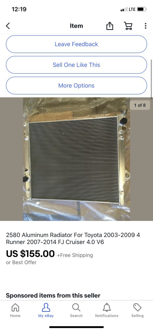

  15. Aug 24, 2022 at 7:31 PM
    #35
    Pearson
    Pearson [OP] Well-Known Member
    Aug 21, 2021
    #374865
    736
    Elliott
    Lexington Texas
    Black 2012 2.7L Prerunner
    Can't beat the price if the QC is there. Thanks, is this ebay, Sorry just saw it, thanks

  16. Aug 24, 2022 at 7:43 PM
    #36
    Waasheem
    Waasheem The catholic radio bear
    Jun 26, 2019
    #297494
    2,820
    Waasheem
    2007 xrunner
    If it’s champion radiator, it isn’t. I learned that lesson.
