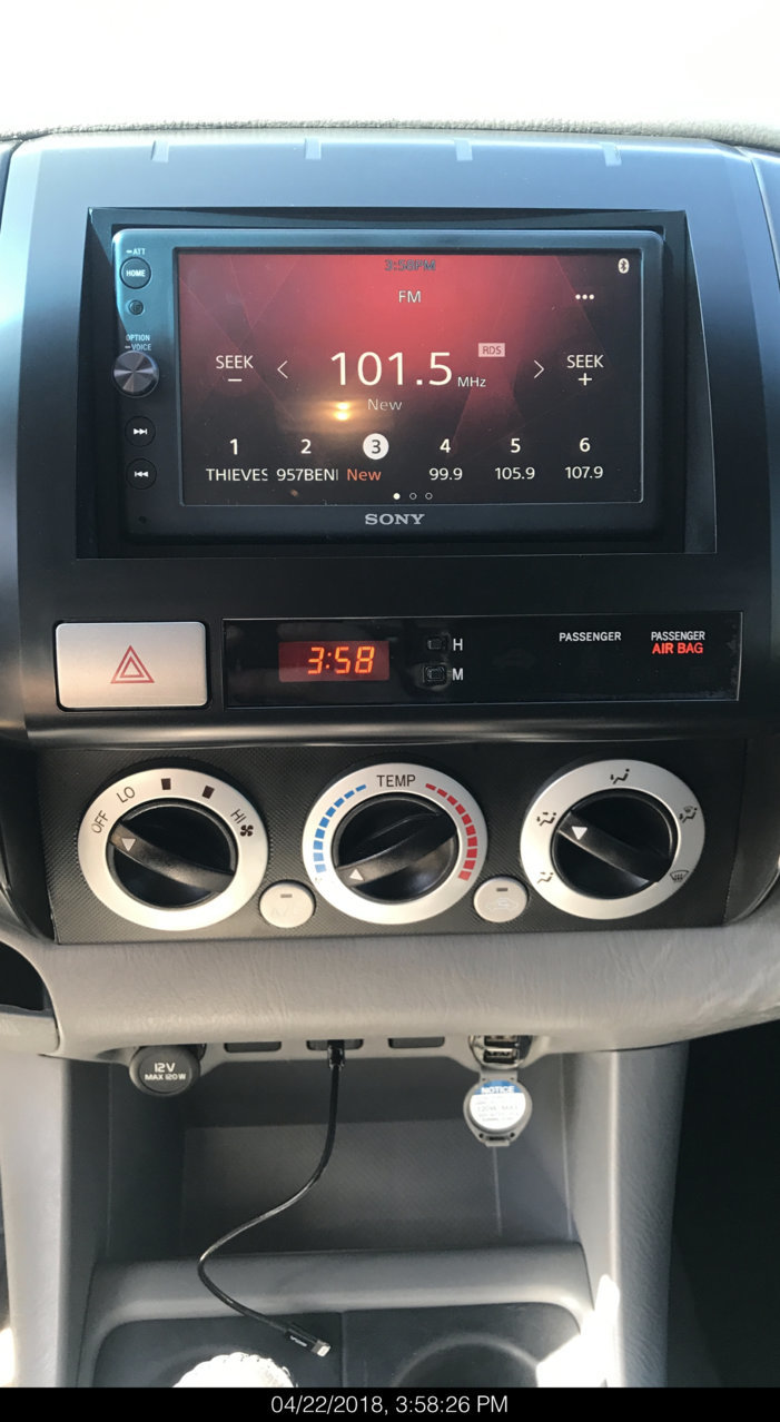

    Pioneer makes great radios I use to use them back in the day. But i was on a budget for my truck and went with the sony also mainly because it has a actual volume knob. Back up camera is great Bluetooth works fine apple CarPlay works great to. I also recommend the schose kit and the axcess or something steering wheel controls 95A33240-4873-4A35-B8CF-7C029AD4BD02.jpg

    Looks good.

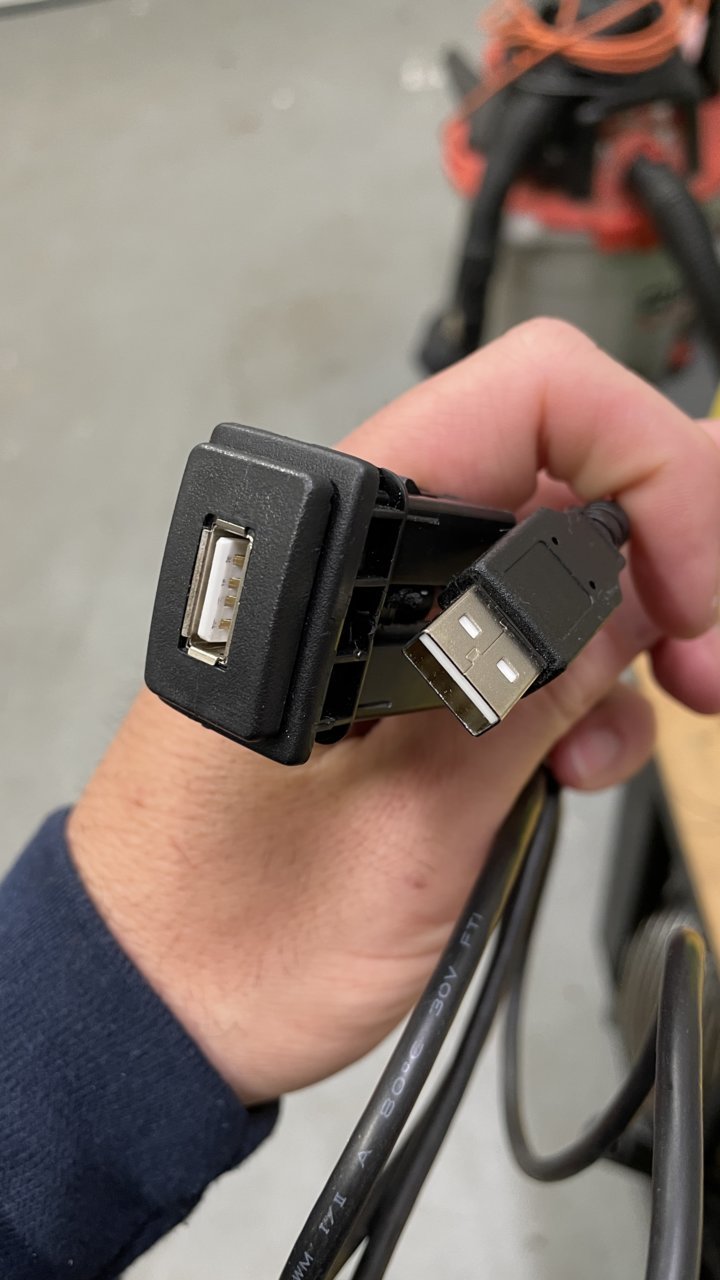

    I actually just re ran my cable from the back of radio to the arm rest trying. Im trying to not see any wires. Plus I needed the cubby for my Switch-Pro . That being said i have a usb to usb connection into a factory blank if you need one ECE04B66-3E20-4427-97F2-BF2E78A2C7C9.jpg

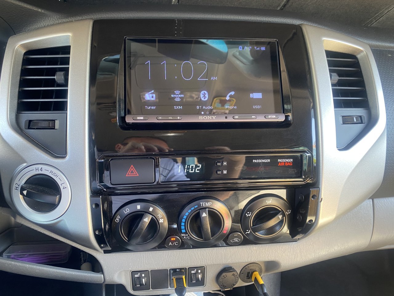

    Here is a picture of the Sony XAV-AX5000 installed with the Scosche kit I linked above.

    Any details on that blue sea USB charger replacement on the bottom/right of your pic?

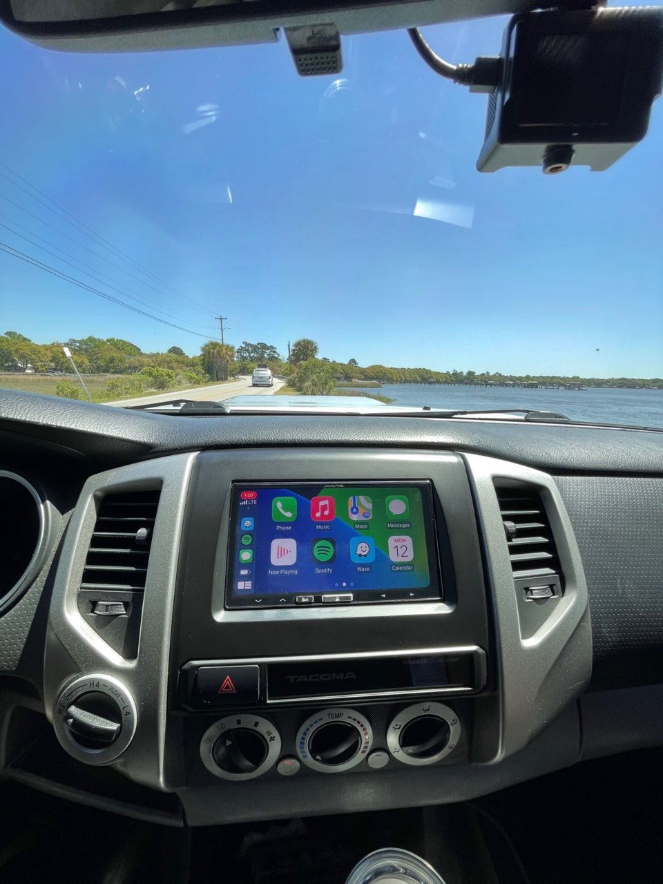

    I've been happy with my ILX-107, it has wireless apple carplay. Also I second the Scosche dash kit, the metra isn't great.

    How did you wire your backup camera to the new radio? I have a 2010 also and my cam is in my mirror. i will be installing a Kenwood this weekend. Also is that USB adaptor a direct fit the blanks under the dash. Id be interested but doubt it makes it to NC before the install.

    I love it! Capable of charging my iPad and iPhone. There is a write up on here about how to do it. It’s the Blue Sea 1045. Basically once you get the dash apart, you can de-pin the factory connector for the cigarette lighter and the spade connectors will fit directly onto the Blue Sea USB. Very easy to do if you know how the dash comes apart.
