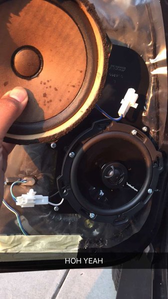

    Installing Rockford-Fosgate Speakers:

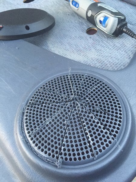

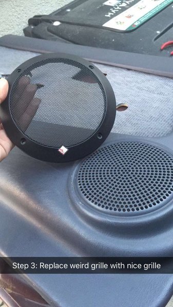

    I didn't like the factory speaker grille, so I dremel'd it and added the aftermarket Rockford-Fosgate one

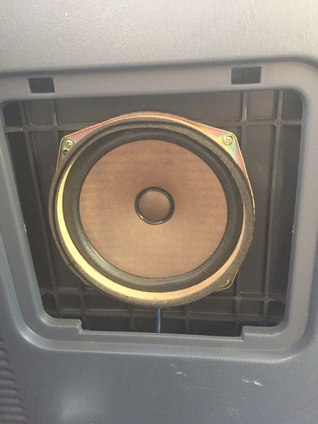

    The rear speakers in my Xtracab were a PITA to install since no mounting bracket exists and the holes didn't line up, I was halfway butchering the old existing front speaker brackets to fit the rear when I just gave up and used self tapping screws and washers to drill directly into the plastic backing. It worked out fine.

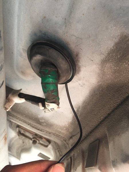

    Running Back-Up camera RCA/Video in through brake light harness under door plate & carpet:

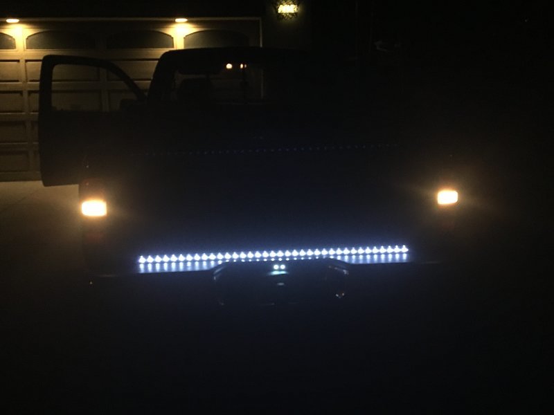

    Splice other taillight for LED taillight +5v power (for reverse lights, as it is powered separately from trailer wiring harness)
    Testing Camera & Taillight
