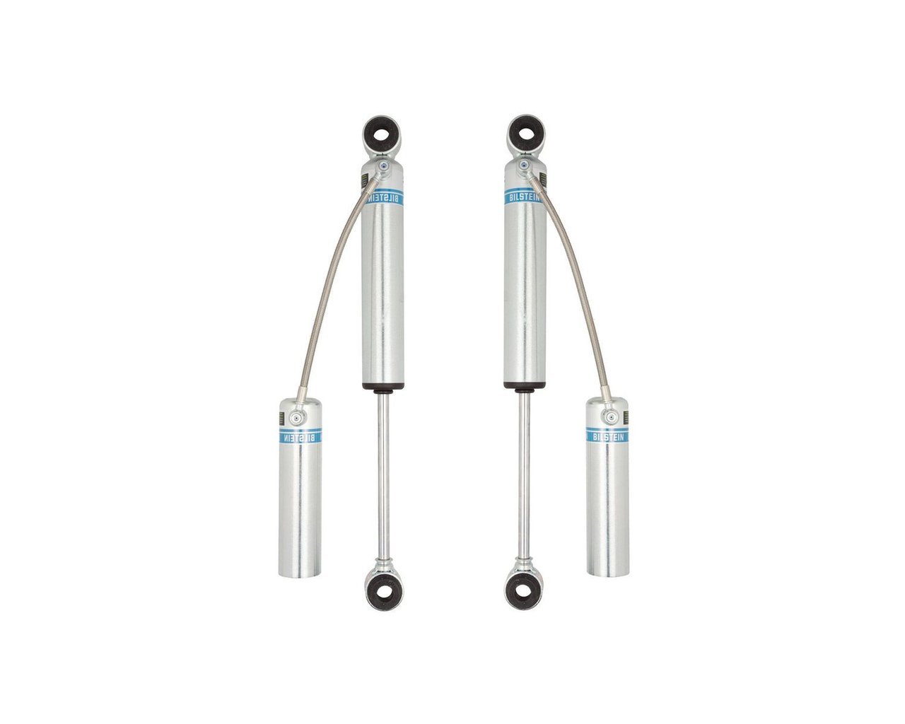

  10. Jul 13, 2017 at 10:10 PM
    Cristiang19
    Cristiang19 NOT STUCK
    Aug 9, 2016
    #194214
    91
    Cristian
    Bay Area
    '97 3.4L, 4x4 5spd "sloppy taco"
    3inch mid travel, All pro Bumper, skid plates and Relentless Sliders
    These are 0-1.5, would these work?
    Bilstein-5160-0-1.5-inch-Rear-Lift-Remote-Reservoir-Shocks-for-1995-2004-Toyota-Tacoma-4WD.jpg
  11. Jul 13, 2017 at 10:25 PM
    Tatts521
    Tatts521 Well-Known Member
    Nov 13, 2015
    #169529
    11,551
    New Jersey, Jersey Shore
    2012 tacoma-04cbr1000rr-22ktm890duke R-19 wr450f-98rm250
    I have 5160 haven't put them on yet. I also have 14" billies. As right now I'm running some cheap pro comps. Believe it or not the pro comps aren't a bad ride.
