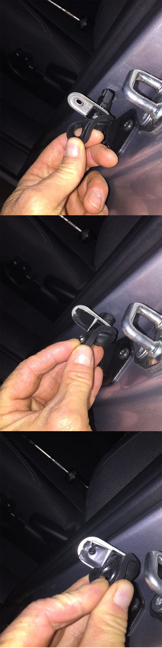

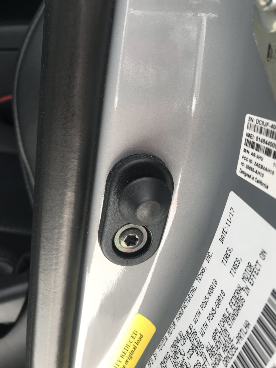

    Option #1:
    If THAT's the reason, force these suckers down on the door jambs...problem solved. Or if technically inclined, use the signal off the remote start harness (I can guide you on my hardware which wire that is) to set a relay that runs only when the remote start runs in tandem, and use that relay to trick these limit switches into thinking the door is closed the whole time. When remote start time is up, or not using the remote start, your vehicle and lights and annoying chime all work the same natural way.
    Option#2:
    1. Remove screw
    2. Remove rubber cover off of switch
    3. Place a small square of electric tape on switch plate
    4. put tiny hole directly in center of tape for screw to go back through, hole should be smaller than screw so that when the screw goes through, it stretches the tape and doesn't allow the plate to make contact with the screw.
    5. Reassemble
    Option #3:
    You're already at the vehicle, so start it manually with one hand on the brake and the other on the ignition, then take your fob with you.

    Jimmy, using option #2 does this allow the lights to come on when you open the door? I might try this. Please explain a little more about taping over the contact method. What features do you loose by doing this?

    Whatever depends on knowing your vehicle is closed, I.e. interior lights, headlights, locking your door while it’s open (when it screams at you saying it can’t, meaning now you can potentially lock your keys in), radio when exiting, automatic locking/unlocking when driving off, parking, and whatever else I’m not thinking of...that’s why I DONT promote this. You’re on your own if you do this hack. That’s why I say use a relay so this is only faked during remote start and not any other time, not even regular start.
