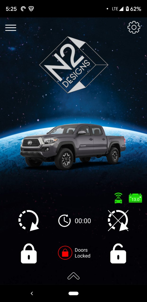

    Venders on here are great. Prettty affordable and they offer the phone start as well. It's all plug and play and takes 20-30minutes to install.
    I just put one in my truck, with the cell start module for $390. Works great! You can start your truck from anywhere with service, lock and unlock the doors and see battery voltage.
