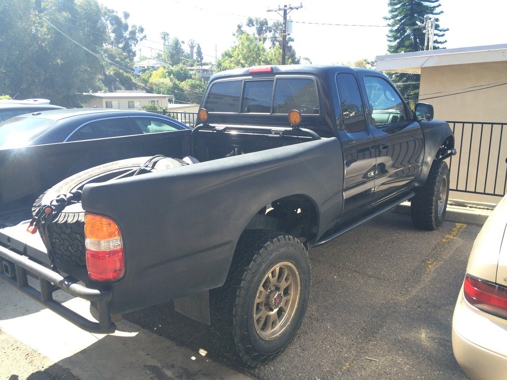

    265/70/17 BFG AT KO2
    17x8.5 -6 offset 4.5 inch back space Level 8 Guardian wheels
    Will fit with no lift

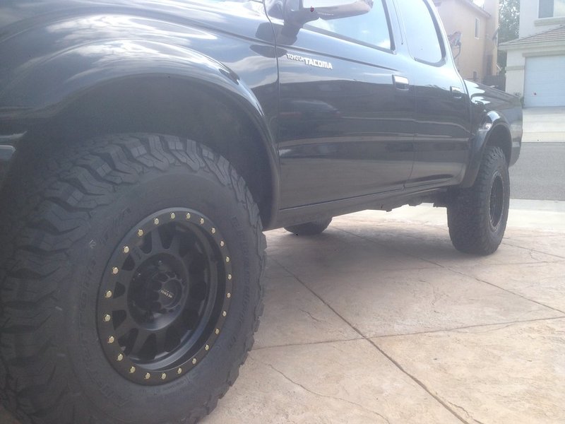

    bfg at ko2, method double standard
    if you drop to a 16x8 4.5 backspacing you will have a lot of options for tires. I was looking at the bfg at ko2, toyo at2, and gy wrangler duratrac. ended up going with the ko2s because they were the cheapest. 265/75/16 is an easy to find tire size and that is about as big as you can go stock. I have some slight rubbing in front when loaded down with passengers but my suspension is stock and has 160k miles. I got method wheels but there really isn't a best wheel or tire imo. just depends on what you're looking for. there's steel wheels (heavy/strong) alloys (lighter but not as strong) ... all terrain, mud terrain, tires designed for the highway. you just have to decide how much you want to spend and what looks good to you[​IMG]

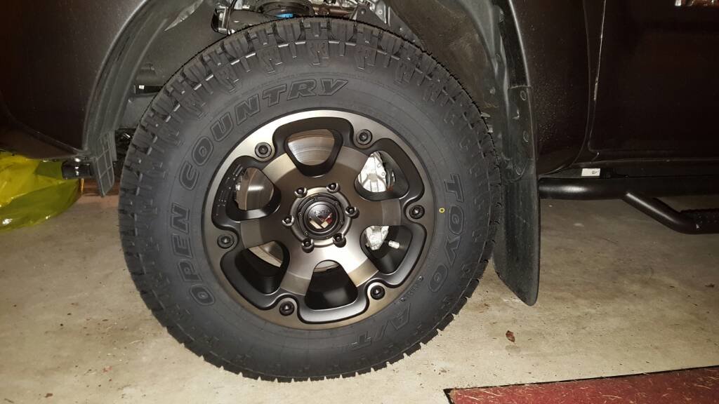

    265 70 17 with 17x9 fuel beast wheels f564792bdc8d1d25c26d824f7d5201be_716334fcd2f9dd58c332c9255137ce6815cde89f.jpg759c320d2d6feda0d41149109fae727e_f775c0aae247e557a29712da1aeefda93d199cb3.jpg
    Toyo AT2 best of both worlds IMO

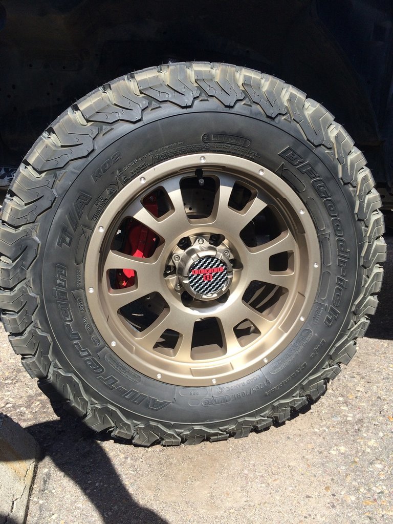

    1609.jpg 265/70/17 ko2

    Very Nice!!! Did you get the 20mm offset? I've been looking at these wheel but didn't know which one to take as 01mm might stick out too much.
    Thx in advance!
  12. Aug 7, 2015 at 7:59 AM
    D3V8
    D3V8 Active Member
    May 19, 2015
    #155628
    26
    2015 Double Cab Tacoma
    Thanks, I really like them. I know it's a "medium" offset from what they told me. I didn’t see the back of the wheel before they installed them. I'll see if I can look for you after work.

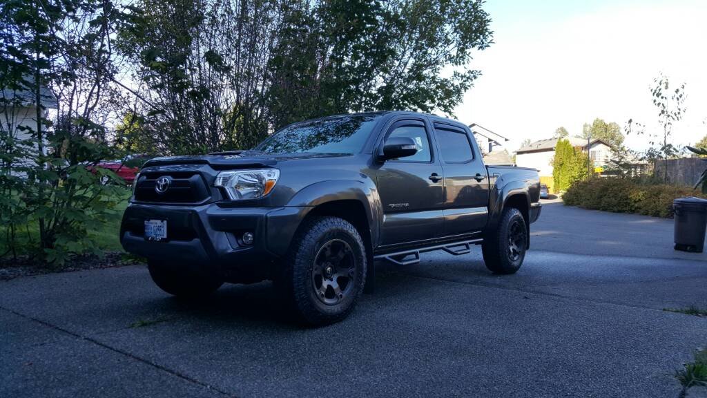

    If you have the non-sport model, I like 265/75/16. A bit more tire, than rim. Works on a non-lifted truck too.
    265/75 without lift or armor (or my fat ass :anonymous:)
    265/75 after 2.5" lift and armor
