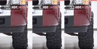

    So if I want to move the tire about 1/2" out away from the hub (moving out of the wheel well some) I would need negative offset? Do I understand that right?

    Your stock wheels are not -17 offset......
    To answer your question though, more negative offset means the wheel will stick out further

    Yea its likely +17 mm. Almost ALL toyota rims are + offset..its likely a type-o, like when he got the 7.5" wrong too...
    These are -19 MM offset and I know they are WAYYY deeper than stockers lol

    Positive 1 from centerline of the rim. Going to sit a hair in under the well from dead center. In your case If you go from +17 to +1, you are pushing OUT the rim, FROM being super tucked under the well, TO being almost dead center, essentially moving the protrusion of your wheel out 16mm from where you are now. That help?
    IE + offset look FLATTER and more tucked under the well. - offset look more like "deep Dish" and stick out more..Kosher?

    YOU got this right on now! Considering you have +17 offset on a 3 inch lift, I have no doubt you rub, ESPECIALLY close to rub the UCAs. Thats why most people will use a wheel spacer in your case. If you dont want to wheel space (if you want to keep your current rims) or you want to trash your rims and get nice new ones, then you need to move from +17 DOWN to 0, or passed it into negative offset.
    SO if you wanted to push the wheel out 1 full inch, you need a rim with -8.4 offset in your case-ish. That might be a little much IMO, I think you could do it. Mine are -6mm offset in my pictures I linked before in the thread.
    The CONFUSING part is when they start talking back spacing vs offset. Be aware of this. Back spacing is the distance measured from the back (caliper/car side) of the rim to the center line. Offset is the measurement from the CENTERLINE to the direction of mounting point.
    I recommend you going with a more neutral 0 offset to a slight negative. REMEMBER too, if you go TOO negative, you cant wheel spacer it to fix anything. If you go too light, say +0 to+10, you could always add a wheel spacer to push it out...

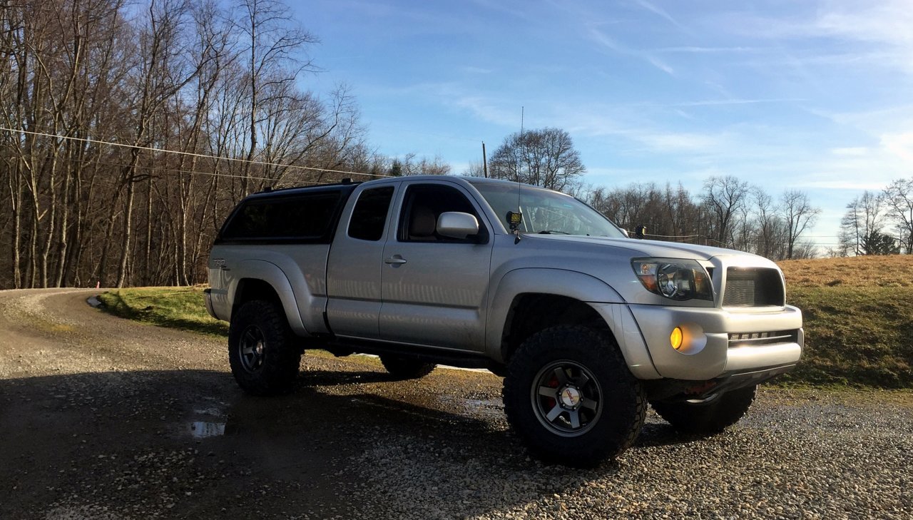

    - 4.5 8- 16 Dick Cepek wheels side byter II just like the TRD Wheels ))

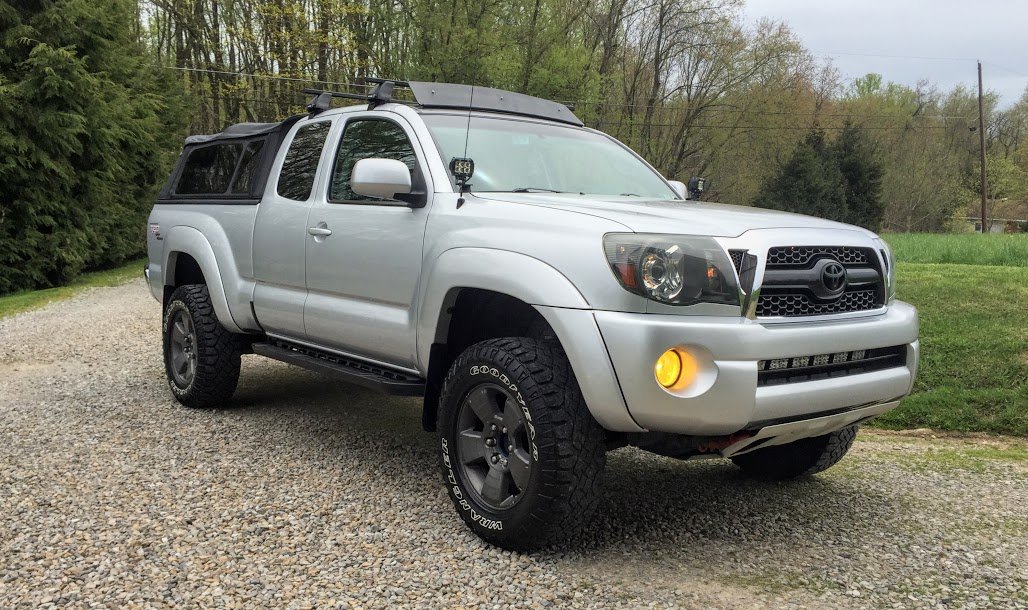

    What wheels are those?
