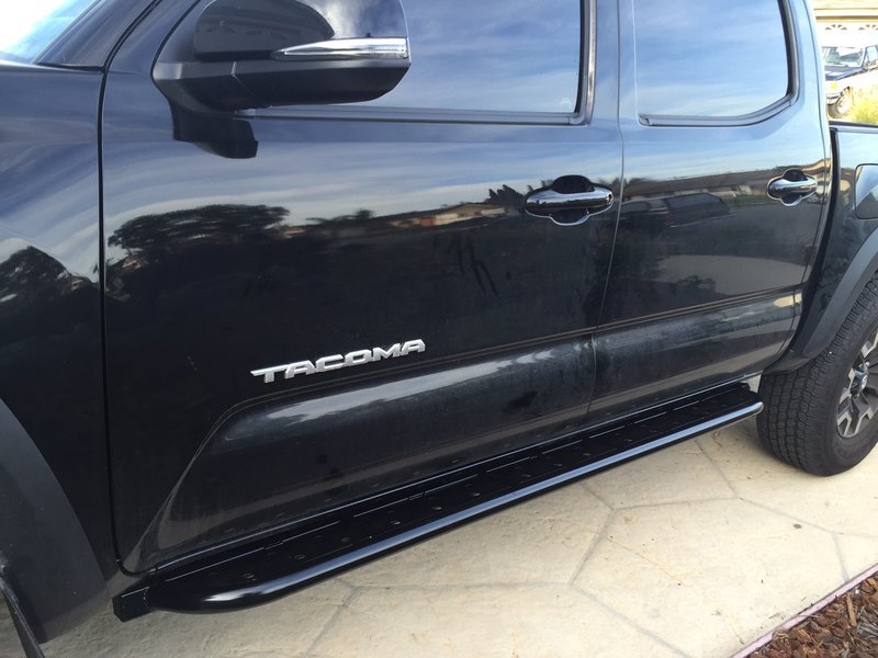

    Very nice. Did you paint them yourself? Trying to decide on powder coat or no.

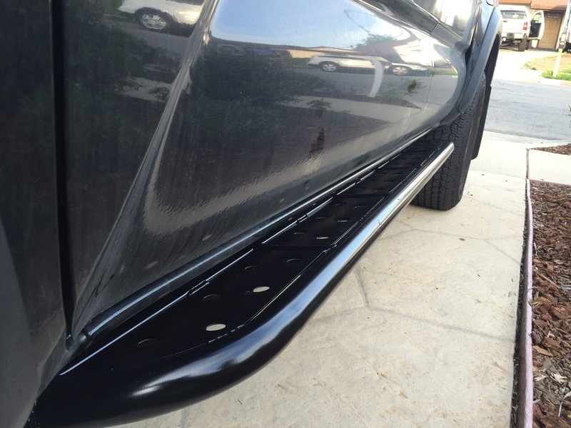

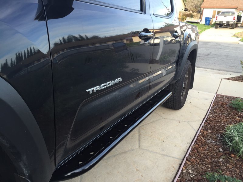

    Painted myself. used 2 coats rustoleum self etching primer and 3 coats rustoleum satin black

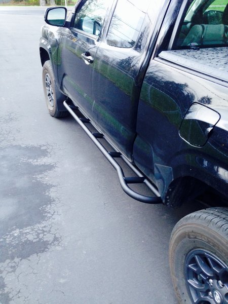

    Are these at the 15 degree angle?

    Yes they are
