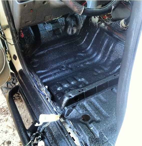

    If you go raptor liner, out of the whole kit you will probably only use 1 out of the 4 bottles but get the tintable kind cause I've heard the already pre made black one will fade. I mixed automotive flat black paint in my bottle accordning to instructions on the box and it came out fantastic and haven't had a single issue so far inside the cab!
    I just did a light sanding and scuffed up the paint almost to where I could see bare metal inside the cab. As for the whole kit it costs me $116 shipped to the house and a quart of the black paint was $25 thru oreileys. When I do the body it should only take a quart or so of paint to mix in but abt 7 kits I believe for 2-3 coats. I also did 3-4 coats in the floor pan all with one kit and went up the back wall as well.
    Here's a pic of the raptor liner. Sprayed in with a small 8gal compressor at 35 psi
