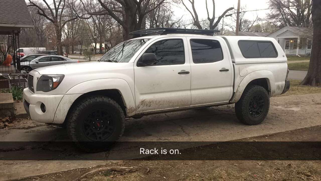

    I was lucky and came across a "dent and ding" Warrior Products rack on Craigslist for $100 with all the mounting hardware. They rate it for 450/500lbs static load, or 250lbs if you're going to be doing trail riding with the weight going up and down.
    So far it has been pretty beastly, we had it completely loaded for a float trip (probably close to 350-400lbs) and it didn't show any signs of use. I will say it's a bit noisy without a fairing, but the radio drowns it out pretty easy.
    Only thing I wasn't super thrilled about was the drip rail moldings. I'm not sure if there is a better way, but I basically had to cut out the section for the roof rack with a razor blade and dykes and double side tape most of it back down.

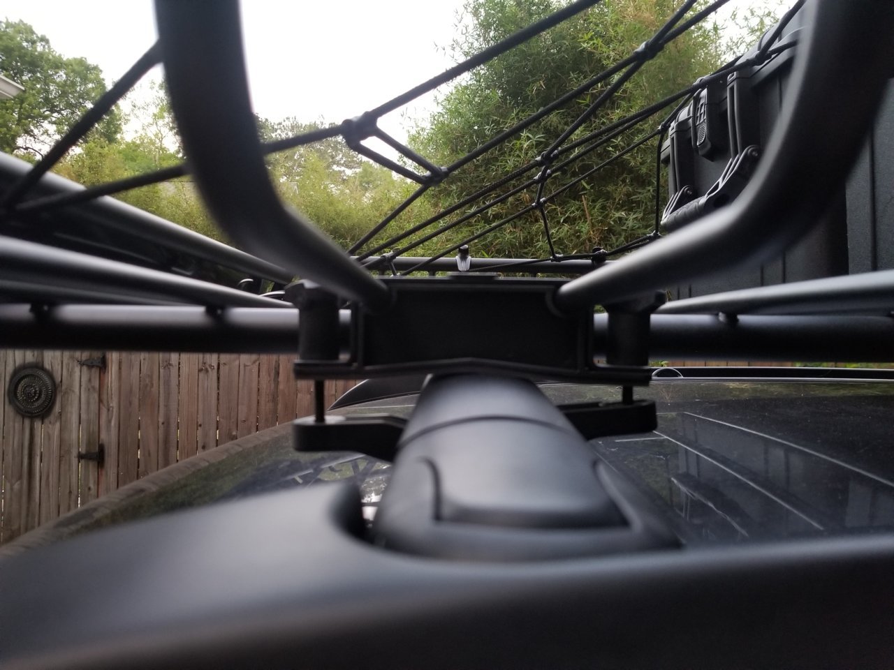

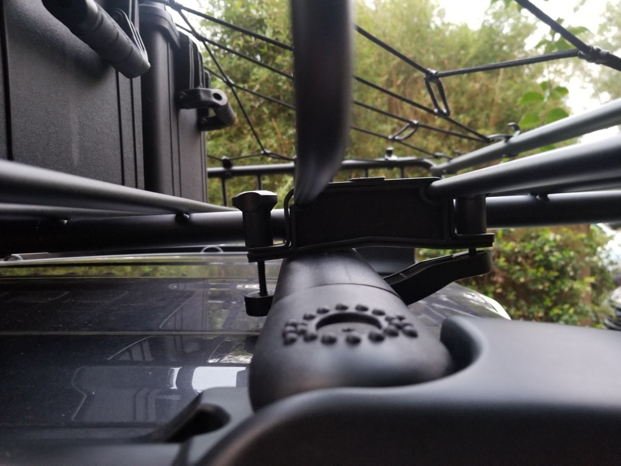

    I finally made a decision and bought the OEM crossbars and a Yakima MegaWarrior basket. Found out quickly that I also needed the MegaWarrior extension to cover the OEM crossbars! For storage I got a couple of Condition 1 XL waterproof boxes. While in a spending frenzy, I also got the yakima heavy duty straps and the Yakima stretch net.
    Being a newbie to the forum, I'm not sure if I should post my basket installation question here or start a new thread? But here goes:
    The Yakima basket support brackets fit perfectly under the front cross bars, but they are about an inch off on the back. It's cranked down and feels secure, but it's definitely not perfect. Is there a step I missed or custom bracket I can get that fits better? Or should I roll with it and relax?
