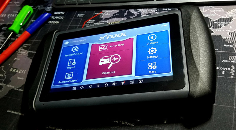

    Went ahead and bit on the IP819.
    Finish and feel is...quite nice. Once you get past the first round of updates, it's pretty fast. Usability is ongoing, some things weren't as intuitive as they maybe could be, but some of it is I've just never had a tablet style scanner, so maybe it's me. Once I figured out how to get to what I wanted - ezpz. Right now I'm just chasing misfire ghosts on the Honda since this thing catches more in real time than my pos reader, but I'll poke at the Taco this weekend.
