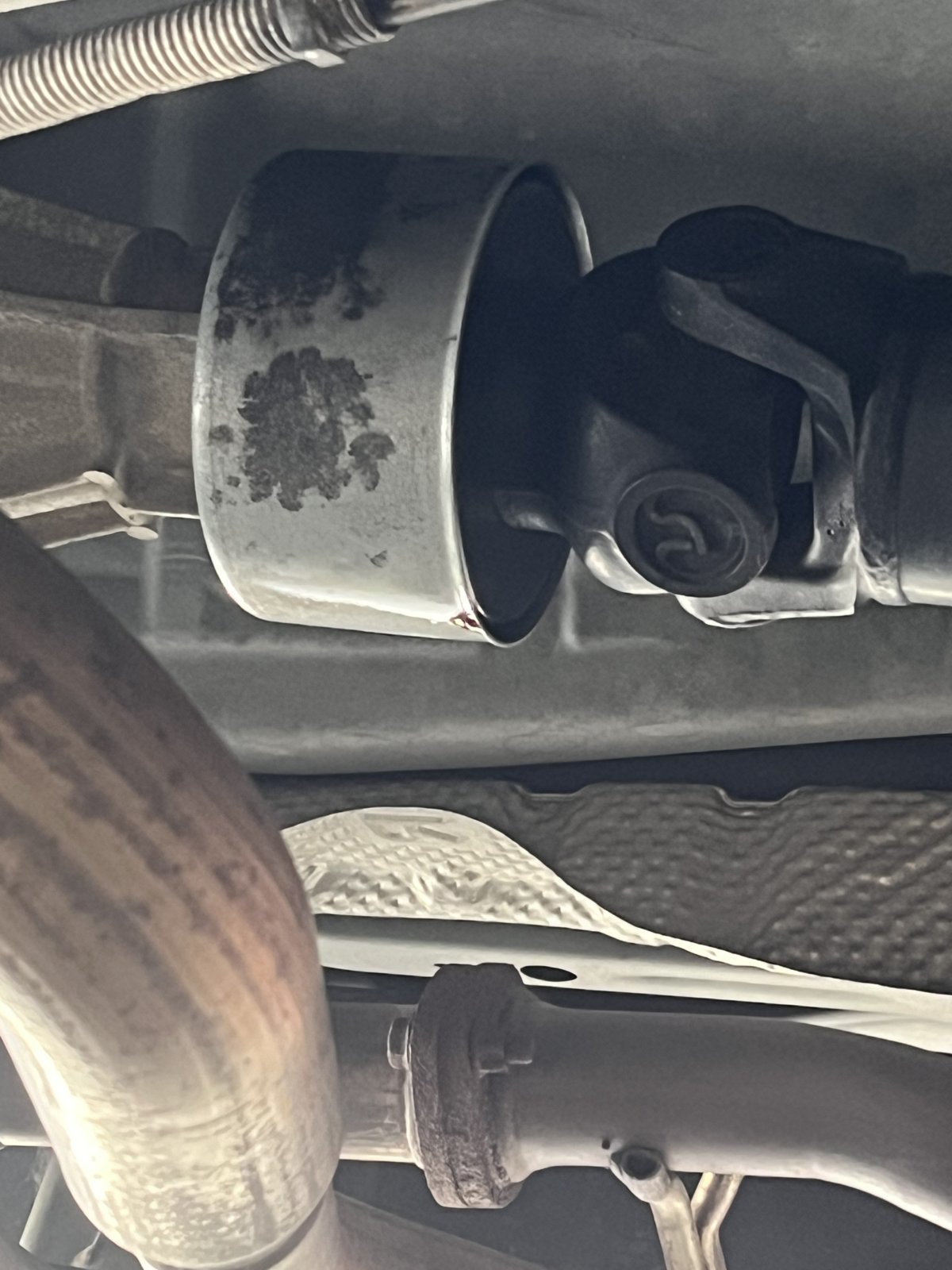

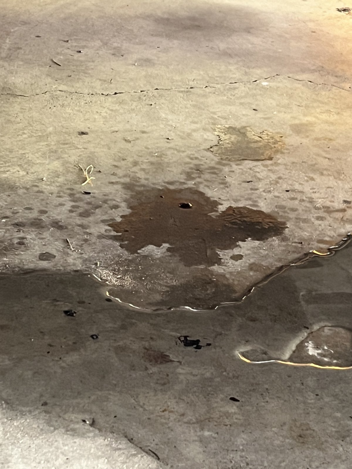

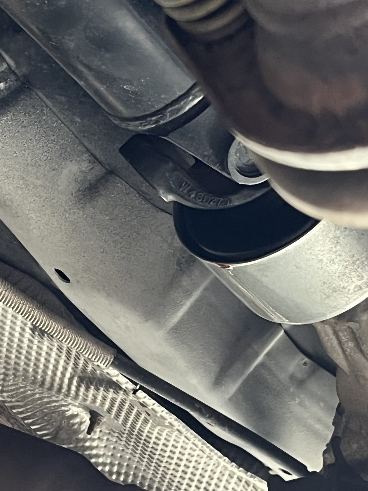

  10. Aug 1, 2024 at 1:30 PM
    kevin3654
    kevin3654 [OP] Member
    Aug 30, 2018
    #264632
    9
    2008 tacoma double cab shortbed v6
    Dang thing is leaking again already.
    I will have to get a picture of how deep the seal is seated.
    Pretty sure its hardly past flush..
    Used a pvc coupler and did the trans oil check procedure after.
